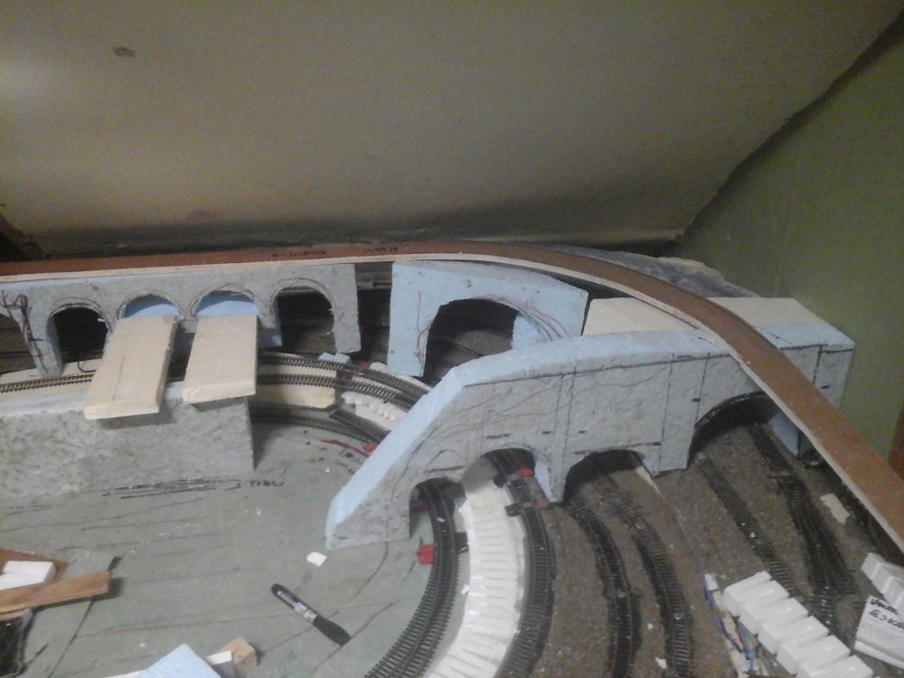

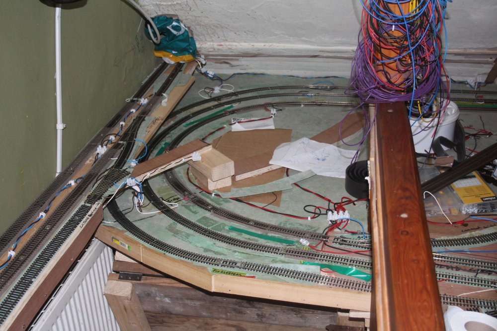

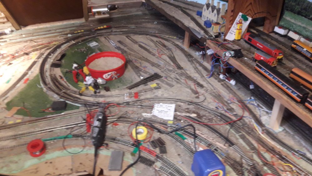

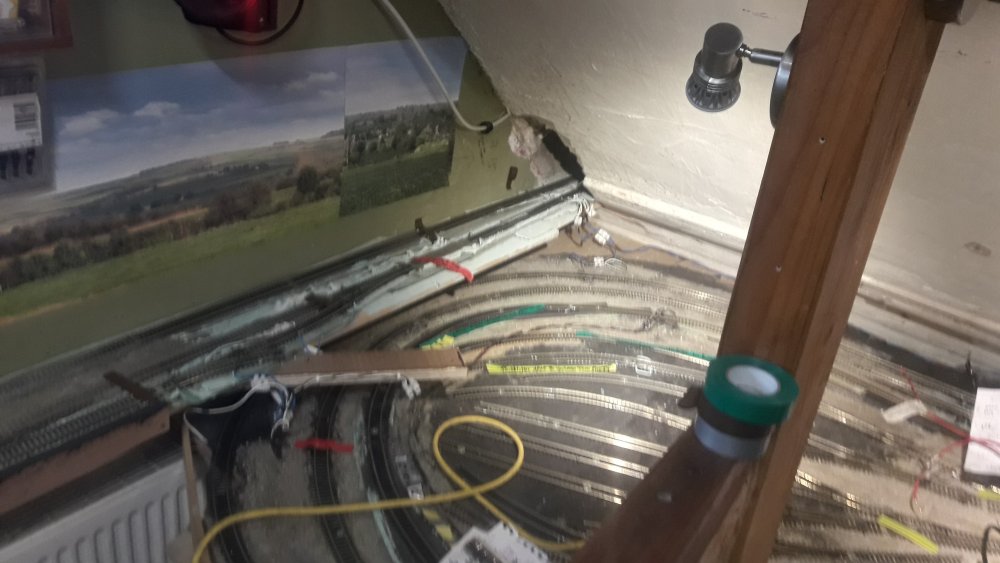

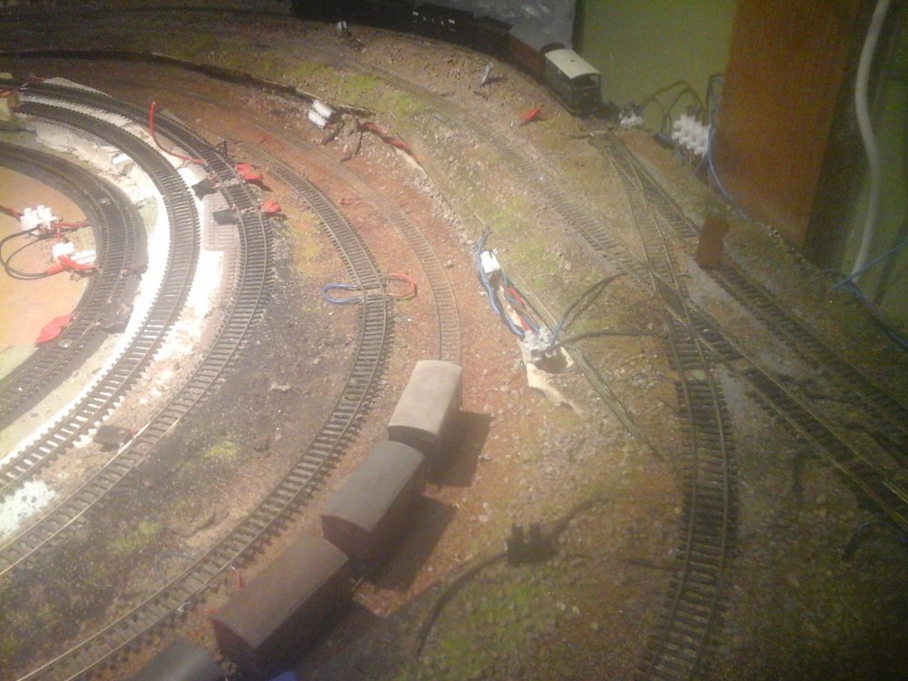

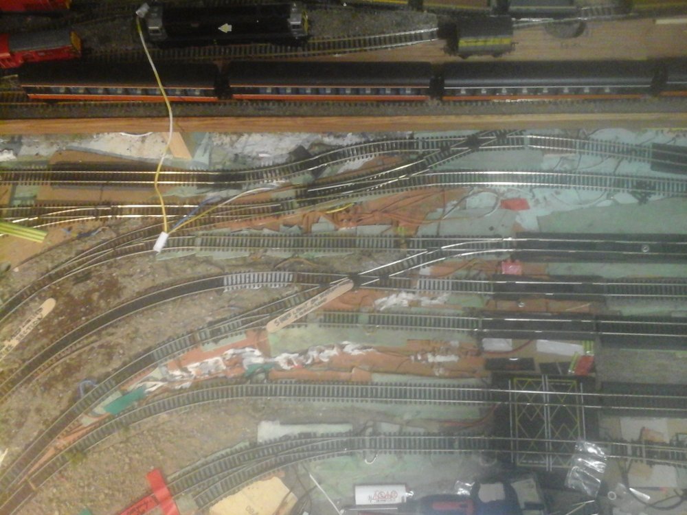

WaYSidE Posted February 8, 2019 Author Posted February 8, 2019 Two more pic, after first attempt at ballast in with washed sand, fire ash, a scatter of ballast n tiny weed seeds from dust in the combine harvester. It's my first attempts,, never done any of this before. Southwest corner. In such confined space, I have to work from outside walls back into middle . My plan is to rough ballast everything on outside mainlines, as it's hard to get back into those spaces....... 1 Quote

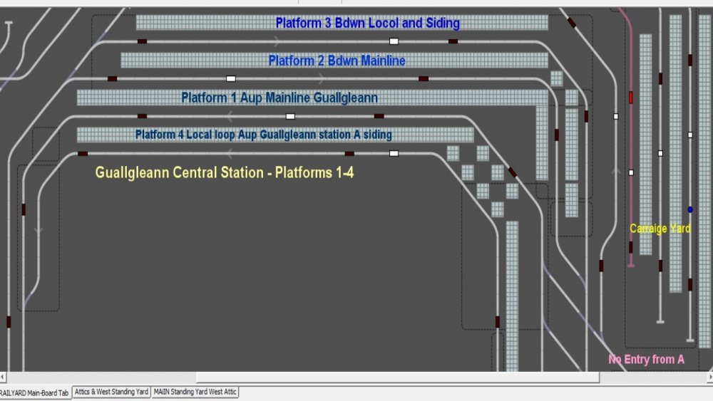

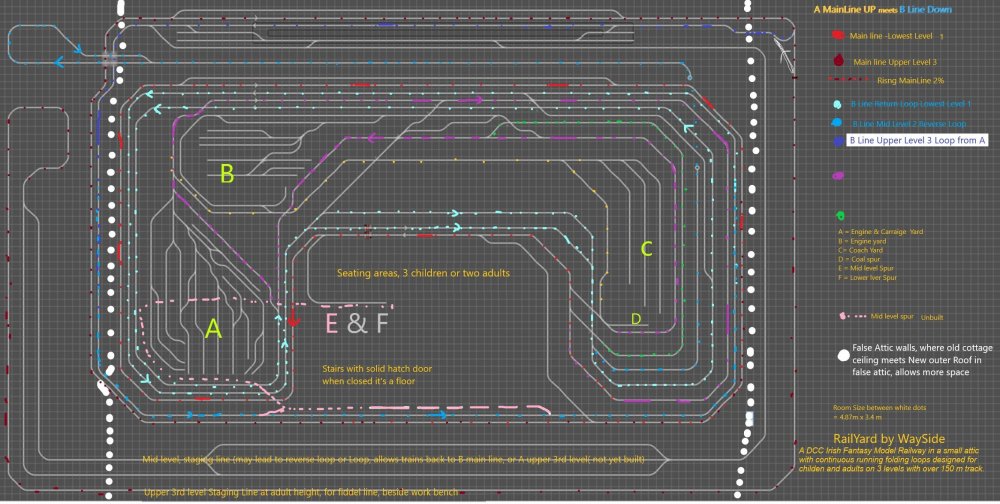

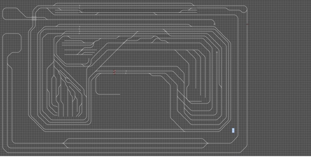

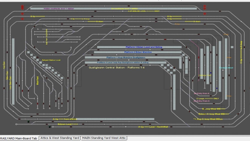

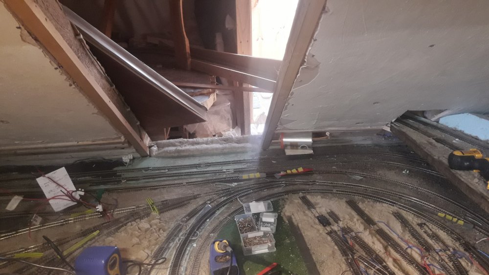

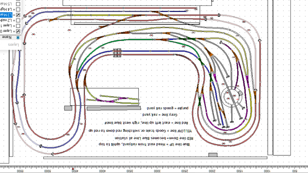

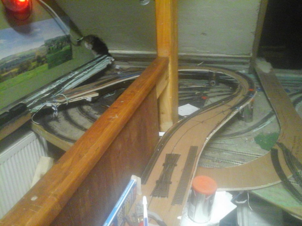

WaYSidE Posted March 25, 2019 Author Posted March 25, 2019 (edited) Track plan march 2019 After months of research, design, planning, testing, and Scarm track planner, I decided to ignore certain 'must dos' recommended in the model rail world as the attic space i have has a low apex ceiling and required an alternative to the standard height for base boards and dropper wiring. If my layout was to fit, my lowest level baseboard would have to be 50cm off the floor. I had no intention of crawling under base boards to wire the 250 different pieces of track all of which have wires attached. And just as well, for i discovered something that newbees will be very interested to hear, above the board wiring is far more flexible and forgiving as you build, especially in difficult to reach places. For when I wired my mid and upper levels, i used tradition feeders dropping through the base board, which meant no room for mistakes, they were unforgiving and newbees make lots of mistakes. after building the track i then used Itrain for the layout below. Railyard is a twice runaround folded dogbone continuous loop on 3 levels with lapped and passing siding type features that also act as storage and branch lines. There's two main stations and one branch and a spur to a rocket launcher for the 8 years old. To-date, 70% of track is laid. I added extra crossovers to insure trains just cant be run at the same speed all the time, so the children will need to drive them to avoid crashing. I also enjoyed driving over dodgy laid tracks, such as a bord na mona bog train would, so some of the layout (5%) needs very careful driving skills, Kaydee couplers wont work well on my layout, due to the bumps, Baseboards, 9x5, 9x5.5 connected in middle with 4 x 6 = basic shape |_| ad a mainline track on the outside. Built for children and adults in a small attic space of 16'x10' (4.87m x 3.4m), excluding a few breakouts through the low ceilings into sub attic space, RailYard has well over 100 metres of code 100 track. The layout has a one continuous outer main line, that folds back on itself: out/up and down/back, mainly as as two lanes with the end a folding section creating four lanes in some parts, The upper levels when built will have the more prototypical one main line and siding. The layout has an inner goods line, a few small spurs, 2 engine yards and 1 small short yard for coach rakes and a continuous hidden long track for 'first in first out' storage, Grades include 1cm and 2cm per 1m In time I plan to build a 3 lane fiddle yard and a viaduct. The aim with designing for young children is that there is enough track that no loco or carriage needs to be lifted off the track, to reduce handling, therefore once a rake is constructed it will not be deconstructed unless its Lima models, which are more robust. Edited March 26, 2019 by WaYSidE Quote

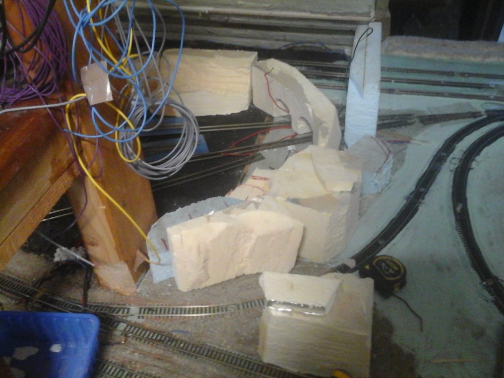

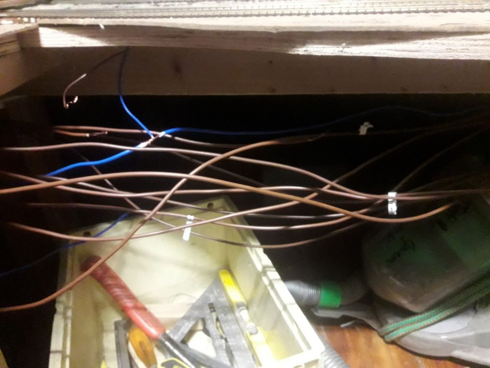

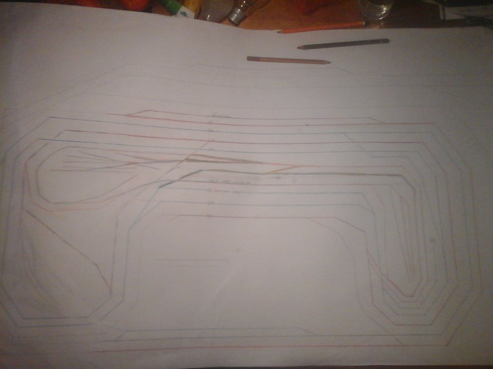

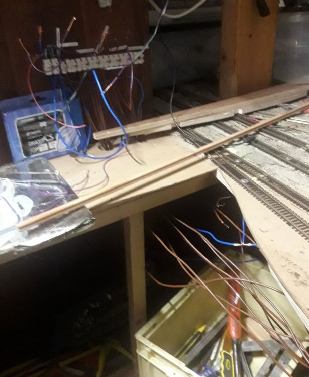

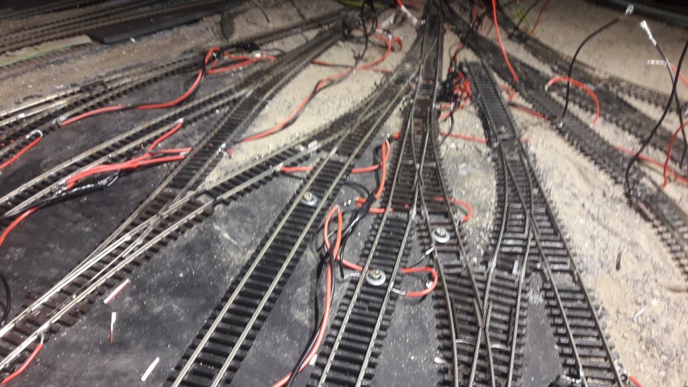

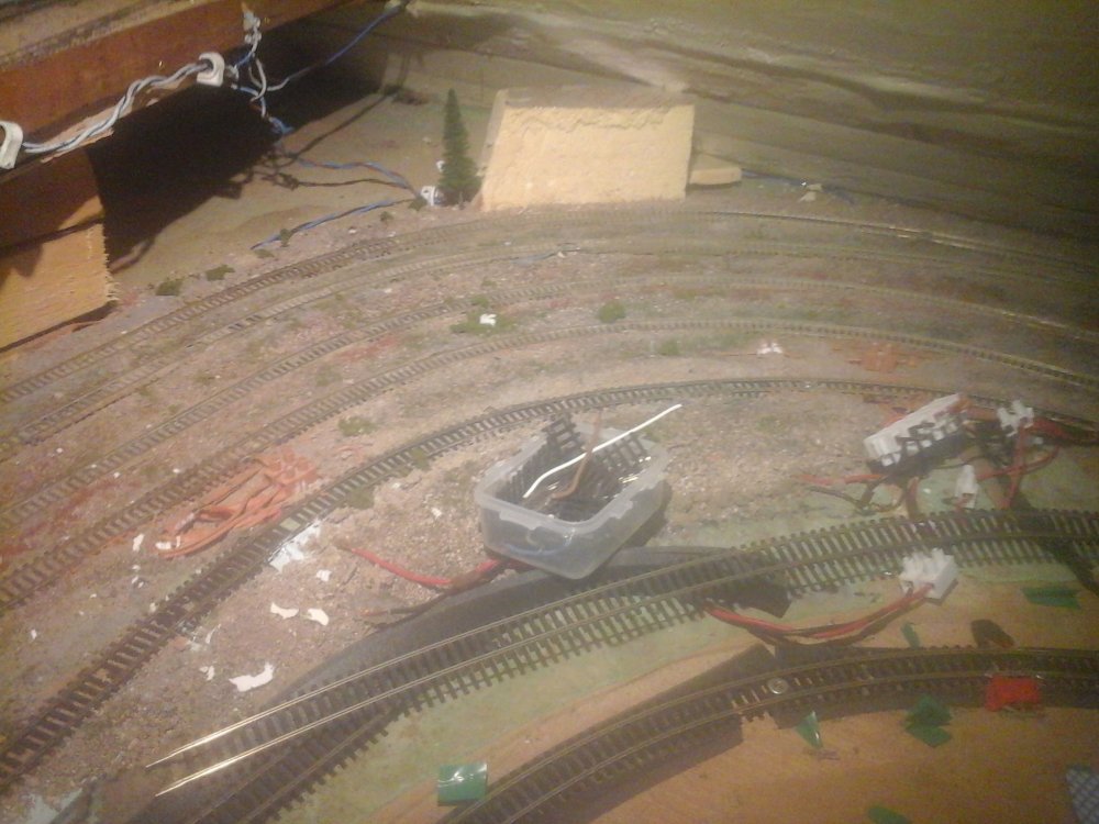

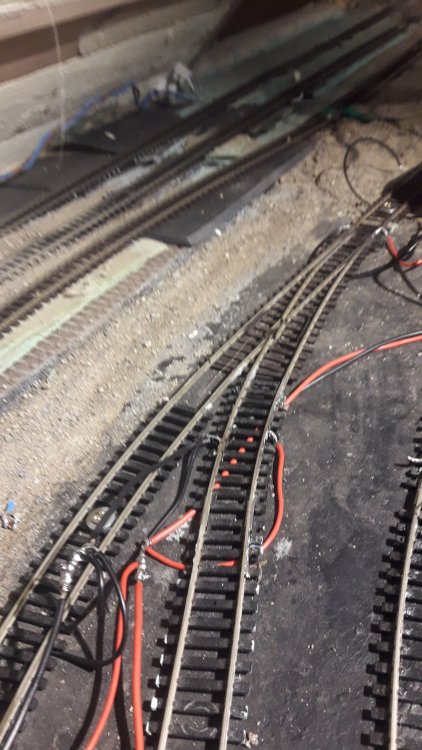

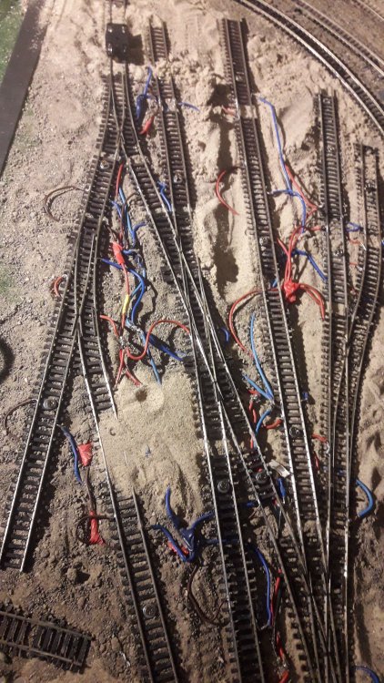

WaYSidE Posted March 26, 2019 Author Posted March 26, 2019 (edited) More, wiring the engine shed, the feeders go under the sand on top of base board. I really got going in Winter 2017, the design took two years to test and quite a bit of time Scarm railroad track planning which when i laid it out just didnt suit or run well, so i put heaps of time into laying the track freehand and abandoned the track plan. Knowing absolutely nothing about model rail, I had to imagine how the trains will travel, how they will operate, how many trains I want to have running at the same time without having to worry about crashes, especially over crossings. As the track was over an uneven surface, i started using sand to level the tracks. The design for children is based on the requirement for Not handling the models, so continuous running and having all trains on the track at all time so the kids would not lift the models of the rails, Next was the bus, once i got that sorted to a point, i stopped on the bus and plan to tidy it up only after all locos, all carriages and wagons are tested, just in case i have to tare stuff up again. On an American web site I read about what not to do, and some stuff you can do, including selective compression, say compressing 200 miles of the same scenery into 2 or three feet of landscape, says i 'why not selective compressed time'' ? events over time for different eras, as long as they are small, different parts of the layout can be different eras allowing me to run just about anything I decided that creating cameos of Irish landscapes and train history would be far more fun for the family than a fixed theme and as I had no modelling experience i didn't have the confidence to model a particular era or trainscape in the first place. My trains may run around Killiney bay in one corner, over Eskers in another, through Castlecomer coal yards, a bauxite mine somewhere else, and more ideas are developing. Personally I think having vignettes of the Sallins bridge train robbery and the ammonia train crash would be fun, any interesting small scene found through out Ireland and down through history that will fit in a small section of the layout, such as the Harcourt street crash, well at least a steam loco sticking out of the wall at the end of one station! There are heaps of wee cameos that this family can model. So far, Its taken two winters to get the layout running, so as yet we are not concerned about scenery. Anyway there's not much room as we decided to go against the grain and fill much of the space with track. Above the largest engine yard, much of this will be hidden by roof and an over head spur, marked in pink on the layout map. What not to do! Overcoming bad design issues: As well as not dropping feeders, or using conventional track underlay, my Benchwork is too wide, cos there's no crawl space to get under it, so I have designed layout to allow me to crawl over it hence the sand for stability, I can easily reach every corner to clean the tracks, jes, cleaning track takes time, but when I finish the build I suspect it will greatly improve the time spent cleaning track, without damaging the track. above, sand is spread, the wires are then pushed into the sand, below the finished ballast level. then diluted PVA at various strengths is poured. No workspace! well limited work space, but I read somewhere to have no dust = keep the work space separate, so its downstairs Limited operator space, the seating well, easily fits 3, and the staircase has a door over top so that the operators main space = 4, we had 5 people when I had 6 trains run with lots of carriages for the first time, theres not much space to move around each other Not enough room for scenery, correct, but as kids and derailments meant climbing over stuff scenery will all be on the outer tracks and walls or if on layout will be mostly movable, anyway scenery will be last thing and we have a crazy plan to put handles on larger pieces, 'just lift the whole scene off' Duplicate routes serving the same purpose, this was listed as a common error on many web sites, but my duplicate route serve as runarounds, passing sidings and storage yards for long trains. Edited March 26, 2019 by WaYSidE Quote

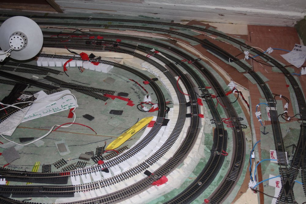

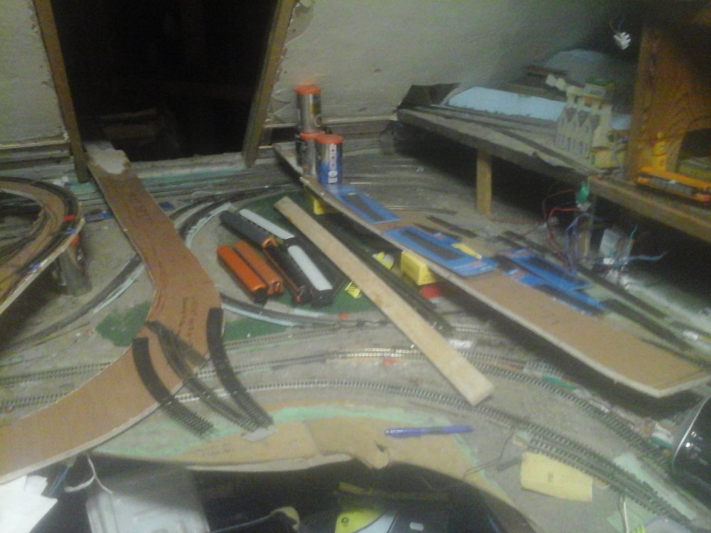

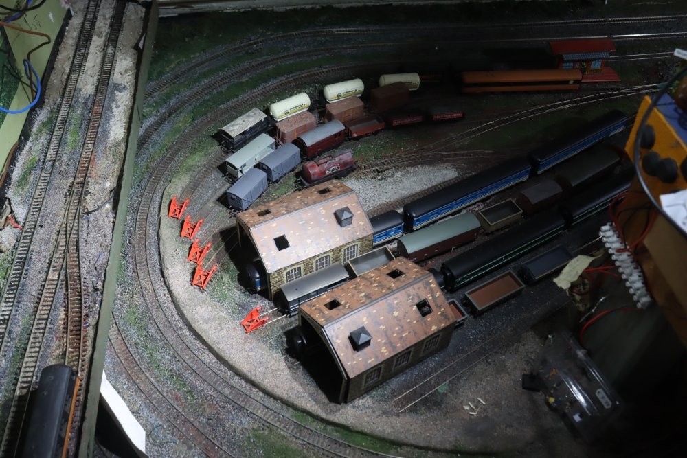

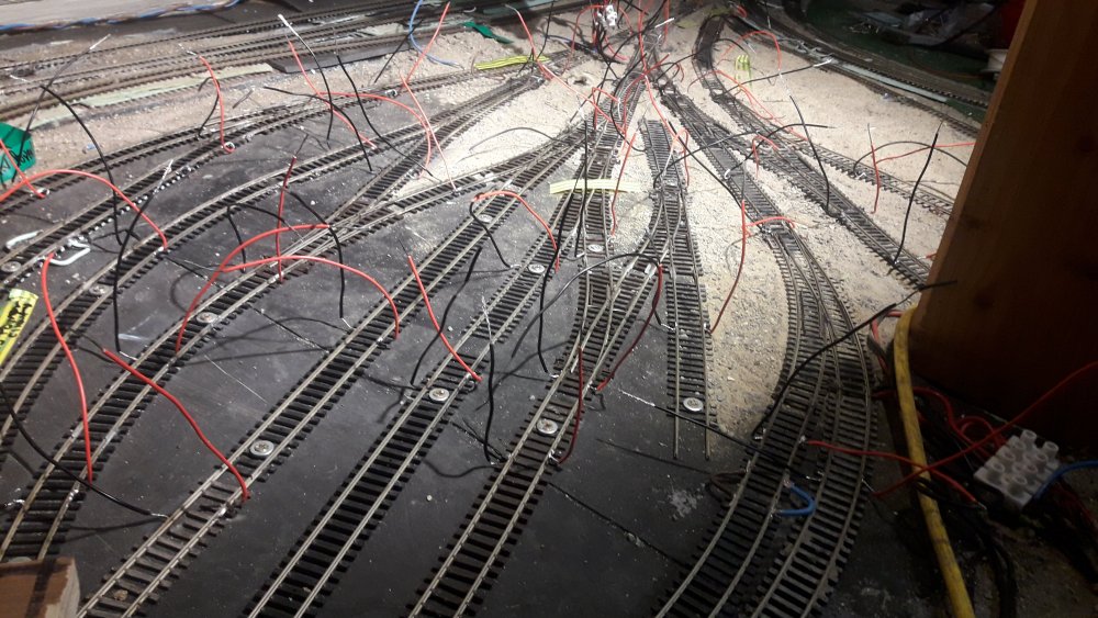

WaYSidE Posted March 26, 2019 Author Posted March 26, 2019 (edited) wiring connected and insulated, ready for point motor bases, and sand, the sand lifts the track, up over the wires and they disappear. i just getting the hang of soldering, now that most of the layout is built. fat good that is... the second smaller engine shed, this will be partially hidden behind a mid section line above this part , leading towards reversing loop. Edited March 26, 2019 by WaYSidE Quote

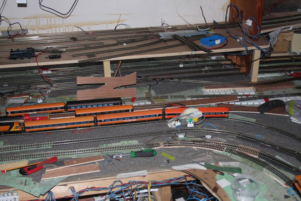

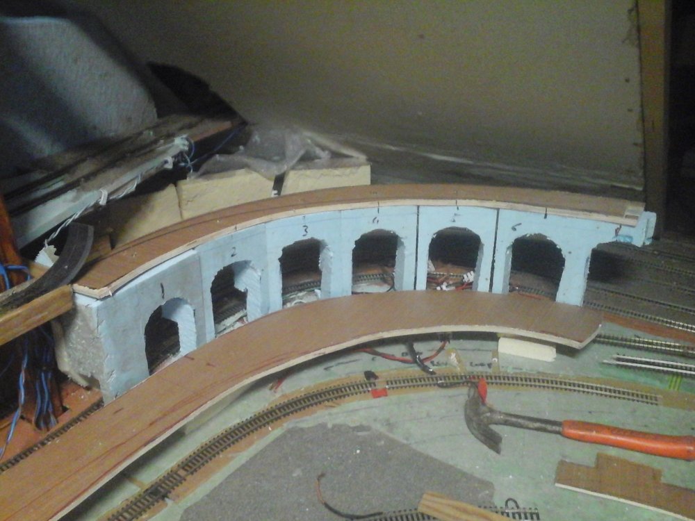

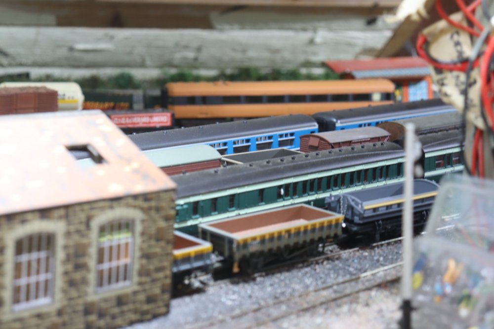

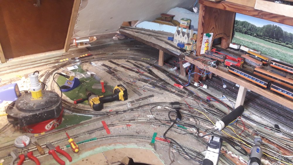

WaYSidE Posted March 27, 2019 Author Posted March 27, 2019 Time travel, back in 2017, I realised I would have to design all the tracks and build the base of the basic scenery to see if it would fit, then number it n photograph it, then take it all up and wire the bus to the tracks, the following photos show just that.. by 2018, I had enough basic landscape done to allow me to see the future. Which I promptly stored away n went back to laying track n bus wires. By winter 2019, I had installed spot lighting and this changed everything, including allowing me to see into those dark corners. Back in 2018, I rough built the viaduct, south west corner, the ply in front will be the mid section reverse loop, !! oh !! the hammer, like every good mechanic, it's my essential modeling tool, great for cleaning the wheel of my most expensive models.. Above, North West corner, rough work landscape, this is all removed once it's places is decided, n the track is fixed n rough sanded, see other posts. 3 Quote

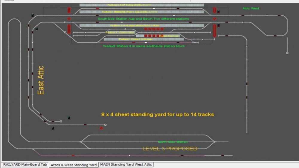

WaYSidE Posted March 4, 2020 Author Posted March 4, 2020 My forth winter constructing the 4.5 x 3 attic layout has resulted in breaking up the power blocks into train detection or occupation blocks usually about 180 to 220 cm long, aiming to run rake sizes, circa 5 or 8 coaches and 14 to 22 wagons, which meant a re-design in parts, moving 3 turnouts so the occupation blocks, had space to fit trains. I have been getting quality support and up to date qualified advice from 3 main sources, James in Dcctrainautomation, his latest Jan 2020 uploads include fab pics and screen shots, (which for someone who spent most of the winter trying to figure out the writings, the pics saved my life.) i had a section of the overall wiring plan wrong, but found out just in time. see https://www.dcctrainautomation.co.uk/blog/itrain-and-dr5000-and-block-control.html as i hadnt started laying out cobalt ss point motors or switching. so i hadnt really started to learn about turnout motors, but i did need to understand the wiring in advance. so seeing James new uploads really helped. The Digikeijs support forum is growing fast, not only for the Digikeijs dr5000 command station but also for all accessories, and since i using dr4088Ln cs, i keep revisiting. to check i have it correct, pity its a difficult to navigate blog https://groups.io/g/Digikeijs iTrain computer control, is fun, easy yet complex, and the support forum is a laugh, since few speak english, so you sorta have to be careful what you say and where you place stuff , https://www.berros.eu/itrain/forum/ but the Uk DCC blogger, on the iTrain forum called 'Lian' is a star, he explains stuff like few can and is very committed, in print, drawing, photos and video, he chats with everyone stuck with Dcc train automation. the Itrain product web is https://www.berros.eu/en/itrain/ You dont need proprietary products, its all free in JMRI open software arendino and rasberry. as i knew nothing i bought the stuff, but its not click and go unless you know how. Screenshot shows lowest level finished and built but being rewired layout on Itrain screen. the bottom left end of track circles are links to the next tab, next screen shot, the 2nd and proposed third level, including space for 10 track standing yard, as yet unbuilt. Anyway, the layout on pc is now subdivided into more stations, to make the automation more interesting.. the real layout is undergoing serious re-wiring of many sections, I had to do this prior to hopefully installing turnout motors. and figured out, just in time, that if i had to make blocks long enough to fit trains in a /entre/ occupied-break/stop-break subdivides of the power sections. some more turnouts may have to move I started up again in November, lucky i had notes from last winter, and ya know, i starting to learn stuff, so unlike last winters total struggle, i was able to start wiring the 80 possible blocks with confidence, and deal with what ever appears due to unseen possibilities. Installing Dr4088Ln Cs Digikeijs loconet current sensors is easy, yet posses huge problems for a newbee. We are told to twist long run bus wires, about radio interference within wide spaced pairs of wire, how two wires together cause transfer of data and interference. ... a red light went up and those poor wee model workmen in orange dayglow went back into there box, halt all works The wiring is not what it says on the box, there can be a lot of wiring when using current sensors, luckily i now really enjoy wiring , a few years ago it was doing my head in. where does the negitive blue of blue and brown pair go, ? if not back with all the single feeds to track,,? Some blocks are 300cm long in total thats 16 wires running to 1, 2 or 3, sectioned power blocks. (making up a power block of 3 sub blocks or sections,) and that could be 16 individual block or 5 x 3 sensor blocks 15+1= 16 inputs on Dr4088lncs, thats a lot of wire, and no where on the internet does it say twisted or not from track to dr4088lncs.. yes it talks about twisted buses everywhere else... At as the common wire (-) is not returned to the dr4088lncs, then there are loads of places where I was running single long 1.5 wires and cursing the day I ever read about interference to misa's precious radio. i even started listening to internet modeltrain radio, to avoid interference, while doing hours of re-wiring i have to admit, this is highly unlike me, i am starting to act strange in relation to this train stuff and model rail radio. as i have no power connected, I have no way of testing, (you say , 'just turn on one section at a time') but the space is so small the works tools solder tracks wire and loads of other bits are all over the layout as i have no where else, so its wire the entire layout, clean up, then test section by section. screenshot shows level two and three and unfinished standing yard to store trains .. itrain Blocks. the blocks have to be considered and designed, first is an ,'Entre' section, its short, but long enough for a long loco without train to travel clear of points and send enough occupied signal with good track contact. the next section, which is called 'Slow down', 'Occupied' or 'Break', the length and speed value of train and length of track are used by Itrain software to calculate and run the loco smooth and slow, ready for the third and final block, the 'stop block', , Screenshot show close up of finished blocks. the dark red lozenge marks the sensor track, the white block in the track=the name of the block, blocks do not include turnouts only one of my stations lines has four sensors to represent a station in JMRI, which has different rules and controls. In Itrain stations also have different rules and controls. Block design the 'stop block is, usually placed before a signal, (signals are along way off on my layout ( but i will get one cheap signal to set up to let me know what to expect and keep the wiring plan flexible for signals in the long term ) .. the final block is the stop block, it also has to be long enough to allow the train to stop, esp' where you want it to stop, then you have to imagine the same block from the other direction if its bi-direction track route. so enter become stop and visa versa, many blocks just have one sensor other two, each gives different results. The software does the rest. well almost... the following pics are my first attemps, i am getting tidier as i progress each dr4088 instalation Generally 3 sensor sub sections on one block is used in stations, two for signals where the stop section is long out on the mainline. but many layout its seems can only fit two which is a common standard.. whatevr, theres alot of wires running 2 or 3 metres from each dr4088,, the negitive (-) track is unbroken in the block but isolated at each end usually next to turnouts, the + side of track is isolated into sections in the blocks at again at both ends of total block. each individual current sensed wire is brought to a choc block and a thinner wire connects to the dr4088lncs above pic is right way up, dr4088 is upside down , but it does not matter , this is the first in the loconet chain, beside the main board for dr5000 and Z21 next to laptop, below, setup to choc block while was waiting for dr4088 to arrive by post, which it did in rapid time, above, 1.5 brown + positive wire run from track sections back to dr4088 below, connection into each of 16 terminals, i need to improve my wiring and have no copper showing, but when i turn on the power these will all be disconnected, trying the tracks one at a time, so i will fix the problems then and label each wire. below, stuff all over the layout, the lima and hornby wagons are used to test tracks without loco attached, nor power on Since November i have advanced my knowledge somewhat, i have worked out how many boosters i will need and when and where i have to install them including which dr4088's go with which booster in the double isolated boostered power blocks, i have decide that my original plan of having all groups of turnouts on one booster is correct. the mainline will run mostly off command station built-in boosters, as that run of track is i hope least likely to have shorts circuits, I still dont understand why i dont need circuit breakers, but theres no rush. I received my first IRM wagons, 42's, ferts, plough, cements , taras and spoils. these are mostly still boxed, as are all my stock, until the track is fully functional, that could be a few years yet. but as spring arrives this farmer, hs to get back out so if i get some track and stock up and running this year, it will be a bonus. the kids are busy playing computer games so they have forgot about train for now,,as per comment above this post. thats the update on installing DCC block occupancy train detection, using current sensors on current sensors Dr4088Ln Cs Digikeijs via loconet . thanks for reading... 4 Quote

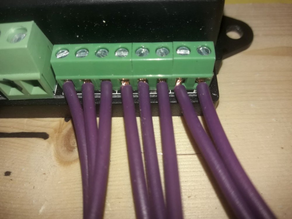

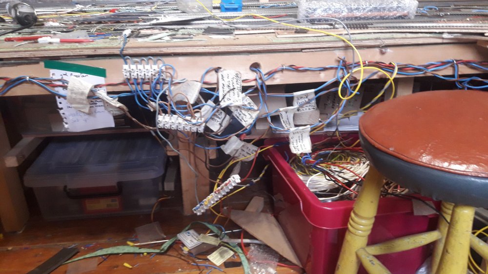

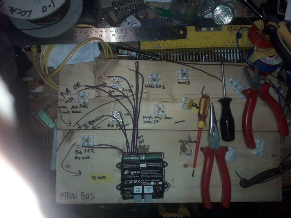

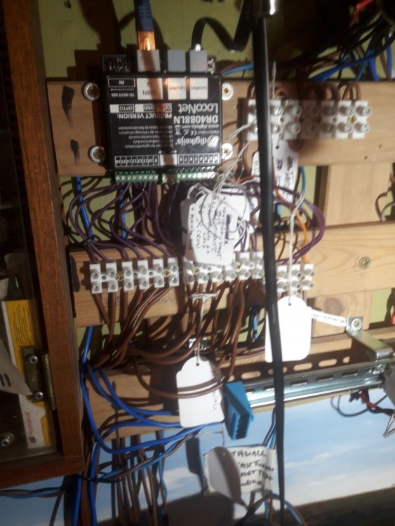

WaYSidE Posted March 7, 2020 Author Posted March 7, 2020 un-twisted occupancy detection wire, a question about boosters? and too many beers and out with the reverse loop Today, stuff moved on, i finally got a definitive answer as to twisted occupancy detection wire, as i suspected, Do not twist the wire between dr4088lnsc and track, as the negative - blue wire is common and that goes everywhere, except back to dr4088ln-sc , which is really only for positive wires, contrary to a youtube vids or two. The blue wire joins the command stations twisted main bus and is split out before the dr4088, i just mount a block on the wall and connect all the commons up close to the main bus, not far from the pos + wire going from main bus to dr4088's, (dr4088's come in a few varieties, In my case its DR4088LN-CS) So there I was bent over in the tightest of corners most of the afternoon, i managed to wire up 7 runs of block wires, all soldered and coated with insulating paint. the next four to do are inner tracks, more ceiling space for me!. I will have more blocks and sub sections to do, but the work will be far easier to reach and work should progress faster from here on. I took a photo of the work which i hope to upload someday, its shows the cramped space. the multitude of wires that cant be tidied until all 16 wires return to a dr4088. i t reminds me of spaghetti with anchovies. Boosters Dr5033, There's no point in adding boosters if the track work dont run everything correctly, so for now the power plan is being kept simple, one booster on which to test tracks and not burn out command stations as i start up the system after testing. Looking at the spaces i left for boosters, figuring out how many i really need, the original plan was 1 x command station with its built in 3amp booster and 1 x booster mainly running the clusters of turnouts dotted about. the plan was running 6 trains at once. but the capacity of track space to run from 12 to 30 plus locos with lights full on in yards. many turnouts, steep rising tracks 2% plus, and cobalt SS surface motors, sorta worked out at 5 boosters x3 amp or 3 x 5amp , still not certain, but in looking at all that , its better to leave the scalable up option designed into the wiring than do what many seem to do, rip it up again, as i had to do in parts, to reduce boosters, I scaled back somewhat. before the beer, i ripped out the rising reverse loop, for i long suspected the best place for the drama of the reverse loop was to have it hidden behind a tunnel. so today, the route i had planned in the first design was ripped up finally to match the latter Itrain layout, shown somewhere above on this page.. some day i can build a reverse loop as there is space in the east attic, but its no longer required due to block occupancy, it was in place to reverse a route where the mainline 'A down eventually got stuck in a tight dead end'. All in all, Thats one less booster at the west end where there is no longer space for mounting accessory space. a productive day. Quote

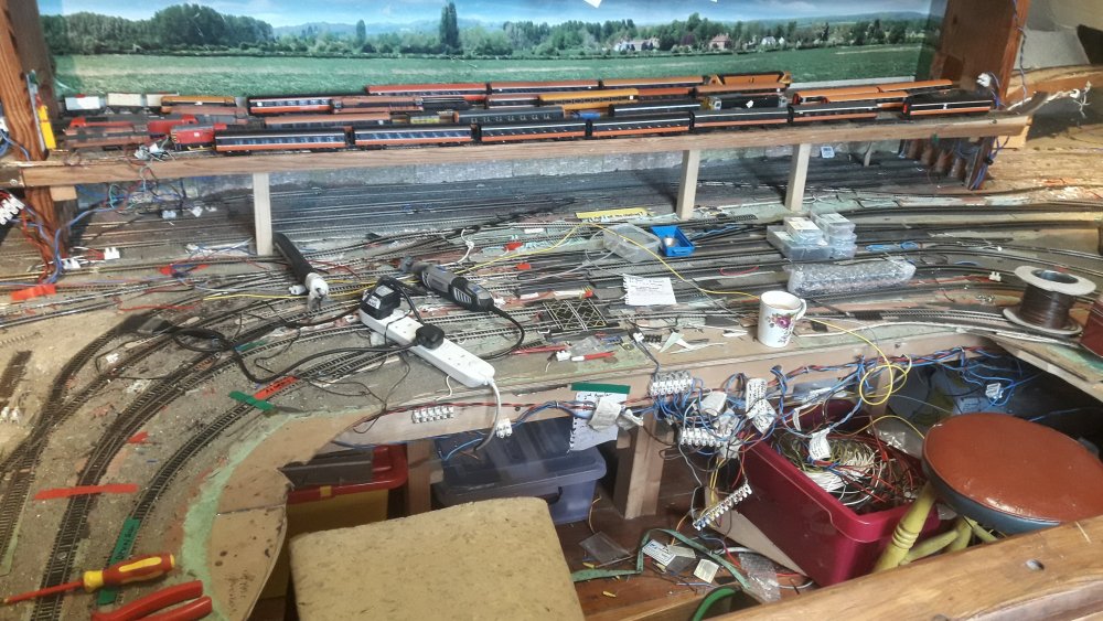

WaYSidE Posted December 7, 2020 Author Posted December 7, 2020 blog, track laying update - nov 2020, after long summer, finally got time off to finish the track block occupancy wiring and set up. with over 100 tracks to re-wire to the digikeijs dr4088cs Loconet current sensors . having tested sections and got the digital side software working, i moved on to spreading buckets of washed fine sand as ballast, which made the uneven base board easy to level tracks on, much like laying patio slabs, one could say the construction works are very prototypical or indeed proto-topical ! even got to unbox some limas and a few hornby models to test the tracks, tedium is fixing every nick and bump, bad solder and more.. well over 70% done of the >150 metres of track. there are a few unopened boxes of IRM models, but until everything is fully tested and working, these will stay in boxes. i just have to will watch all your vids and pics and drool, until i get going at this rate first full run, should be about march 2028, 2 1 Quote
