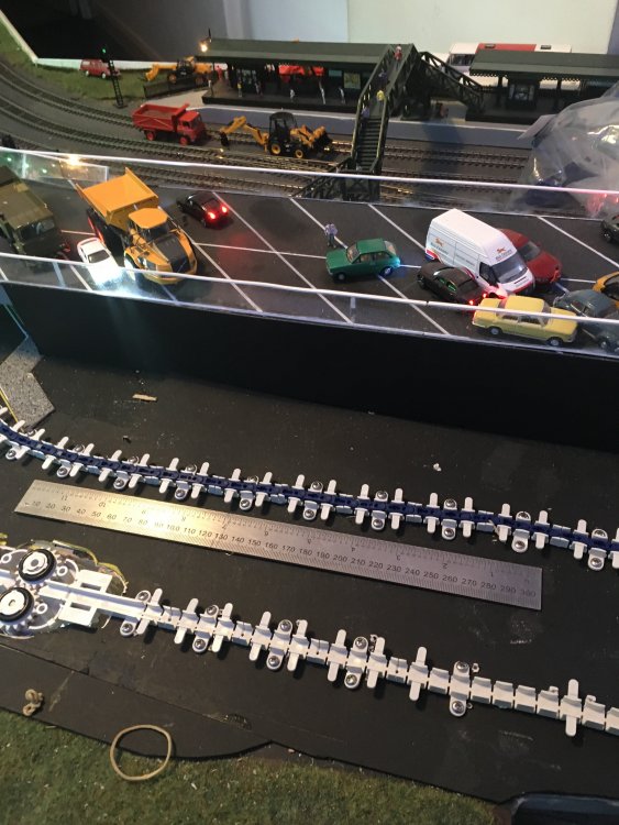

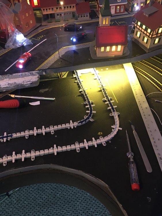

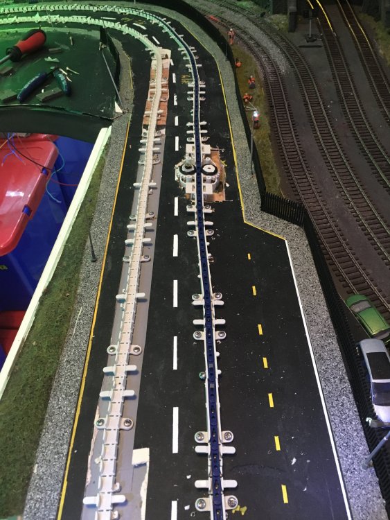

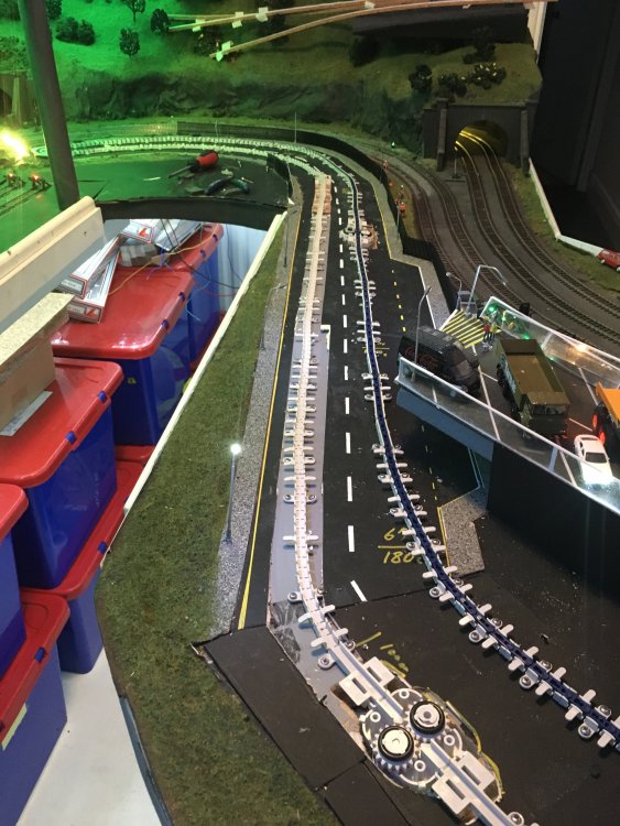

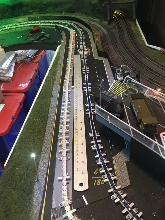

0 joe123 Posted March 2, 2019 Author Posted March 2, 2019 Hi Eoin Sorry about the delay in getting back to you. I have the rail fully laid. And had the chain in place, with a temporary road bed laid on top. But I cannot get the right tension on the chain. Here are some photos. Thanks for your help. Regards Joe

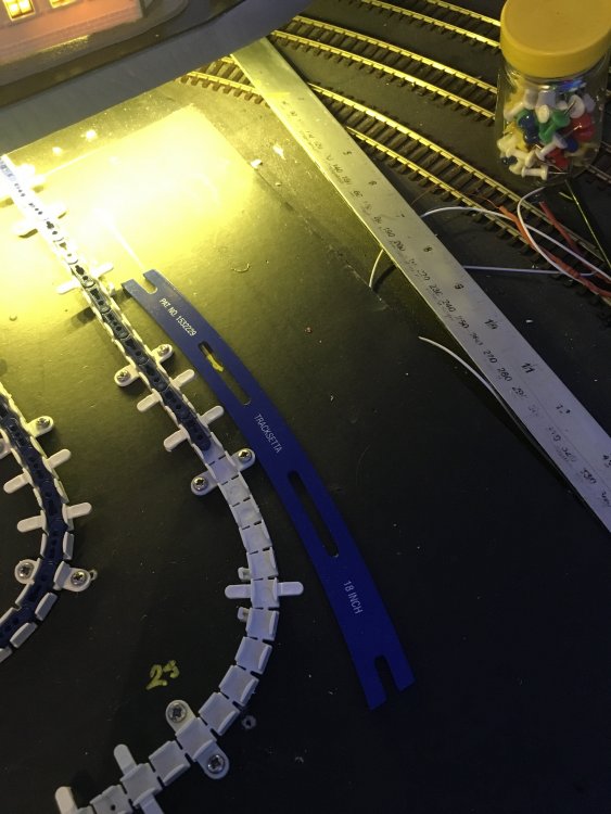

0 joe123 Posted March 2, 2019 Author Posted March 2, 2019 Sorry Eoin forget to mention the full length of the rail is 610 cm. And I am using the two 12v motors . I tried to measure the radius of the rail, using the 18 inch tracksetta . See attached photo. Thanks.
0 murrayec Posted March 2, 2019 Posted March 2, 2019 (edited) Hi joe123 Thats a lot of Magnorail. When you say 'cant get the right tension on the chain' - what do you mean? Is the chain connecting up? or, Is the chain slipping? or, Does the chain run OK without cars on, and doesn't when their on? In the third photo I see a rather tight curve! for a curve that tight one should use Magnorail's return loop (modified) which will reduce friction. For 6 meters of soft curve rail you should have at least 3 motors- which may run up to about 6 cars. With the layout you have done and if you want to run more than six cars I would put a motor in per meter of track = 6 motors! If you use the return loop unit on the sharp bends or increase all sharp bend radius you may get away with 4 motors. Am I right in saying that you have two separate Magnorail tracks of 6 meters long each? If thats the case you'll need to up the motors on both! I know that might be not what you want to hear, but Magnorail is really designed for nice wide radius loops and small layouts! Eoin Edited March 2, 2019 by murrayec
