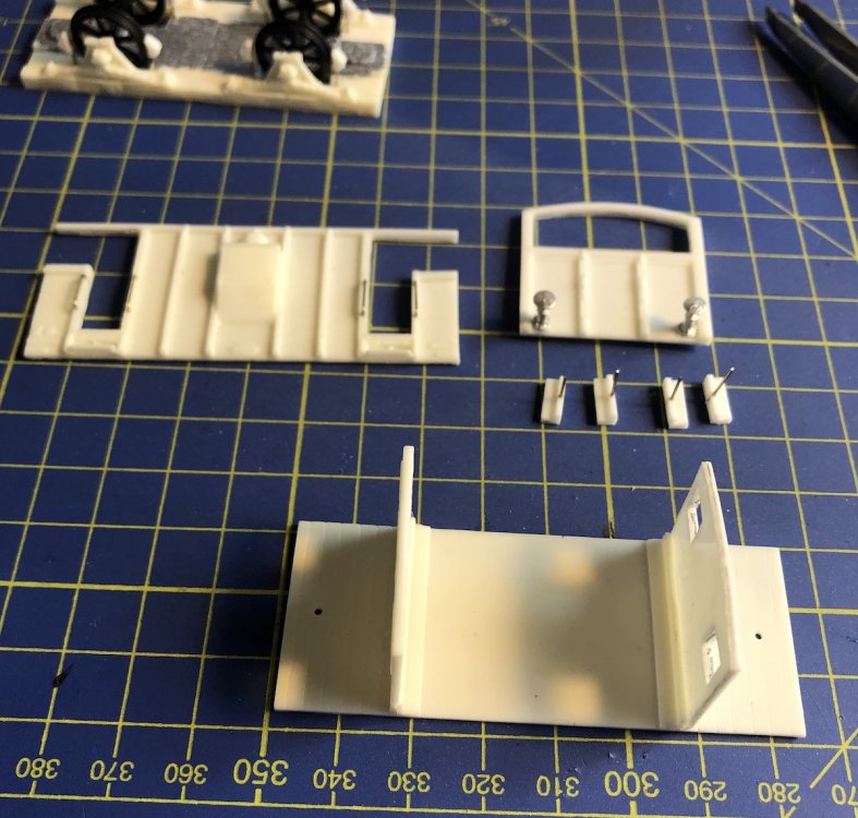

Parts assembled, deflashed and filed where required.
Getting used to these fiddly brake stuff gubbins
Kit goes together nicely once the parts are assembled and have been prepared

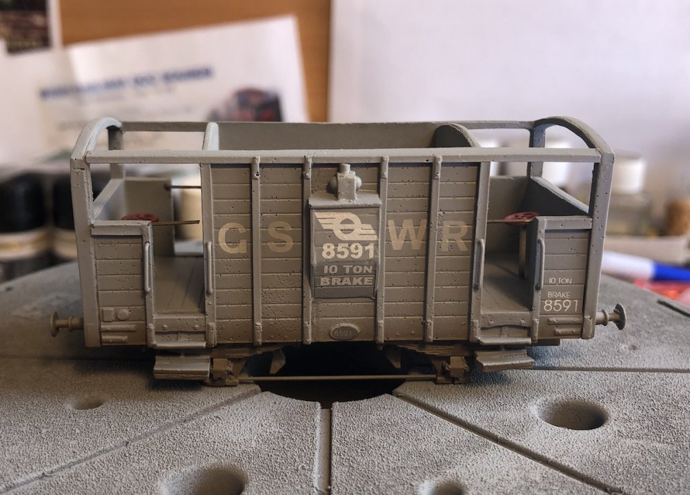

Even though the brake wheels won't be visible from outside once the roof goes on they had to be painted red.
Prior to final fitting of the roof

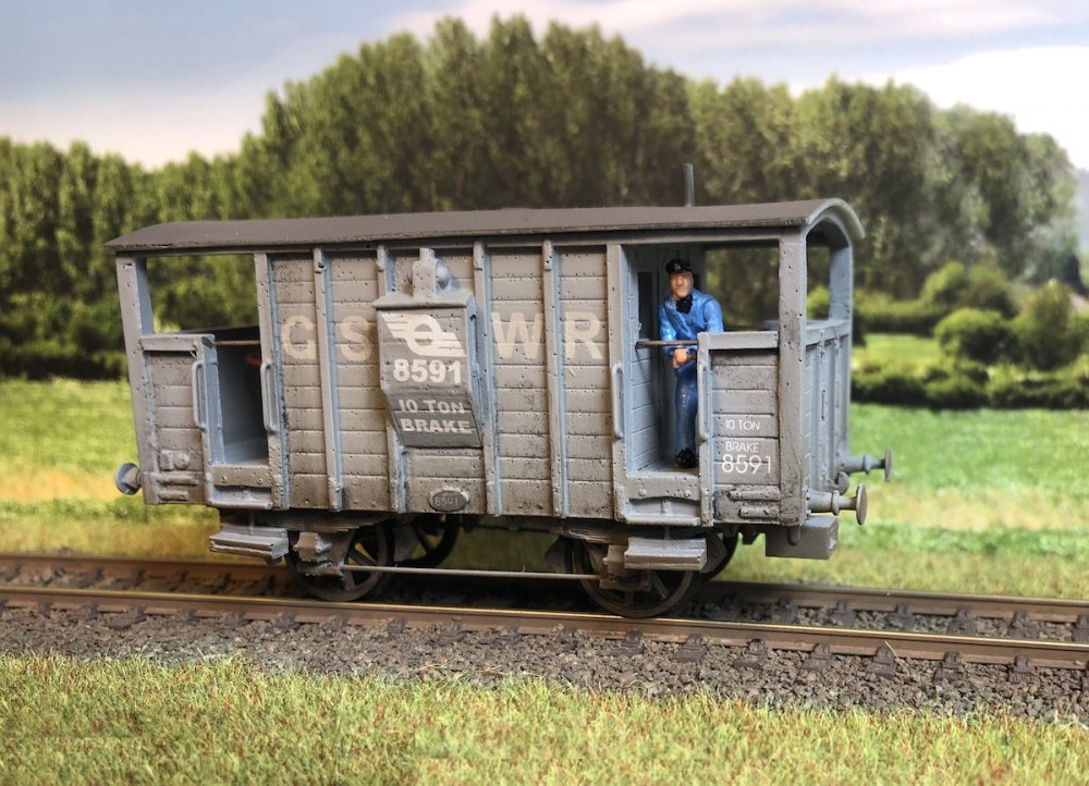

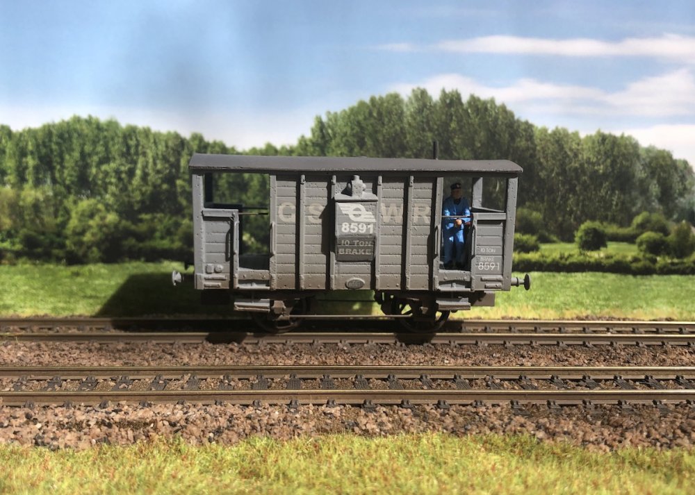

Had to put a little man on the veranda. A very pleasant wagon I'm delighted to have on the layout. Straddles my preferred era nicely.

That looks really good Noel, I also replaced with wire the brake hangers and step supports it makes such a difference. And I put a brake cross beams between the brake blocks plus a longtitudal fake pull rod. A really nice kit thats a pleasure to build, it looks so good behind a J15  :tumbsup:
