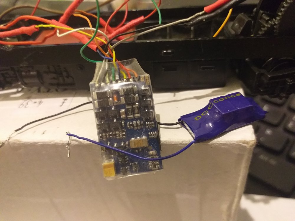

I have this decoder connected to a ringfield motor on a hst 125. The wheels are as clean as I can get them, the motor has been taken apart and cleaned, and runs well. Problem is, when I try to run the train it stops and starts, I have to give it a little nudge to get it going again. If I connect the stay alive to the decoder, would it help. If so ,where do I solder the blue and black wires?. Or would it make any difference at all?.

Been a long time since I messed around with decoder so have forgotten quite a lot.
Test the motor on DC, connect power to the wheels first , then test on a section of track.
If it runs well on DC then there's an issue with the DCC decoder or CV settings such as starting voltage etc if its struggling the same section of track.
I'd start by resetting the decoder to factory settings (CV8 to 8 usually) which is usually sufficient to get most thing started.
The Stay Alive will work for dirty track but not if it runs well on DC already. Which decoder? Do you have the manual? If not, it may be online
