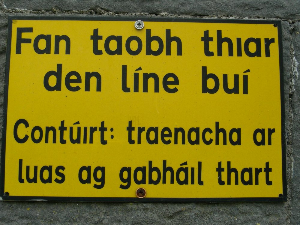

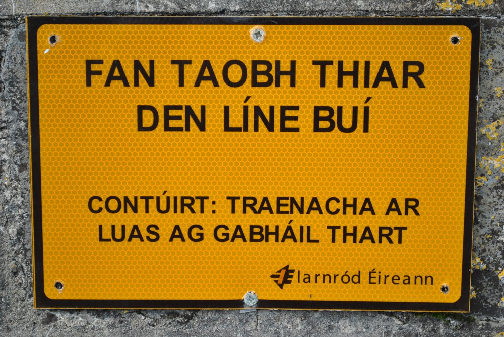

0 Broithe Posted December 10, 2020 Posted December 10, 2020 The warning signs have changed a few years ago. The old one... ... and the current one. 1

0 Billycan Posted December 11, 2020 Posted December 11, 2020 Thanks Broithe. Líne buí is embedded in my brain and I was surprised it's no longer there. Might be something to do with this. A friend was told at a security check to 'Stand behind the yellow'. The place was packed with people and there was no yellow to be seen anywhere so he stood in line behind a lady wearing a yellow jacket. He was escorted from the line by a guard with hand on open holster. Nice notices. 8118
