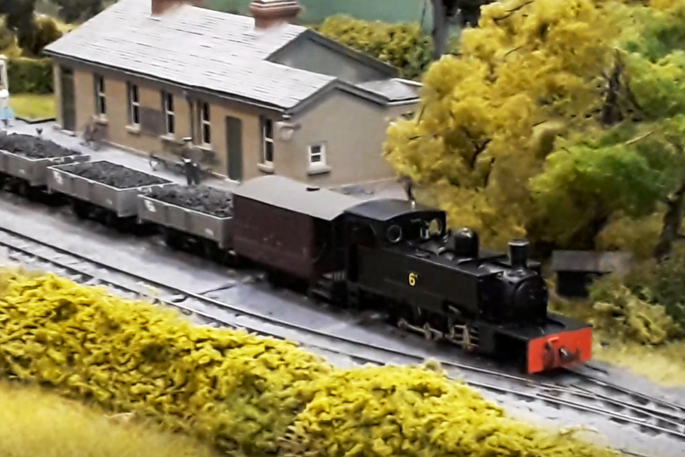

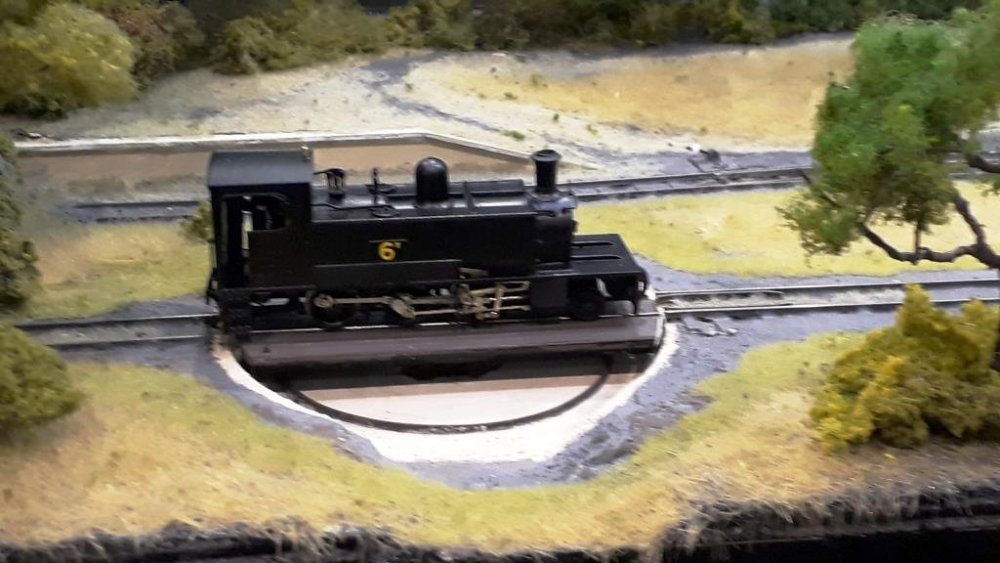

Hi Leslie 6T made a couple of trips up to the Arigna mines at Ally Pally today and a couple of photos are attached - old mobile phone I'm afraid so not great quality. The thicker wire running centrally between the frames controls the horizonal movement of the truck, the cranked wire against the frame is the suspension wire. It all seems to work ok so far! Phil

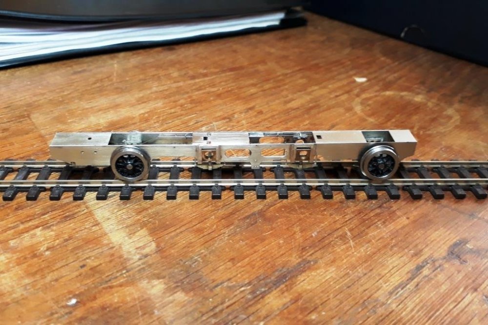

The radial trucks are based on the London Road Models ones for their LNWR radial tanks and the gearbox started out as a High Level Slimliner but now has been on a serious diet and got new sideframes. The springing does bear on the trucks as you can see in this photo. And this is where we stand now Phil
For those who have asked there has been some progress with the 2-4-2 chassis which has reached the stage of a 2-0-2 (!) with the radial trucks in place. The springing for the driving wheel hornblocks is visible. The gearbox has to be very slim to fit between the suspension springs with the motor mounted at an angle to allow access to the fixing screws. Driving wheels next! Phil
