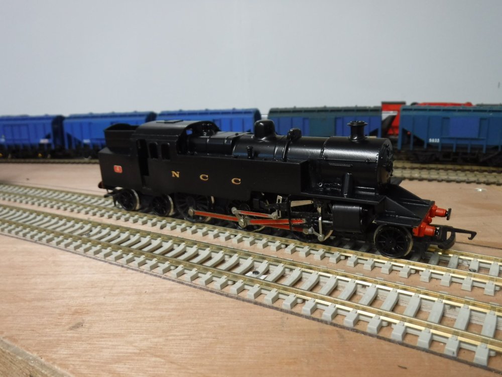

NCC WT class from Hornby LMS Fowler class 4, 2-6-4 tank
gibbo675 replied to gibbo675's topic in Irish Models

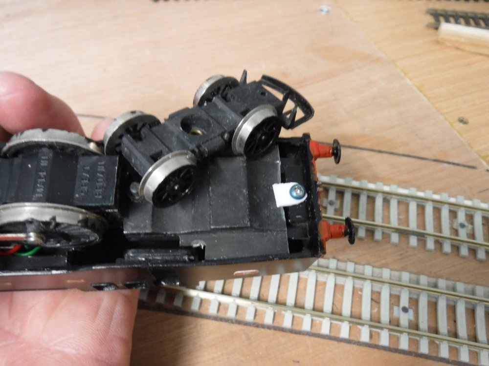

Hi Folks, The fixing washer was made from .030" plasticard with a small self tapping screw to hold it all in place. One end was radiused so that it may be swung out of the way to remove the body rather than undoing the screw completely. The pin that locates the bogie is to be removed and a nut an bolt will eventually hold the bogie in place. Here is the almost finished locomotive. It will be sent on unlined because I don't have any lining, a poor excuse but true. All that is to do is apply the numbers to the buffer beams which I shall do in the morning. Gibbo.- 12 replies
