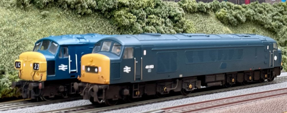

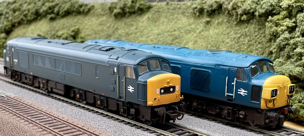

Horsetan Posted November 9, 2024 Posted November 9, 2024 1 hour ago, Darius43 said: Calling this finished. How does it compare to the oul Mainline and current Bachmann bodies?
gibbo675 Posted November 9, 2024 Posted November 9, 2024 33 minutes ago, Horsetan said: How does it compare to the oul Mainline and current Bachmann bodies? Considerably heavier ! Gibbo. 1

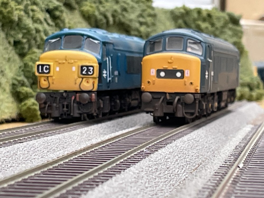

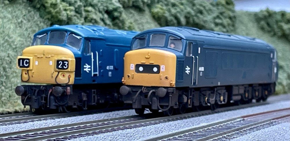

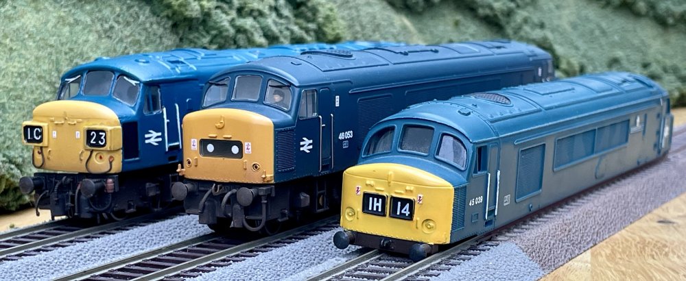

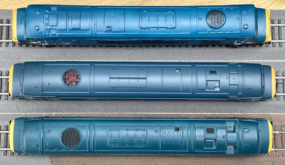

Darius43 Posted November 9, 2024 Author Posted November 9, 2024 1 hour ago, Horsetan said: How does it compare to the oul Mainline and current Bachmann bodies? Comparison with Bachmann 46… And with the Mainline 45 body - I used the chassis for the MTK model. The Mainline body is slightly shorter than the other two, doesn’t have flush glazing and has an incorrect body-mounted buffer beam. Cheers Darius 2 1
gibbo675 Posted November 9, 2024 Posted November 9, 2024 26 minutes ago, Darius43 said: Comparison with Bachmann 46… And with the Mainline 45 body - I used the chassis for the MTK model. The Mainline body is slightly shorter than the other two, doesn’t have flush glazing and has an incorrect body-mounted buffer beam. Cheers Darius Hi Darius, An interesting juxtaposition there. I have a Mainline class 45 that will be subject for modification sometime in the future. The obvious fault are the buffer beams, although the cab front windows require a slight reprofile and opening out and also the the nose end is not quite high enough and requires building up by about .040". The MTK kit does show certain improvements over the Mainline model and I think it is a better looking representation as a result. Top work as ever, Gibbo. 1

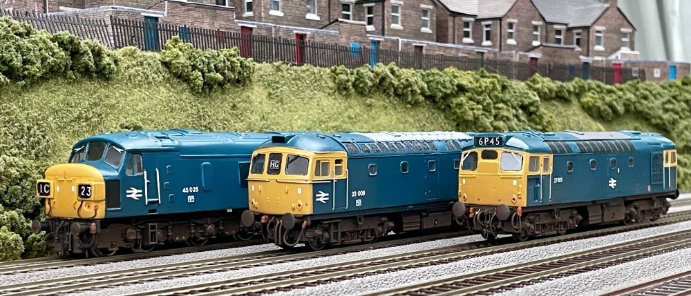

Darius43 Posted November 10, 2024 Author Posted November 10, 2024 (edited) MTK Class 33 finished this afternoon. Cheers Darius Edited November 10, 2024 by Darius43 9

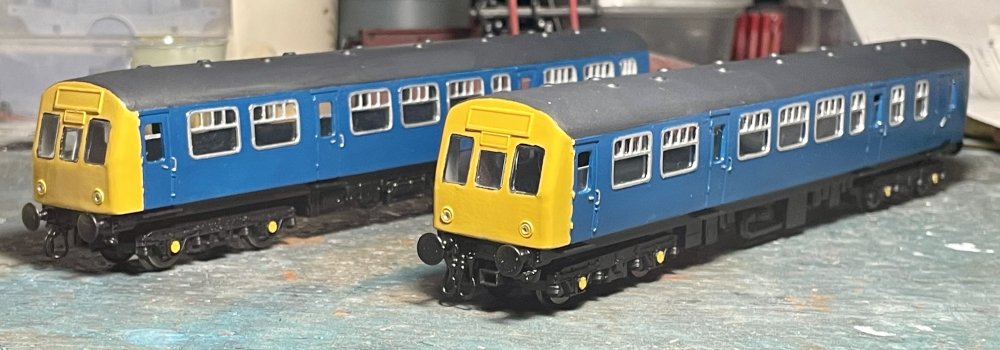

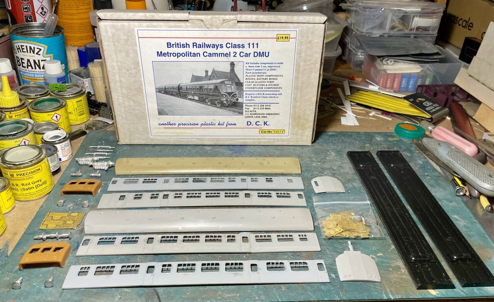

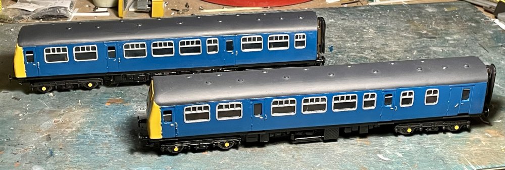

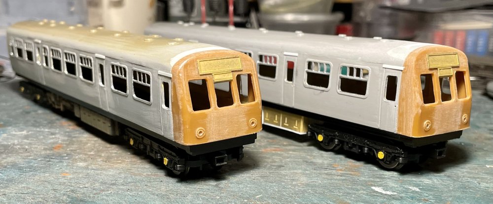

Darius43 Posted November 15, 2024 Author Posted November 15, 2024 This week I have mostly been working on a DC Kits class 111 DMU… Cheers Darius 6

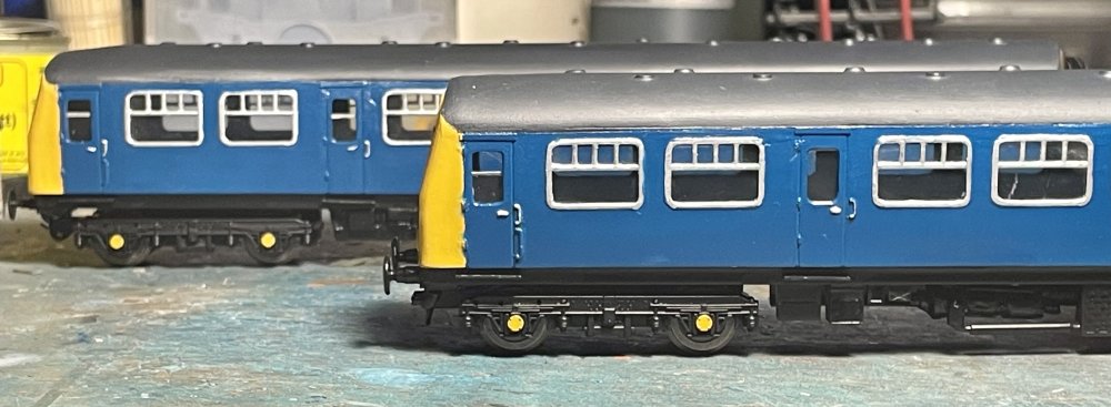

Darius43 Posted November 15, 2024 Author Posted November 15, 2024 Decals and further details applied. Cheers Darius 7 2

Darius43 Posted November 17, 2024 Author Posted November 17, 2024 Ironmongery fitted and primer on. Cheers Darius 6
Darius43 Posted November 18, 2024 Author Posted November 18, 2024 (edited) Primary painting completed. Spare Limby interior modified with a plasticard buffet area. Cheers Darius Edited November 18, 2024 by Darius43 4

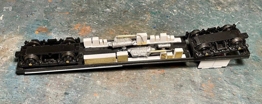

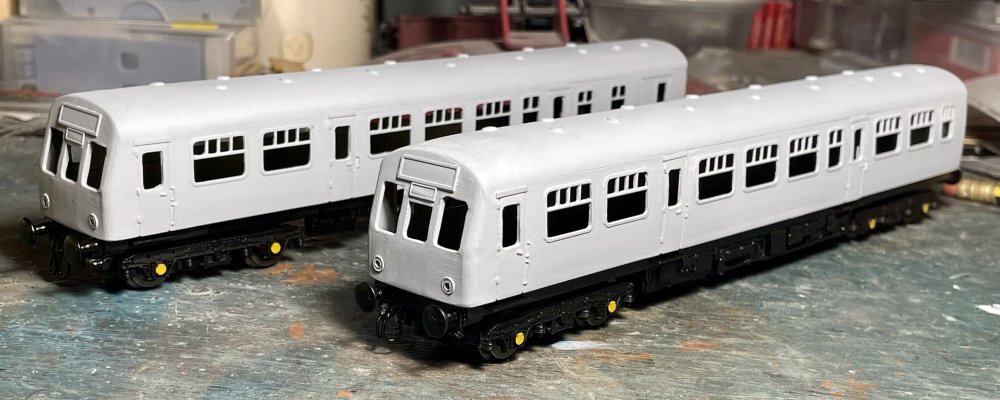

Darius43 Posted November 19, 2024 Author Posted November 19, 2024 Chassis completed and glazing fitted. Cheers Darius 7

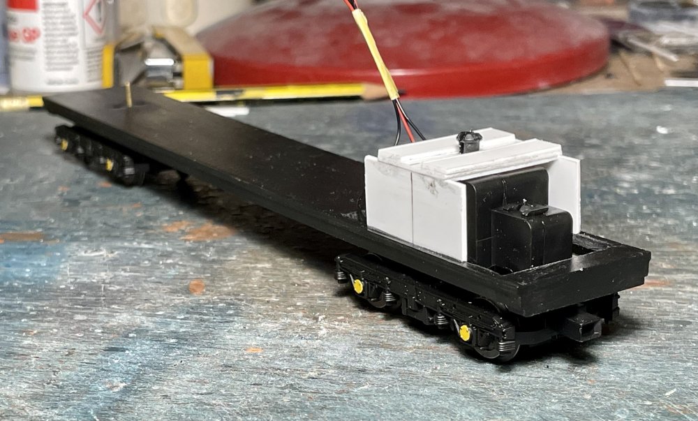

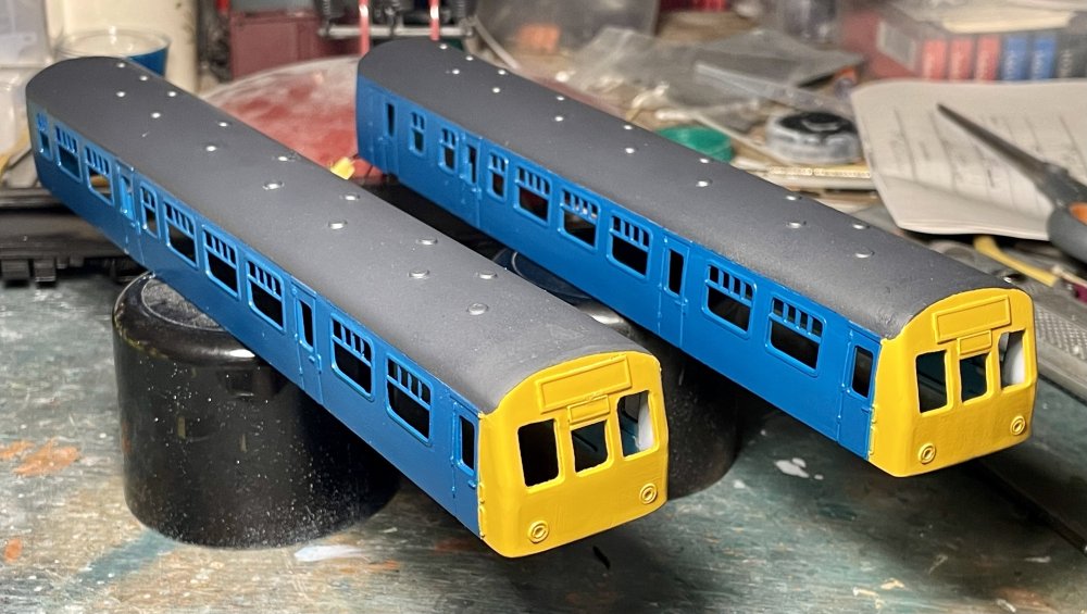

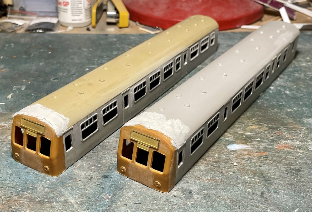

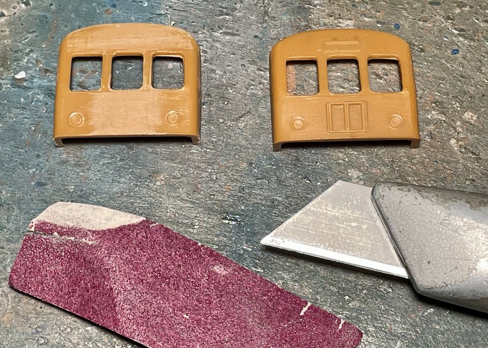

Darius43 Posted November 20, 2024 Author Posted November 20, 2024 Started this morning. Plan is to adapt these Hornby chassis to fit the MTK bodies. Sides and roof parts joined together with plasticard reinforcement. Whilst gluing, I lined the roof edges and tops of the sides against a steel straightedge to ensure that these edges were true. Gaps have been filled at this stage and the bottom edges of the bodysides tidied up. Cheers Darius 4
