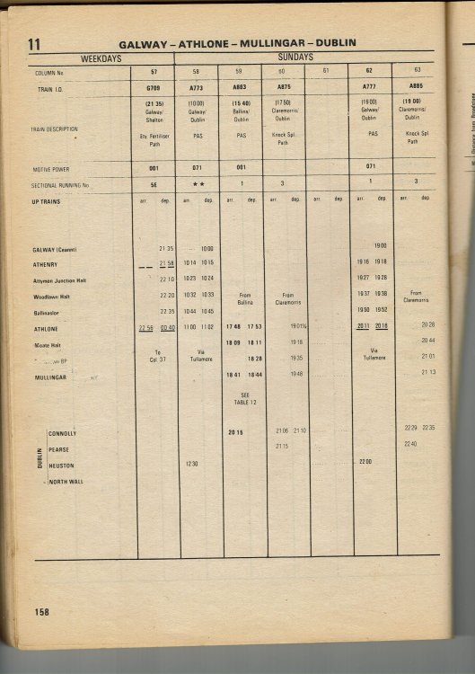

jhb171achill Posted February 23, 2024 Posted February 23, 2024 OK, here we go. This is 13.1.1986 until further notice; turns out I don't have 1987, but it's likely exactly the same. Trains in BOLD run every day; others are just paths and may or may not run. Down trains: 00:25 Shelton - Abbey - Galway fertiliser PATH dep. Mullingar 05:50, arr. Athlone 06:46 Loco: 001 09:35 Shelton Abbey - Ballinasloe fertiliser PATH dep. Mullingar 15:30, arr. Athlone 16:41 (Stop scheduled moate 16:07-16:230; reason not apparent, probably to fit in with paths west of Athlone) Loco: 001 18:50 North Wall - Ballina Asahi Liner Pass Mullingar 20:43, arr. Athlone 21:36 Loco: 001 21:45 Connolly - Galway Mail Dep. Athlone 23:07, Moate 23:36-23:51 (Crosses up train), Athlone 00:16. Loco: 121 On Saturdays, this runs earlier, dep. Connolly 19:50, dep. Mullingar 21:14, arr. Athlone 22:15 Up trains: 22:35 Ballina - Shelton Abbey Empty Fertiliser PATH dep. Athlone 00:40, arr. Mullingar 01:30. leaves at 02:25. Loco: 001 02:25 Ballina - North Wall Asahi Liner (Tues - Sat) dep. Athlone 05:27, pass Mullingar 06:19. Loco: 001 22:00 Galway - Connolly Mail dep. Athlone 23:20, Moate 23:45-23:48 (crosses down train), arr. Mullingar 00:18 Loco: 141 SUNDAYS No regular trains, but three DOWN paths and two UP paths for Knock specials from PEARSE, motive power not specified for any of them. Note: Two down paths for ferts, butn only one up; the other obviously going via Portarlington when it runs. Also, the WTT shows a 121 for the down mail and a 141 for the up working. Of course, these could be interchangeable. These two mail trains, which crossed at Moate between 23:36 and 23:51, were the only trains on the line by then (and for quite a few years earlier), which carried passengers. Hope this helps. JB 4 1

jhb171achill Posted February 26, 2024 Posted February 26, 2024 10 hours ago, Mayner said: IE replaced the 4w flat wagons used for carrying Hazardous Freight on the Asahi line with Bogie Wagons at some stage before the factory closed in 1997. The ending of Mail Trains and Sundries Traffic would have released bogie wagons for use on the Asah Good point. I’d forgotten about that.
