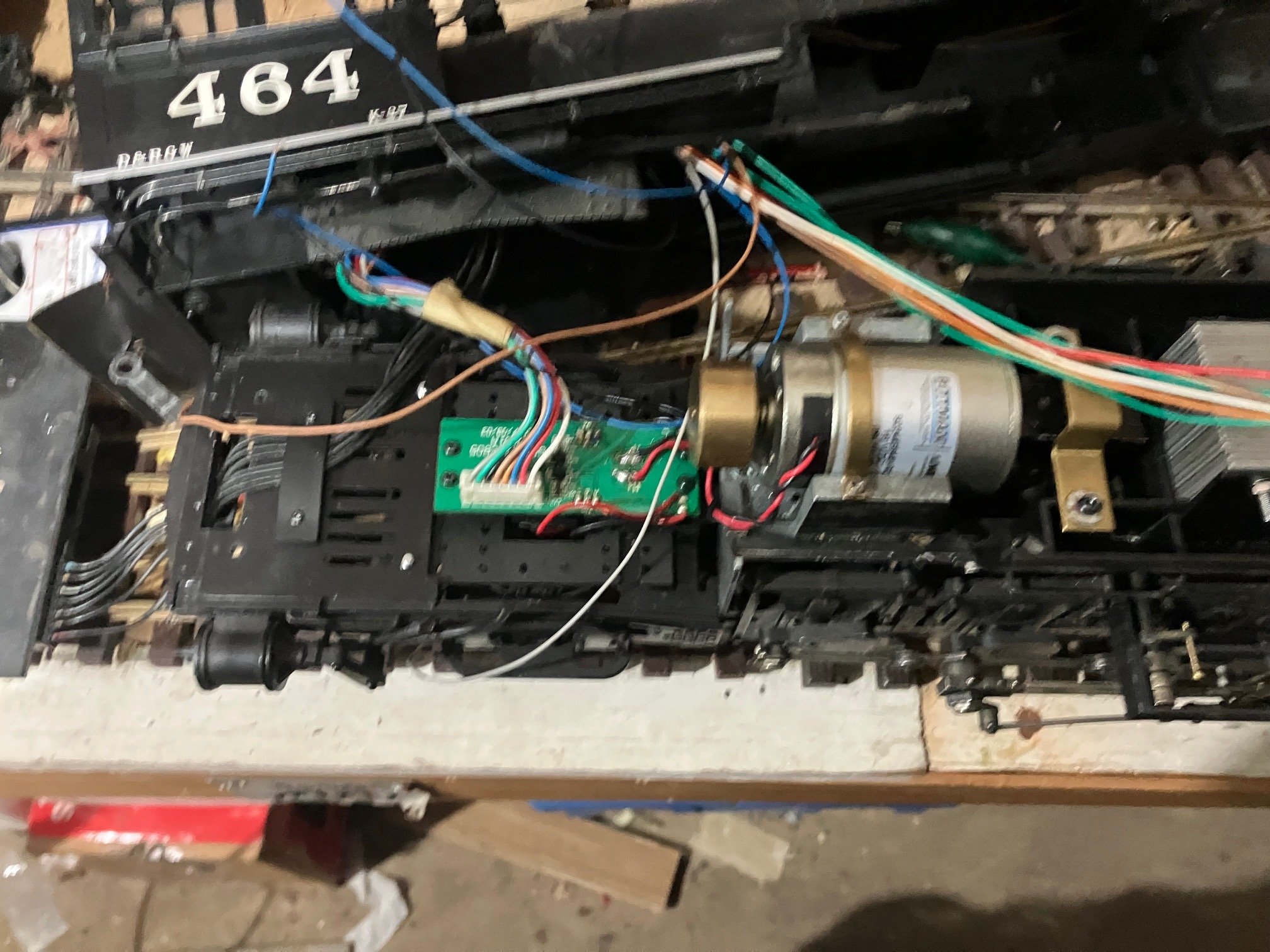

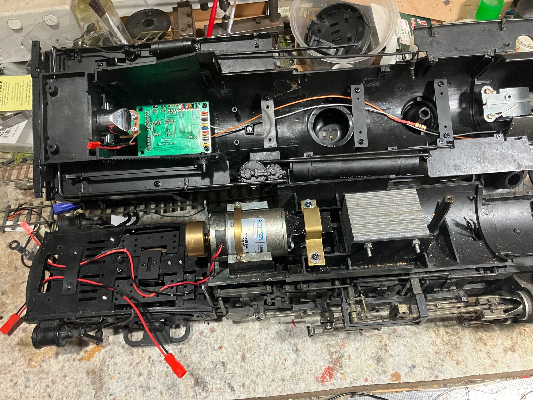

Mayner Posted December 26, 2025 Author Posted December 26, 2025 Back to the wreckbench to restore #464s headlight and get RGS Motor #6 head and marker lights when running in a forward direction. #464 headlight ceased to function after one of the jumper cables between the loco and tender failed several months ago. The wiring on the Bachmann K27 2-8-2 is quite complex with a circuit board in the tender and smoke box linked by a cable loom with two multiple connectors between loco and tender. The connections from the loom to the multi socket on the RHS of the loco wasn't in a great state when I picked up the loco well used second hand about 8 years ago, luckily most of the wiring was redundant since I converted the loco to on-board battery control ending up with one functional wire the -feed to the headlight which failed several months ago. The smokeboard circuit board control lighting functions, headlamp, marker, cab/possibly firebox lighting and redundant DC/DCC changeover and smoke unit switches. Original plan was to link the headlamp LED with the marker-light circuit but ended up blowing the marker light circuit instead!. In the end used a Kiwi style no 8 baler wire repair crude but effective. 1st did some testing with a multi meter and discovered that some of the loom and LED wiring did not follow the usual conventions for + - the negative lead to the headlamp was red and positive feed to the lighting circuit board white. To complicate things further I used orange and brown for + & - jumpers from the circuit board to the headlight. Actually managed to run some trains on Christmas Day. Thankfully #464s headlight fed through a resister now works, though I have not connected the marker (classification) lights. Apparrently marker lights were not usually illumiated in daylight. Motor #6 is fitted with very small filiment bulbs rather than LEDs, capture the atmosphere of 1930s 6v automobile headlights. Looks like the prototype may have kerosene marker lights, possibly from a caboose. The RGS was very much a boot strap operation that would make Forbes County Donegal extravagent in comparisson. Interestingly the entire RGS Goose (Motor) fleet has survived some in operating order on heritage lines and museums in Colorado & California, someone actually built a replica of the origonal goose Motor 1 which was used as a source of parts to build Motor 6 during the mid-1930s Getting #6 lights functioning going forward was basically a case of soldering a jumper between the F & R lighting pads on the radio receiver/decoder 8

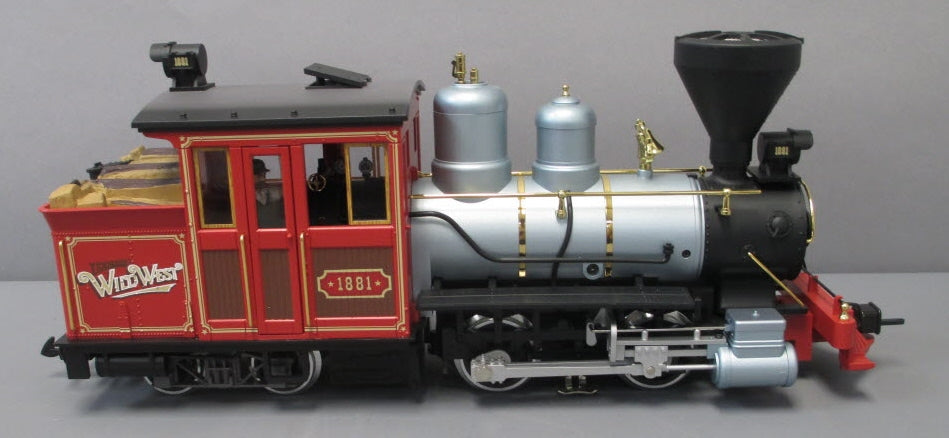

Mayner Posted January 5 Author Posted January 5 (edited) Back to the Wreckbench. Decided to dispose of a pair of my older Large Scale locos that haven't turned a wheel since I converted the garden railway from DCC track power to battery RC seven or eight years ago. Mainly to clear up space to start work on a 4mm layout. One of the locos an LGB Forney 0-4-4T turned out to be a bit of a challenge. Originally bought as an "1881 Wild West" loco from a US dealer, she was fitted with a NCE 4amp decoder and went through a partial repaint before entering service on the Jackson County about 16 years ago. Interestingly while the Forney type were rigid main frame locos with a trailing bogie, the LGB Forney is closer technically to a Single Fairlie with a centrally pivoted power bogie and powerful-sure footed despite their relatively small size. The Forney became one of the every day workhorses of the Jackson Country until replaced by (larger!) battery RC powered locos as I shifted from G (mainly 1:22.5) Scale to F (1.20.5) scale following a 2016 visit to the Colorado narrow gauge. The Forney type was mainly used on the Maine 2' narrow gauge and standard gauge elevated suburban lines, theoretically LGB narrow gauge models are meter gauge, though may have taken a pragmatic approach and simply "re-scaled" its Forney to match the proportions of its other American outline stock (mainly Colorado 3' gauge). "The fun and games" began when I attempted to enable analogue(DC) operation on the NCE decoder. The Forney did not respond to DC after I fitted the decoder and I had mislaid the LGB Analogue Jumper which would allow the loco to run without a decoder. I eventually managed to trackdown the decoder manual and a (2008) "My Large Scale" article on converting the Forney to DCC which I had originally used as a reference when I installed the decoder and included a diagram of the 'jumper' wiring. The NCE manual indicated that the decoder was supplied with analogue mode disabled and managed to enable analogue mode by re-programming CV29 using a Digitrax command station and throttle, referring the the NCE programming CV29 Information Sheet. Problem was the loco would only run reliably in a forward direction on DC, intermittently starting in reverse when selected, but changing to a forward direction when I closed and re-opened the throttle. In the end I re-programmed CV29 using a different command station and throttle with identical results! As a final check I attempted to check/re-programme CV29 interfacing the JMRI Decoder-Pro app with my DCC system, unfortunately the RR-Cirkits "LocoBuffer-USB" interface which I once successfully used for route setting on an American N gauge layout about 20 years ago is now obsolete. Fortunately I was able to cross check that I had used the correct CV29 value from Decoder Pro and the NCE tables. I sent in a query to the NCE help desk on the problem so will be interesting if I get a response. The next step was to set up an 'analogue jumper" with the aid of the wiring in the 'My Large Scale" article, but it did not actually work in practice as there was no link on one side between track, motor and functions. T In the end I simply installed jumper connections between the rails and motor bushes in order to allow the loco to run on DC, the lighting (head tail and interior) operates on FO, F2 may be used to operate a smoke units, F1 spare. At this stage all bulb holders require replacement, with a long lead time for replacement, so working lighting or DCc functions largely irrelevant. "DC" jumper! using parts from the local electronic store! My idea of DCC ready! 10 Pin header connected to the decoder tucked up under the leads to the motor bogie and smoke unit! 10 Pin DC header plugged into the board loco operating on DC without lights or other functions! Cab, bunker and pilot have been re-coated in a semi matt black aerosol sealed with a flat aerosol clear. Cylinder block has since had the same treatment. I originally had planned to finish the boiler and brasswork in black but decided to leave as is, at one stage green metallic "Russia Iron" boiler jackets and polished meytal work was a feature of many American locos. The Forney is a Chinese assembled LGB loco with plastic motion and handrail brackets rather metal on German manufactured locos. I replaced the plastic handrail knobs/brackets on this loco were easily damaged and were replaced with locally produced brass castings using one of the originals as a master. I need to replace the lamp numbers to match the smoke box number No 4 inspired by a Bridgetown and Harrison or Sandy River loco. The other loco in for attention is a Bachmann "Spectrum" Mogul again bought from a dealer in the States, fitted with a Lenz Decoder with stay alive a very reliable loco until she split a plastic gear on the driving axle (a common defect Bachmann Large Scale locos), gear and axle since replaced and a spare in stock and runs relaibly on DC! The whole DC/DCC thing could be a moot point track power is becoming the exception among large scale modellers in NZ as they convert to battery RC Hopefully with the large scale Farlie and Mogul largely out of the way I might get a chance to catch up on my 4mm Irish modelling projects. Edited January 5 by Mayner 4
Mol_PMB Posted January 5 Posted January 5 Very nice! Definitely sounds more like a Mason-Fairlie than a Forney.

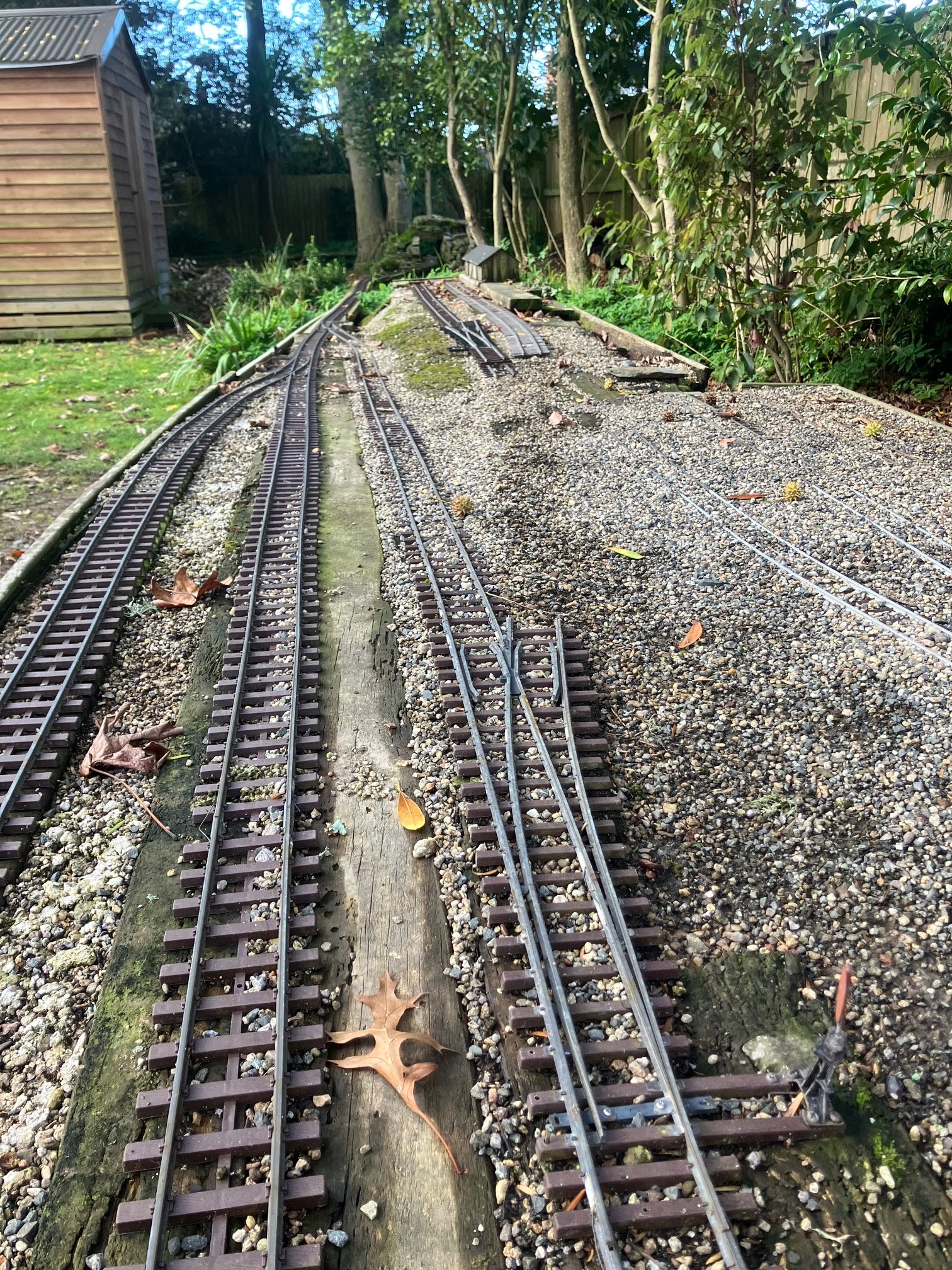

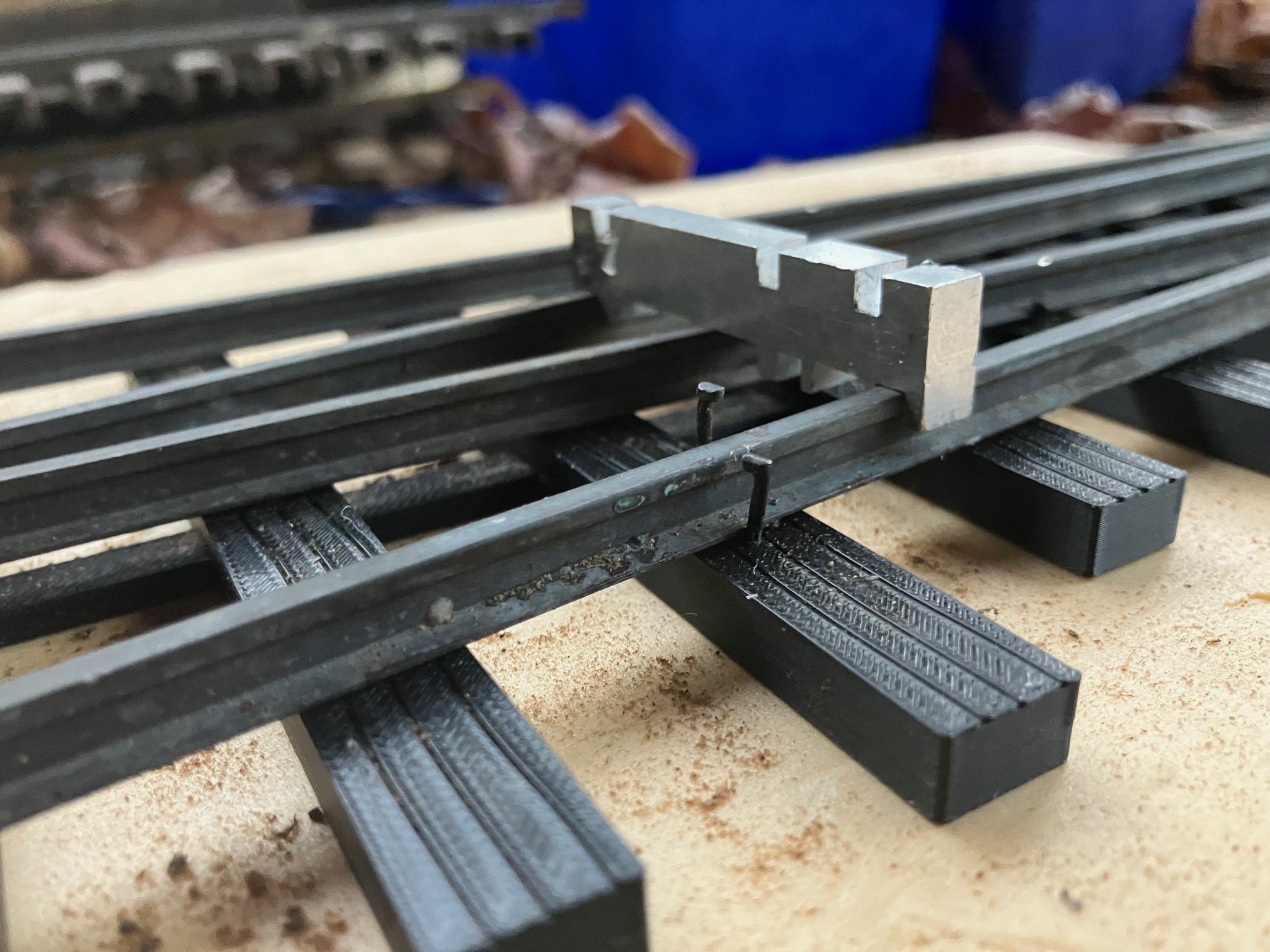

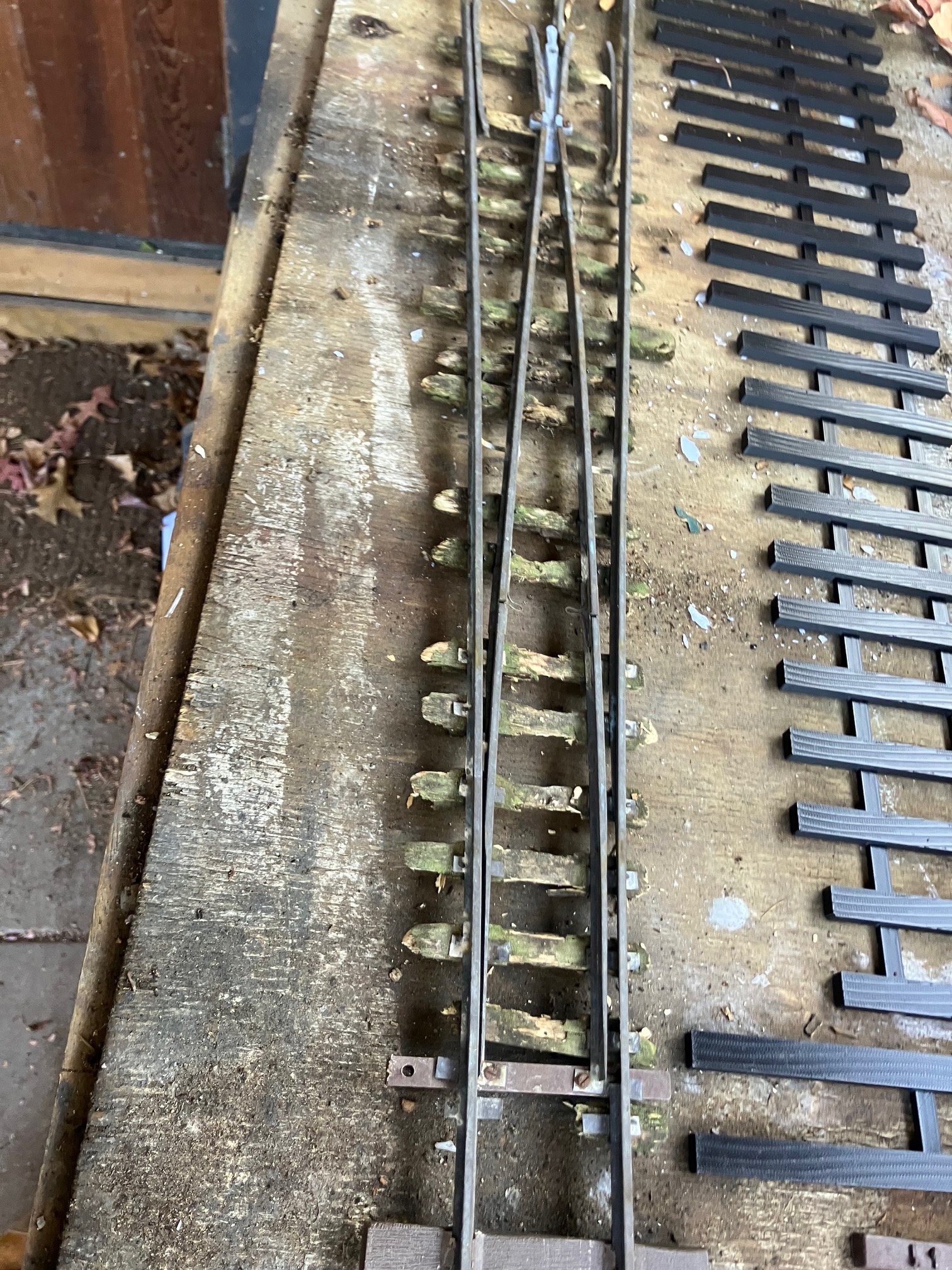

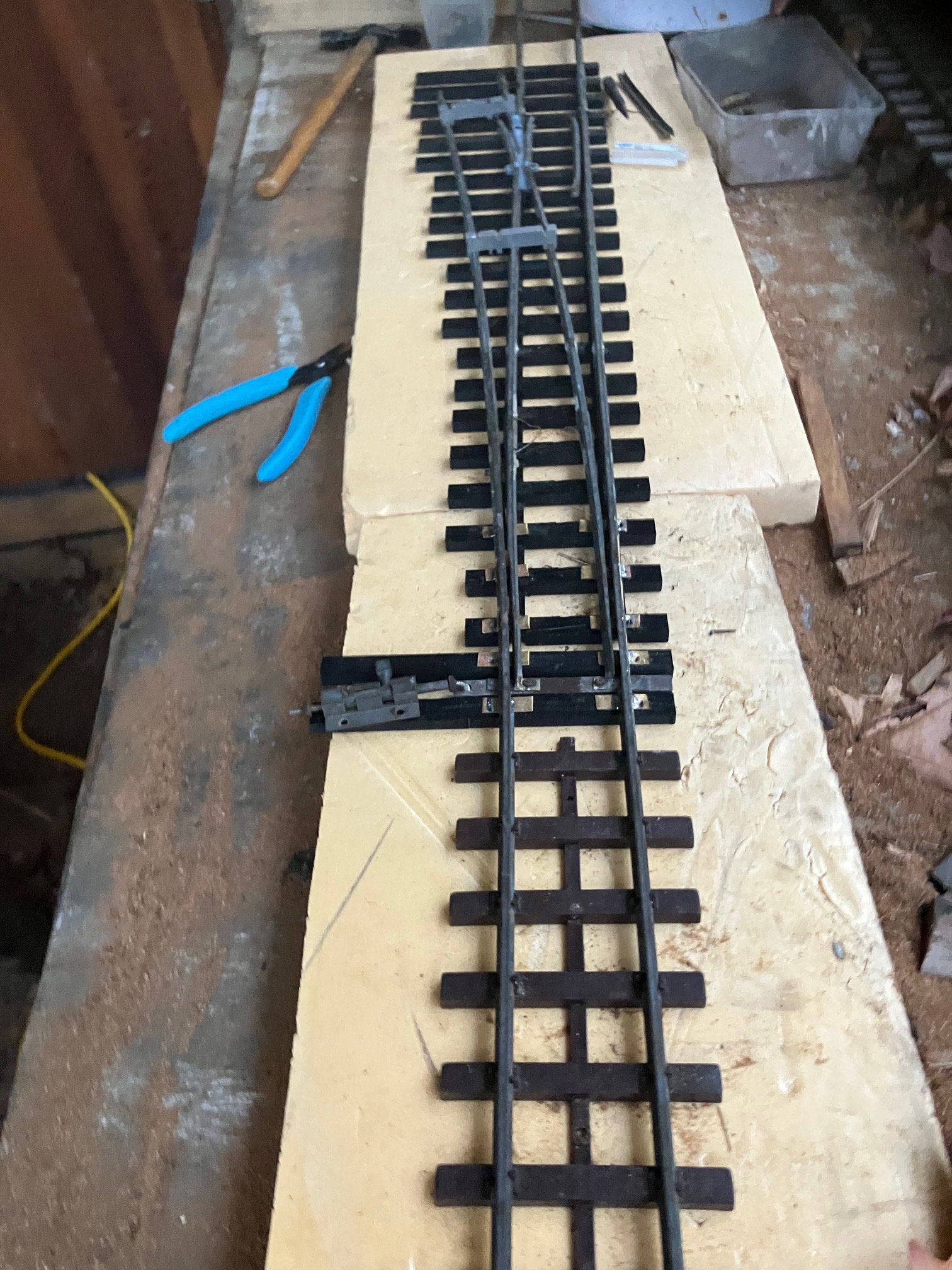

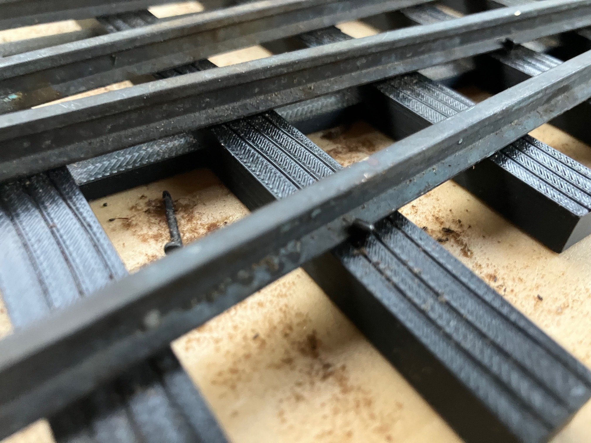

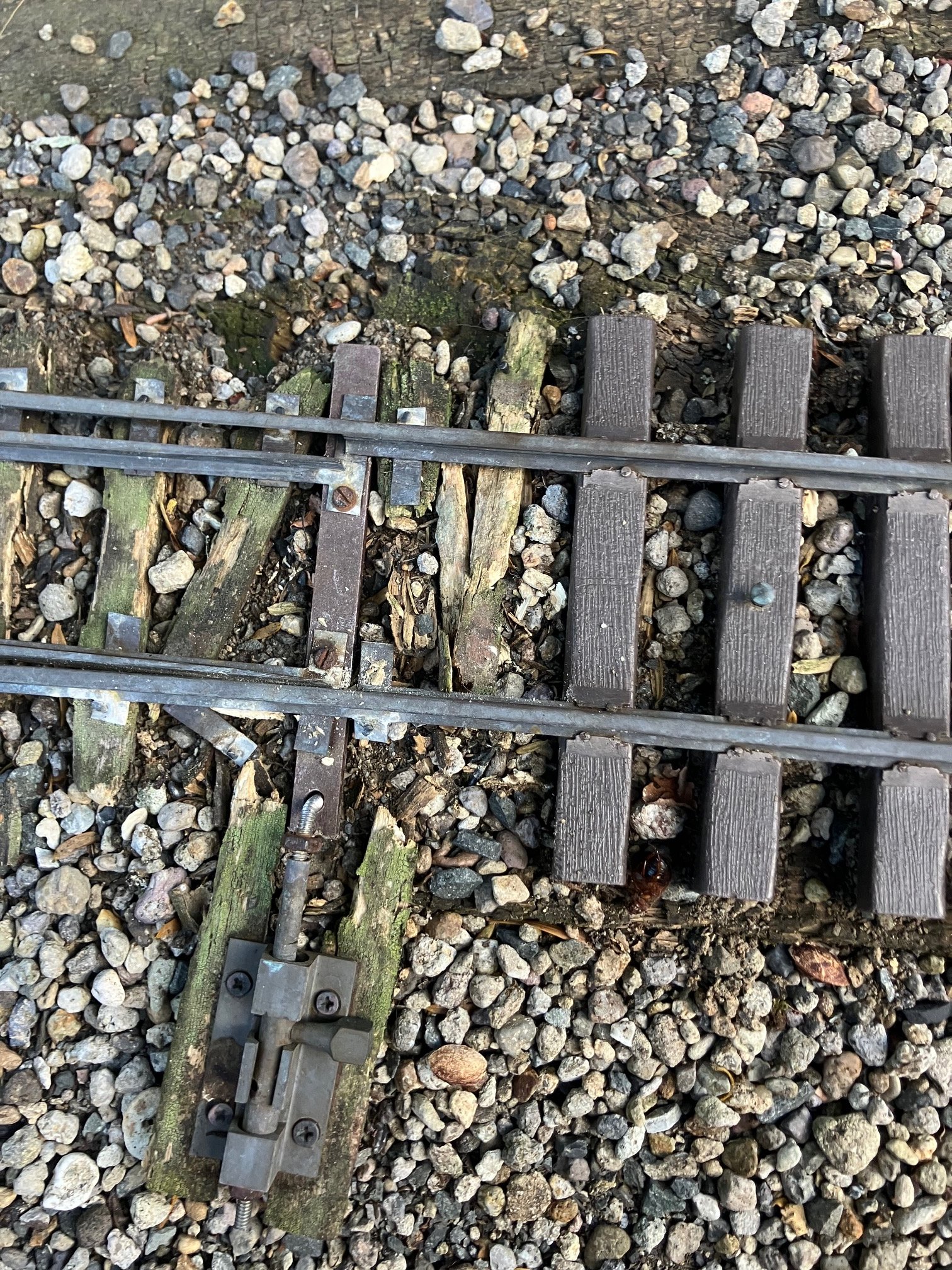

Mayner Posted May 31 Author Posted May 31 Catching up on some deferred maintenance replacing timbers/bearers on 1:6 switch/point Jackson City yard. I used AMS 3' Narrow Gauge (45mm) flexible track in combination with Sunset Valley switches/points when I started tracklaying on the Jackson County approx 18 years ago. I used Sunset Valley narrow gauge switches (approx G Scale) as at the time AMS did not produce narrow gauge swithces/points. I hand laid a number of switches using AMS rail on yellow cedar timbers/ties machined to match AMS ties to blend in better with AMS ties. I gradually ended up replacing most of the AMS & cedar ties with Sunset Valley as the plastic AMS ties began to break down as a result of UV exposure after about 12-15 years apart from some plaint treack and a single switch in Jackson City freight yard and some plain track on shaded areas of main-line which had shown little sign of UV deterioration. Anyway time to replace the timbers on the one remaining switch with cedar timbers after both 'headblock' that support the throw/locking bar to the switch broke off/failed during a recent operating session. Although Sunset Valley supply replacement ties/timbers as spare parts from the United States, I decided to trial FDM timbers 3D printed in the 'makerspace" at a local public library. Ended up using a PLA filament available at the library printers are unsuitable for printing in a UV resistant filament, but hopefully should last several years. Headblock timbers broke off severly decayed. Switch removed to outdoor work bench showing state of remaining timbers, 3 D printed timbers on right matching profile, length and spacing of Sunset Vally No6 switch. Just home from library Re-assembling switch with track gauges on curved/diverging road. Blue pliers is a special X-acto pliers for holding and inserting rail spikes. Spikes waiting to be driven home into 0.7mm holes drilled in timbers Jaws of pliers are milled to securely hold spike before driving home (hammer of pliers) Spike driven home, it was starting to get dark so had to stop for the evening for the second day 4

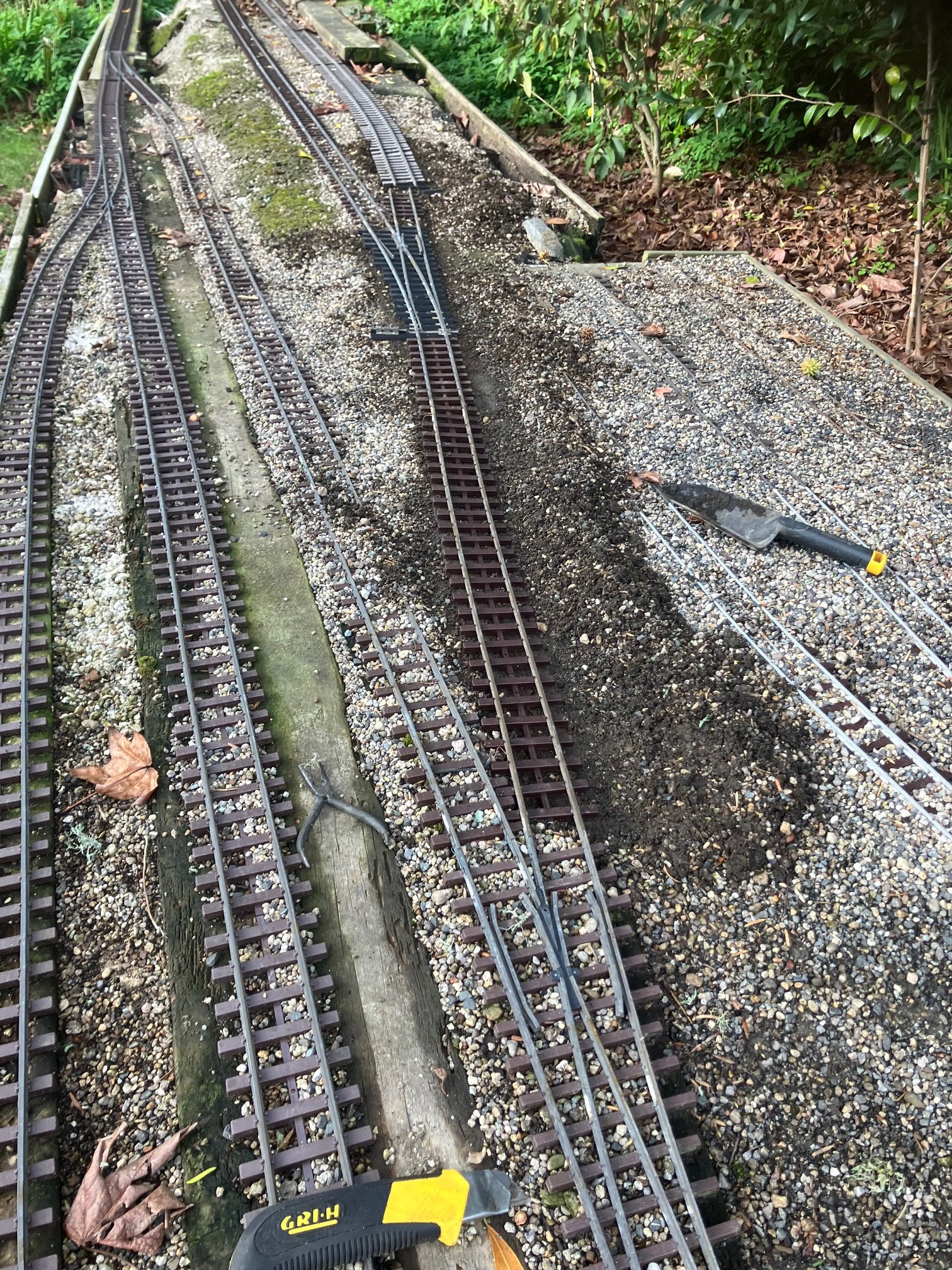

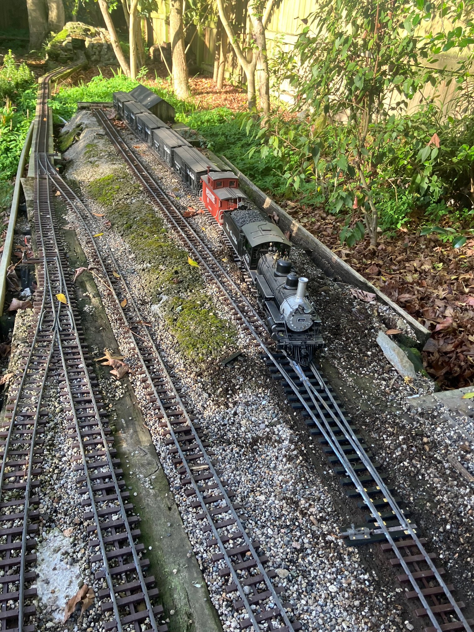

Mayner Posted June 7 Author Posted June 7 Refurbed turnout in distance, need to remove dirty ballast before reinstating connection to the two sidings. Kind of reminds me of some photos I took of the Holyhead Yard Dublin after it was disconnected in connection with the Spencers Docks redevelopment over 20 years ago. Work in progress, replaced ties/sleepers on panel between the siding/loop and refurbed turnout. Ties on Stockyard/Freight House (goods shed) road quite bleached out will need replacement soon! Its useful to have a train to test the newly refurbed trackwork even managed to successfully run a Stock Special Reminds me of listening in (on a scanner) to conversation between a train crew and track gang during relaying work in the States about 10 years ago. A Canadian Pacific track gang had just completed refurbing a diamond crossing between CP and BNSF lines in Minessota. Asked a crew of a Shortline train about to diverge from the CP to the BNSF if they could continue on the CP line and run their train 9-10 time over the crossing to check that everything was ok, next CP train was not scheduled for several hours and track gang wanted to pack up and go home. Shortline crew were on a tight scheduled and also wanted to go home and declined the request. 2

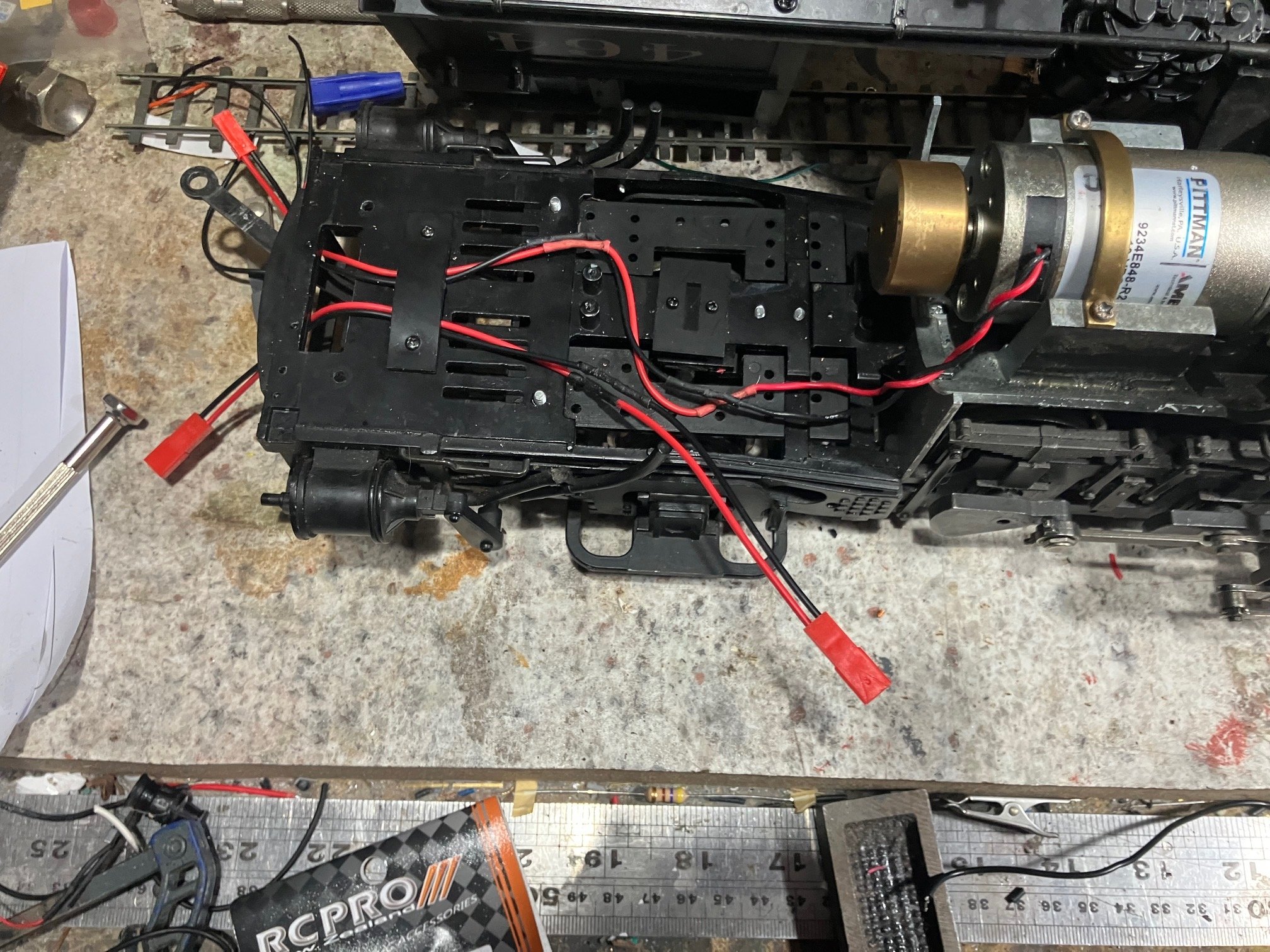

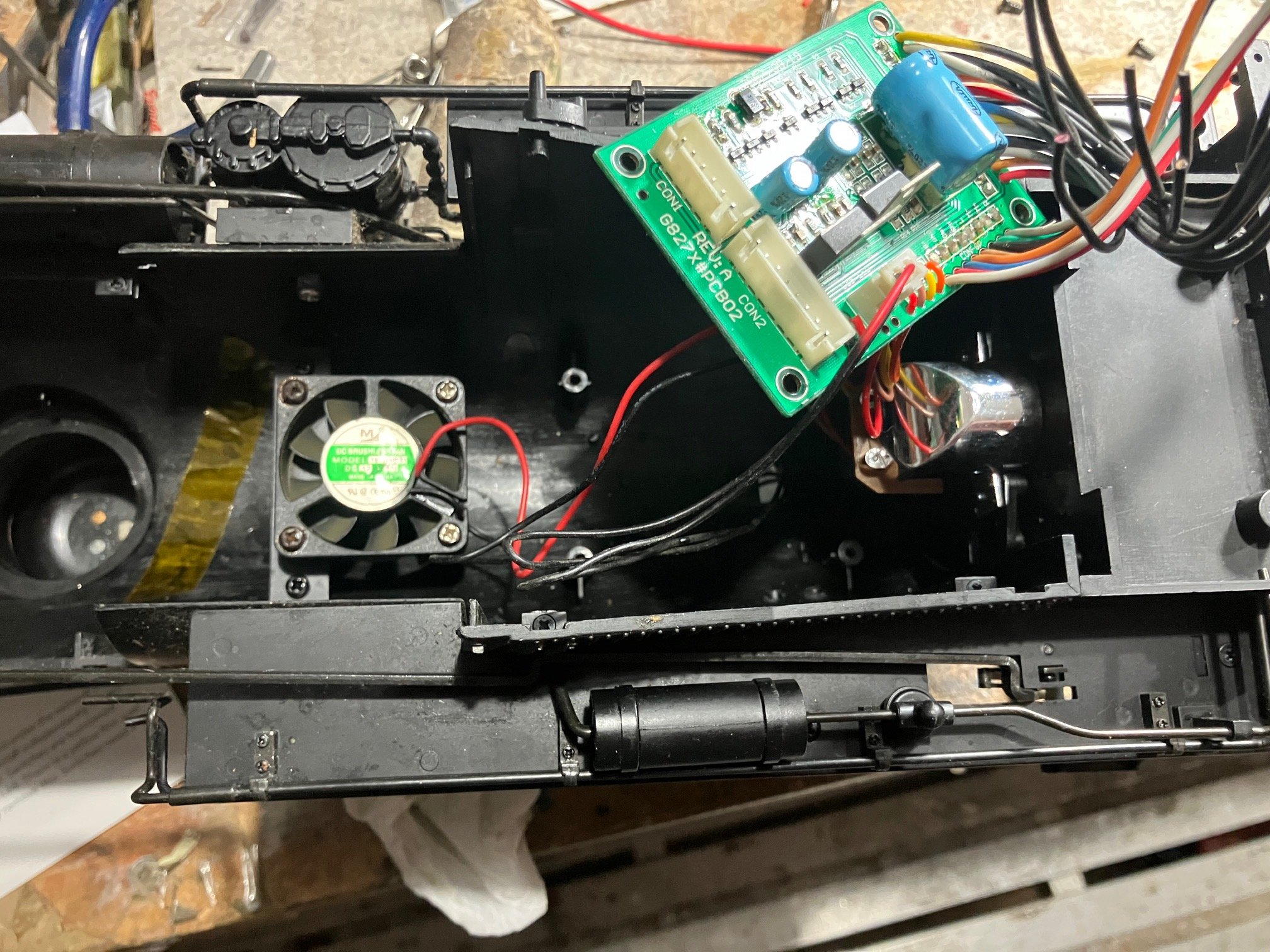

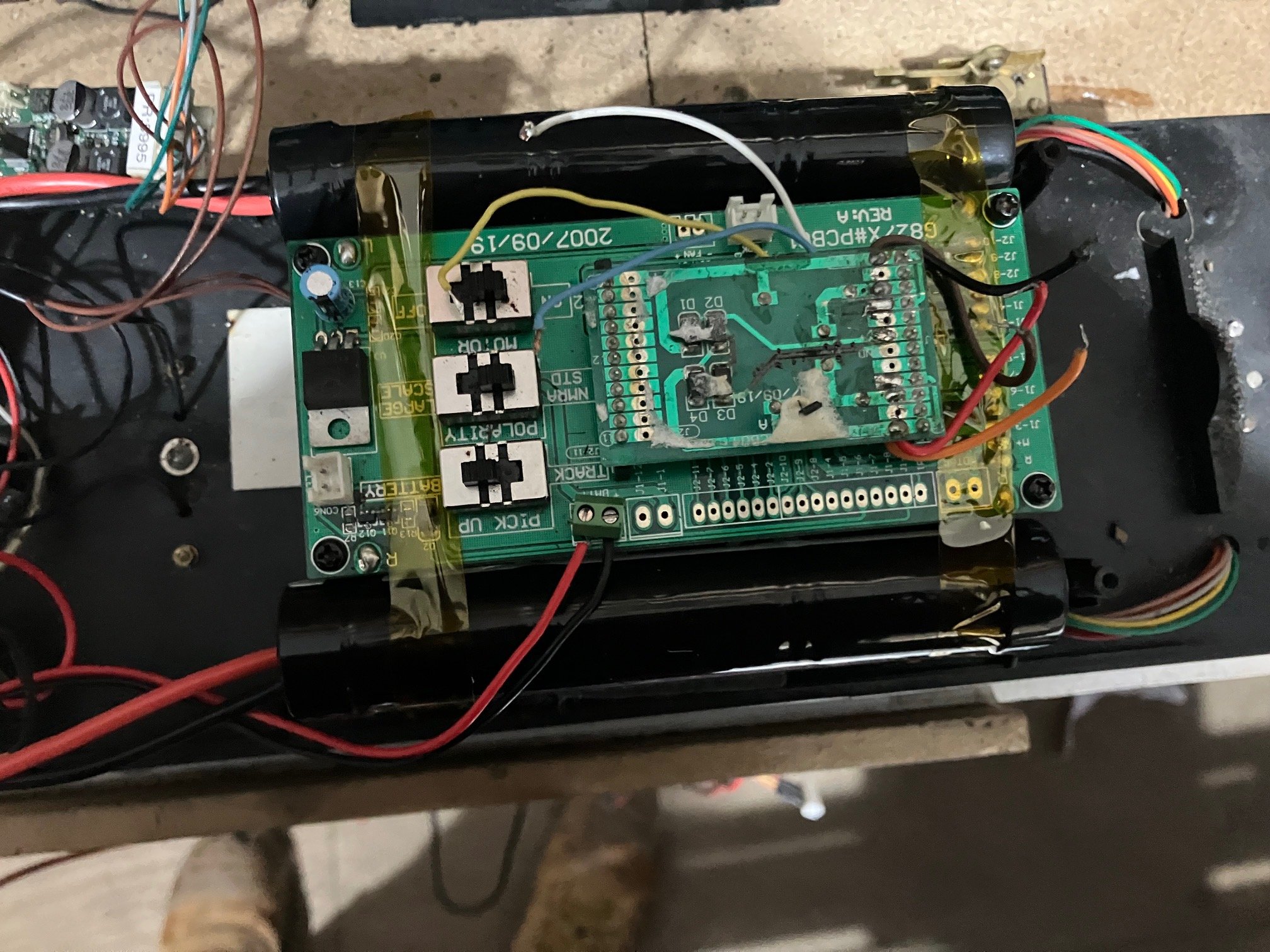

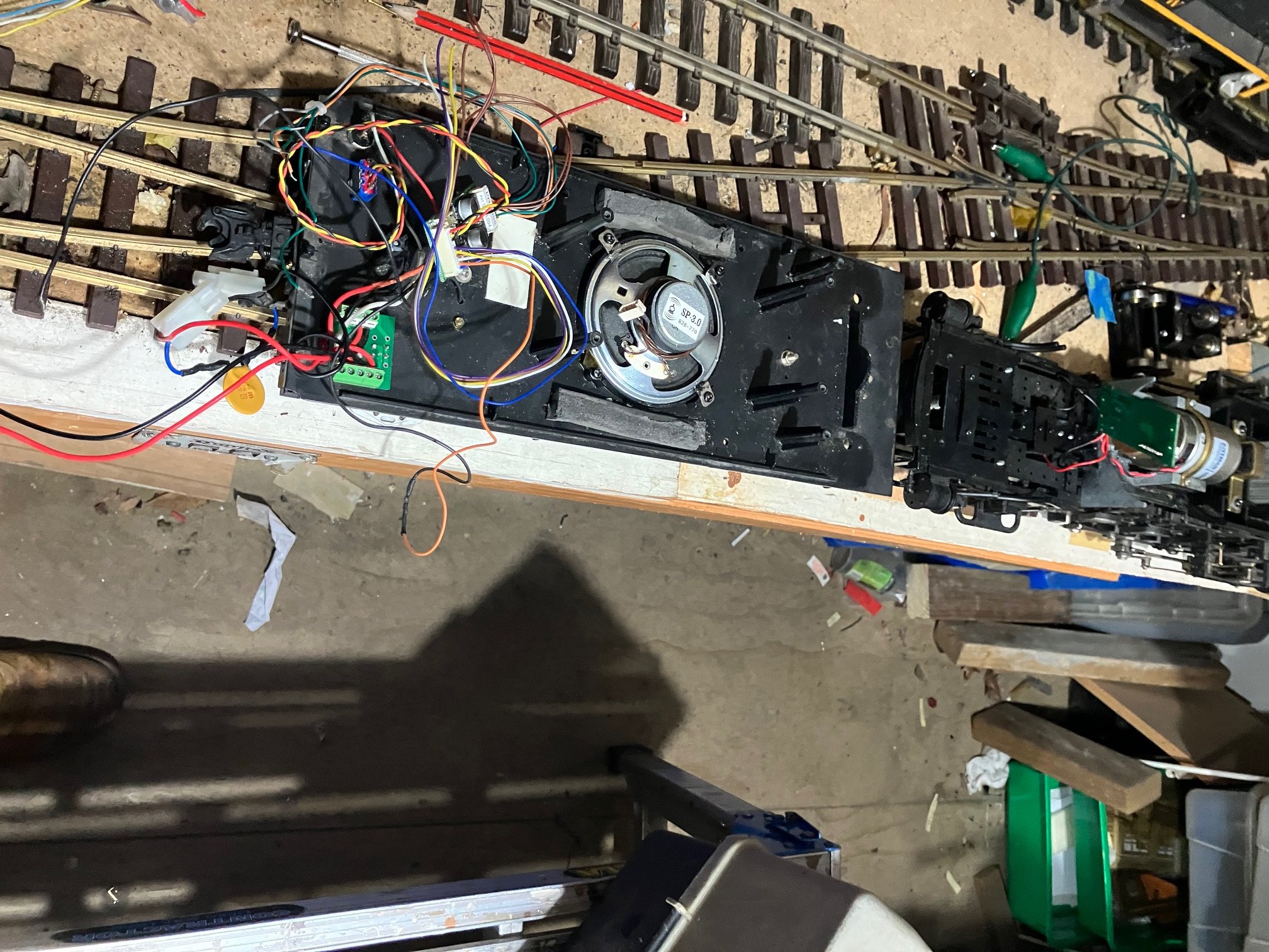

Mayner Posted August 17 Author Posted August 17 K27 #464 once again in the workshop, this time to re-place (and simplify) the wiring system after the origonal failed. The wiring system in the Large Scale Bachmann K27 was a little overcomplicated. The main circuit board located in the tender, linked to the loco bay a cable loom with 2 multi way connectors and selector switches in the smokebox controlling smoke and lighting functions! (cable loom right of photo). I simplified the wiring by removing one of the connectors (power pick ups and chuff -timer) following conversion to on-board battery power & fitting chuff-timer to a tender axle! I decided to replace the wiring/loco tender connection after the - negative connection on the lighting circuit failed and the loco did did not appear to be holding a charge for prolongued running despite recently replacing the batteries.. Circuit board in firebox & motor cooling fan. Main circuit board in tender loco is almost 20 years old! In the absence of an agreed "Large/G Scale DCC interface Bachmann developed their own hybrid! Track or Battery power was selected by a slide switch with screw connectors for battery power, with a separate plug-in circuit/baseboard for DCC decoders or RC control boards with hard wiring (ugg!) Loco and tender stripped down to the basics Bachmann wiring and circuit boards removed. Wiring on left connected with battery and Phoenix sound board. Putting it back together! I use these 2pin in-line connectors as standard between loco & tender on my large scale locos. Two wires from tender/power controller to loco and two for lighting. I am using a second connector on the lighting circuit so I can separate loco body and chassis. Found a use for a redundant Bachmann circuit board, should prevent lighting circuit getting tangled up in flywheel. Smoke unit adds some weight to the front end! Managed eventually to get classification lamps and headlight working by salvaging LEDs from a spare smokebox. Everything worked perfectly while testing lighting at each stage of the installation, but nothing happened when I replaced the loco body and re-connected the tender, discovered a day later that I had managed to cross wires on the engine-tender connector! Loco is almost ready for re-assembly, a section of running board/air receiver had broke free on one side of the loco and need to fit cable clips to some of the loose wiring in the tender. Poor performance of loco/ possible power drain may have been due to loose adhesive tape inside loco rubbing/binding on flywheel. Original wiring on lighting circuits partially bound with adhesive tape. 2
Colonel Posted August 22 Posted August 22 There must be entire layouts with less wiring than this loco! 1
