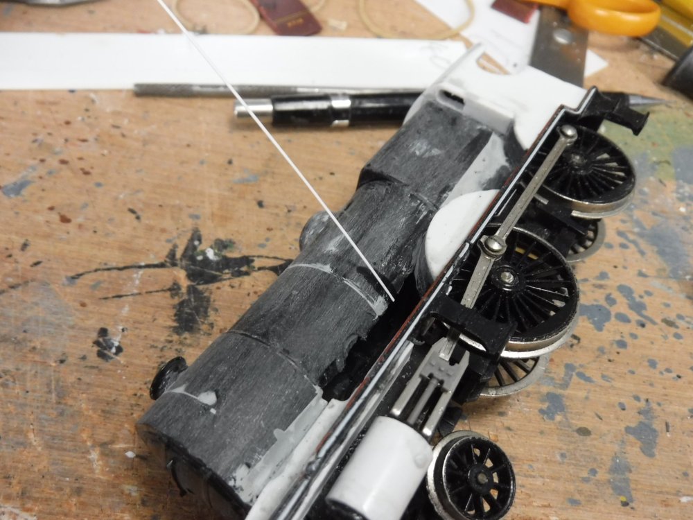

Hi Folks,

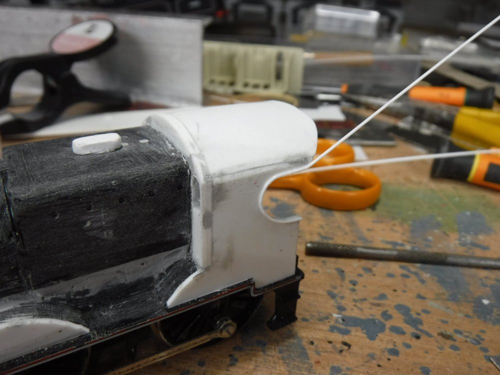

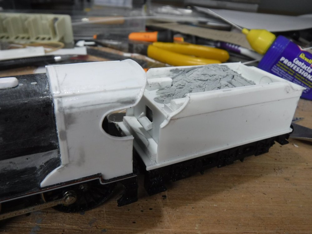

the latest is that I have fitted a boiler band to the barrel of the boiler, beading to the cab and tender and a couple of rain strips to the cab roof.
The boiler band was the easy job as all that is required is to fix one end of some .010" x >020" squarely across the model, pull it tight around the boiler and brush some Humbrol liquid poly onto it.
A slight more fiddly work with the beadings as I used .020" X .020" square rod which was pre-shaped with tweezers and my thumb nail to match the profiles that is was to follow along the edges of the cab and tender sides.
The strip had been curved to shape and glued in place so far and the next bit once cured was to tweak the shape around the cab roof in stages, I work a curve and onto a straight and then wait to cure before again working a curve and along the next straight. The reason is that the straight bit is easy to hold in place and the curve may be manipulated with tweezers if it not quite right and also the straight bit holds the curve in place once the glue starts to cure. There is a tacky stage when things may be gently pushed into place.
The cab roof complete with rain strips, the curves at the front of tender are separate pieces as there is a step between the sides and the raves at the top. The curves were fitted first and the straight bits along the tops and across the back were fitted secondarily as it is easier to sight a straight bit into a corner where it meets a curve.
Gibbo.

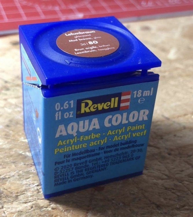

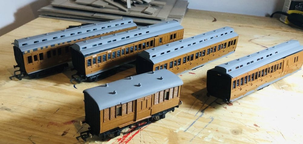

Regarding suitable paints to represent GNR colours, I have used the following:
GNR carriage mahogany: Revell Aqua Colour Mud Brown Gloss
GNRMahogany02.thumb.jpg.9b098c5164619574e50fe3cc9fc8dbb7.jpgGNRMahogany01.thumb.jpg.3f701f771aa067a5d8249466c978cd29.jpg
This produces this effect:
I should probably add a wash of black to these at some point before adding GNR coat of arms decals.

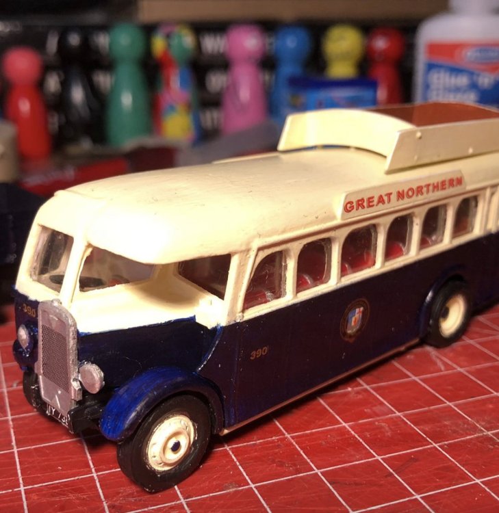

Then for the GNR bus/railcar/carriage blue & cream:
Cream: Anita's All-Purpose Acrylic 1106 Antique White (it's definitely cream though!)
Blue: System 3 Acrylic 134 Prussian Blue Hue
I used these two on my GNR buses:
Hope that helps!
Hope that helps!
Cheers Patrick,
Top man for the suggestions of colour shades for GNR liveries, I shall look into those. I'm rather amused to think that I'm going to have some mud brown coloured coaches tough.
Edit: I've just been looking up some colours and Humbrol 9 is listed as equivalent to Revell 80 which is interesting as I have some of that from when I painted some coaches for Thomas the Tank Engine.
Gibbo.

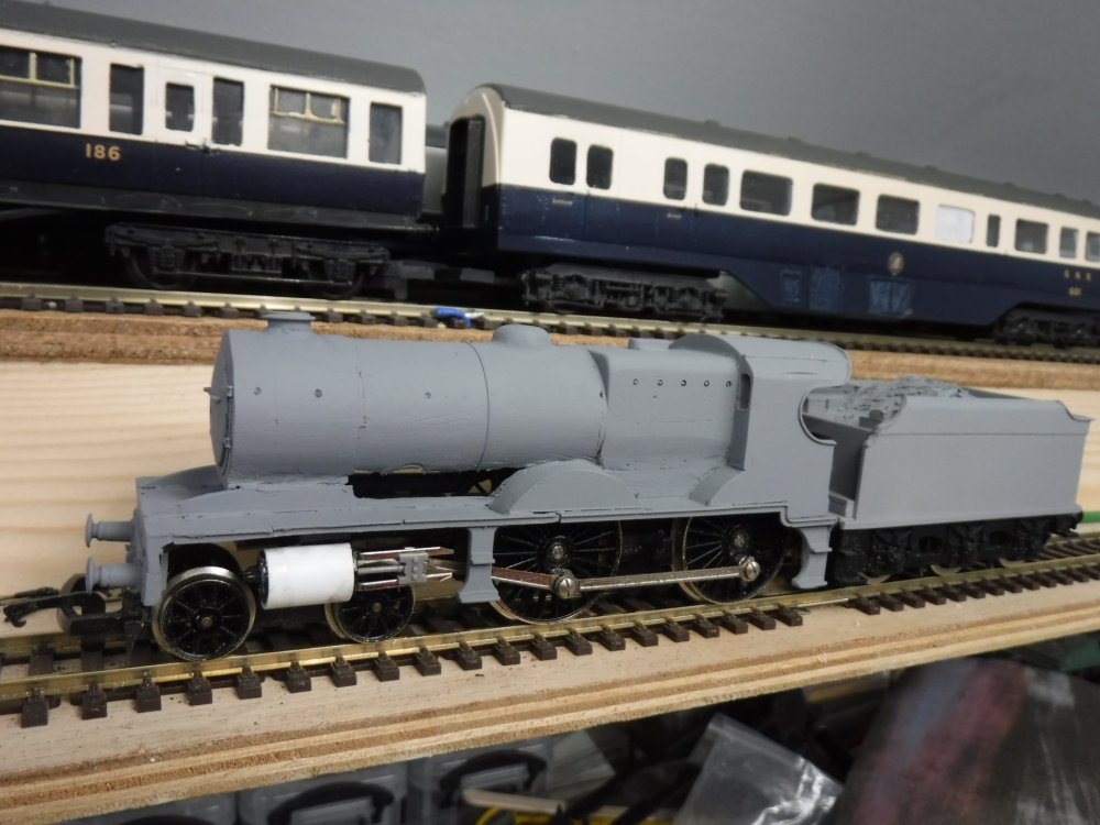

Hi Chaps,
The V Class is now in works grey ready for top coat for which I shall use Humbrol number 48 on the recommendation of @murrayec, he also advised Humbrol 109 and Ford Wedgewood Blue for the locomotive in preserved livery as did @Galteemore, thanks to both of them for that. I shall use Humbrol 48 as I didn't think a whole can of spray paint for just one locomotive was justified on a cost basis.
As may be seen there are some minor areas that the primer have picked up for remedial filling and sanding before final coat is to be applied.
I'm meeting up with Thomas who will get this locomotive as a present and so it might be the last wee see of it however, I would prefer to take it back to finish paint it for him and send it on by post another time.
Gibbo.

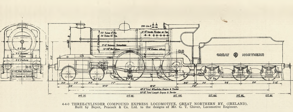

Hi folks,
Here is the best drawing I have of the V class:
Gibbo.

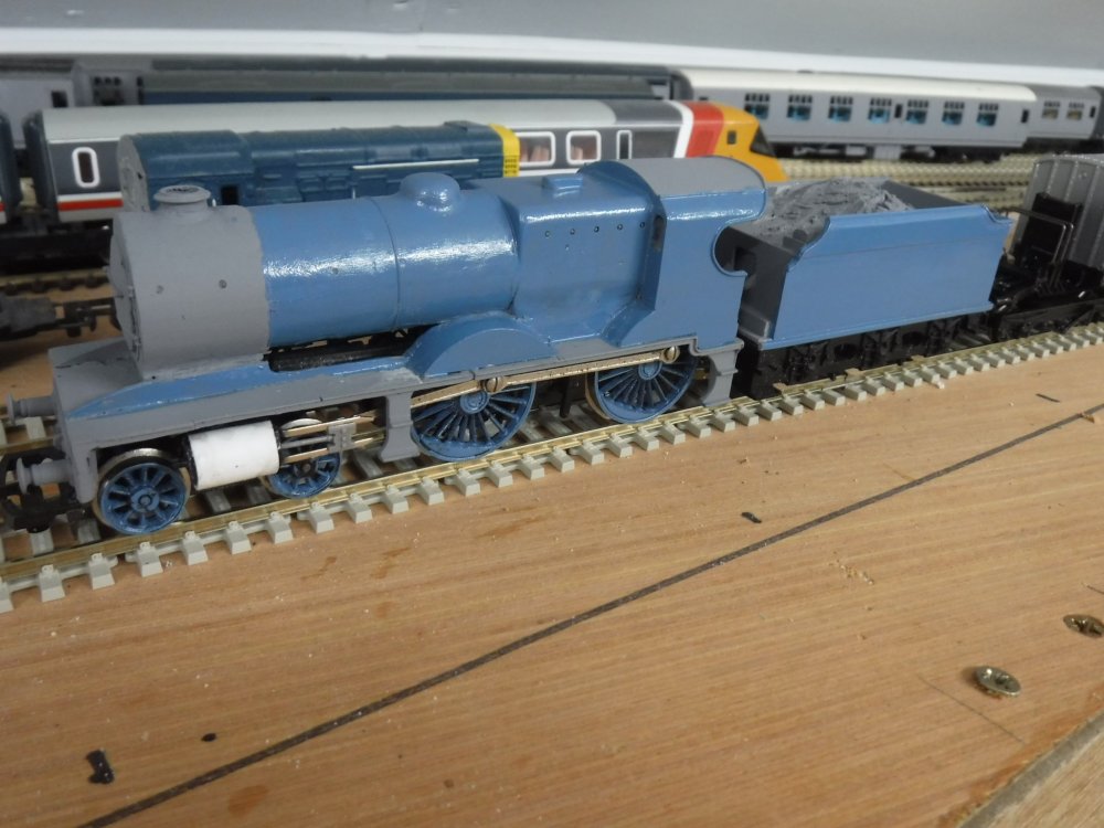

Hi Folks,
I have at last got some paint for the V class, I have Humbrol 48 as suggested by various folks on this thread.
First coat blue.
First coat red.
Gibbo.

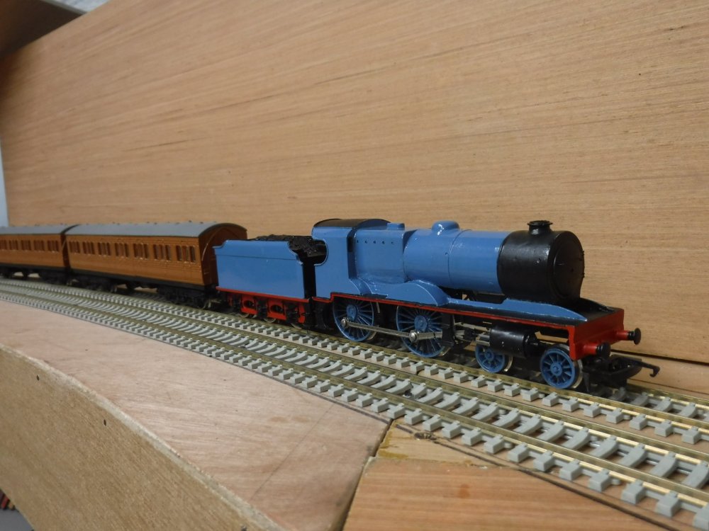

Hi Folks,
A little more red paint and some black paint.
Here is No. 85 as yet un-numbered and unlined, coupled to Annie and Clarabel for the GNR coaches have been sent on to my friend in Sligo. I shall have to see what transfers are available that are to suit the GNR Light Blue. any suggestions are welcome.
Annie and Clarabel are made up from cut and shut Hornby four wheeled coaches, mounted on Mk1 bogies and painted up in Humbrol No.9, they even have faces painted on one end.
Gibbo.
  • Like 9
42 minutes ago, Patrick Davey said:
Coming along well - Annie & Clarabel wouldn't look out of place in Clones or Dungannon.
HI Patrick,
Here are some photographs of Annie and Clarabel so that you may see how they look more closely. It may be that the Hornby four wheelers could be a good basis for cut and shut coaches.
I used Hornby Mk1 bogies however it would be equally easy to use different bogies. The underframes are cut down Hornby Mk1 underframes that were cut down to suit, again it would be easy enough to scratch build and underframe with either laminated plasticard or 3mm Plastruct "I" section. the underframes could then be used for goods wagon projects.
The only thing that would be tricky would be to make a different size compartment for first class.
Painted faces of the two.
Annie, non corridor third.
Clarabel, non corridor brake third.
Gibbo.
  • Like 5
