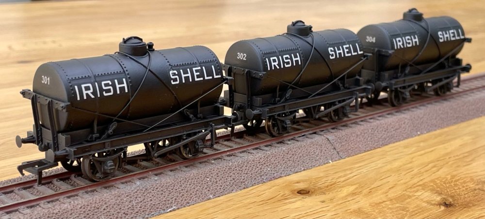

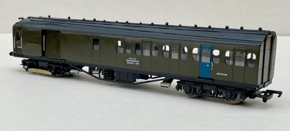

Darius43 Posted July 20, 2024 Posted July 20, 2024 I’ve printed white decals with a coloured surround using a laser printer and white decal sheet. These “Irish Shell” tank wagon decals were printed using a black surround, which is pretty easily to blend in on a black painted model. With white decal paper there is a visible white line where you cut the decal. This shows up on the model once the decal is in place and needs to be painted over to hide it. With other model base colours, blending the decal surround is harder as an exact colour match isn’t easy. For the MTK 2-HAL model below I printed the decal in varying lighter and darker shades of the olive drab finish and selected the decal that best matched the model colour once printed. As with the black surround decal the edges of the decal need to be painted over to hide the white line. Cheers Darius 1 1 2
murphaph Posted July 20, 2024 Posted July 20, 2024 Nice work Darius. Looks very well on the black especially. 1 1
