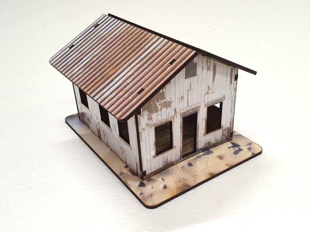

I'm not a train modeller per se, however, after watching more than 3 or 4 video's showing how to build layouts, with many hours being 'lost', I thought I'd try a technique that I'd seen a while ago, to construct a building using printed laminated sheets and a laser machine.
The model railway video's that I've seen have featured layout builders using card and and thin MDF that have been covered/wrapped in printed textures (brick, stone, wood). The skill and patience required is quite surprising, I thought the process would be simpler ... I suppose that it can be depending on the level of detail you want to achieve. Some of the detail is quite extraordinary.

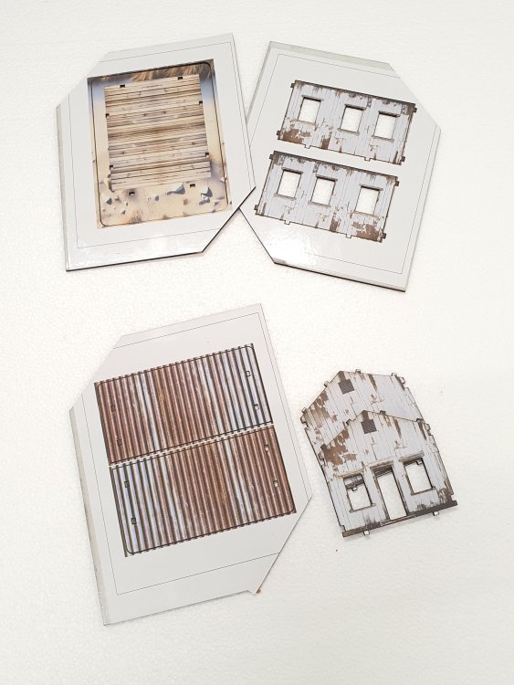

The idea I wanted to try came from this link. Basically the outline of a building is laid out over pictures of building materials, the sheets are printed out (on a normal printer) and laminated. The sheets are attached to a backing, in my case 3mm MDF, using double sided tape and them cut out and assembled.
Yes, a laser cut the MDF but if laminated card was used, it could have been cut with a knife. A disadvantage with this technique is that the 'cut' edges are visible, a knife cut edge could be coloured, a laser cut edge might not be that simple? An advantage if that the model wouldn't need varnishingĀ assuming the 'laminate stands the test of time? For my use the laminated sheet will work just fine. Time to experiment a little more...

The result looks good but the laser cut edges and corner interfaces do stick out. Ā Furthermore, the corrugated roof sheeting looks ok from some angles, but being flat and smooth, will not look quite so good from other angles - especially with larger roof areas.

Be careful of using double sided tape- with some brands or most the glue drys out over time with the lamination coming free. PVA or paper glues would be a far better deal.
The edges can be covered with printed corner trims to walls and openings, with fascia & barge trims to the roofs
I agree with Darius43 about 'flat' corrugated roofs.
Agreed, the edges do stick like a sore thumb compared to the level of finish I see on here and the scale and texture of the roof is not great. It's a starting point though.

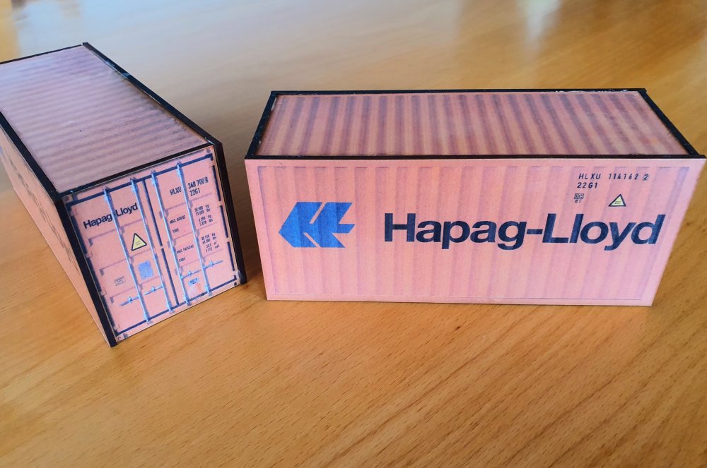

Here's a second attempt using this lamination technique, this time using pva to secure the print mdf before cutting, using hi-res image is a must as the print quality isn't great.Ā
I think you need to study how other manufacturers design their kits using laser cut and etched parts. Ā They usually deploy a range of materials of varying thicknesses. Ā For example, the 2mm thick mdf is often used to form the core of the building, which is then covered with etched thinner card overlays that provide the surface texture and cover the edges/corners of the thicker mdf core. Ā Thinner card is often used for the roof as it won’t present an unrealistic thick edge - unlike the mdf.
Your container would look ok tucked into the background of a layout but the lack of 3D depth to the corrugated sides and ends plus the exposed edges of the mdf ā€œdestroy the illusionā€ I am afraid to say.
In a way your concept reminds me of the Hornby railway building ā€œkitsā€ of the late ā€˜70s and early ā€˜80s with their smooth printed sides. Ā They were ok for the time but, to me, would not pass muster today.

The laser cut edges are the biggest drawback on the items that I've done, it might be possible to mask/disguise them if it was a building... there's no hope on a container.Ā
