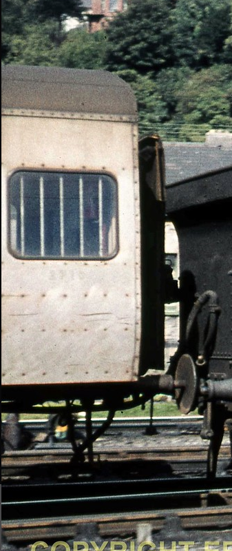

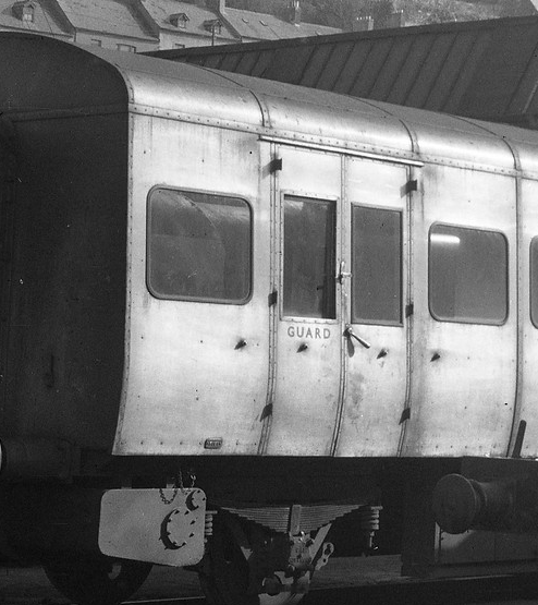

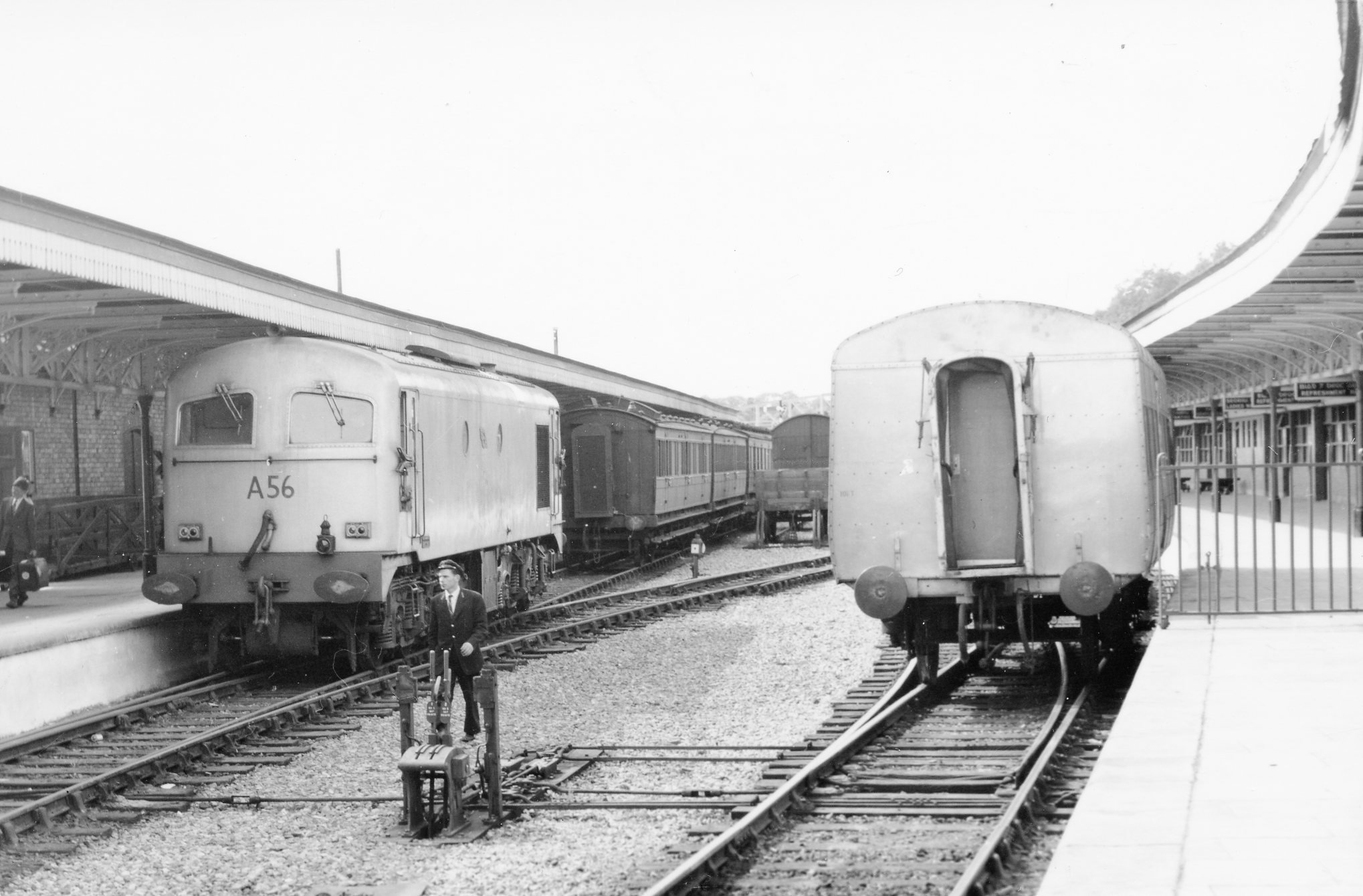

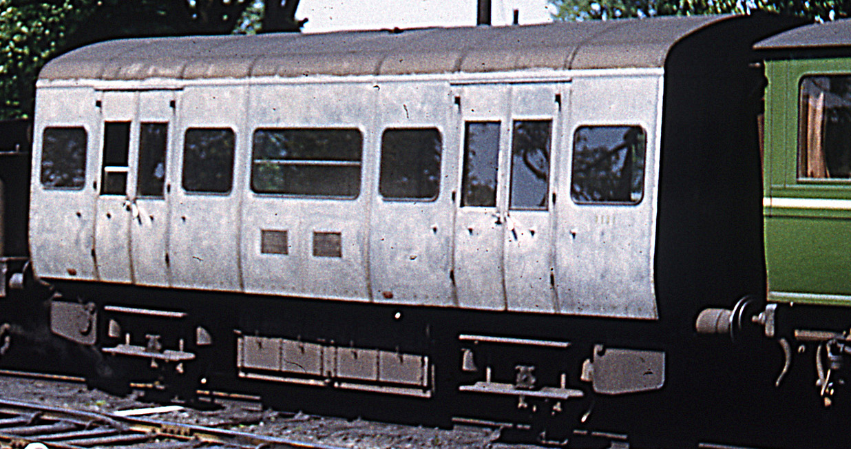

0 Mol_PMB Posted September 2 Posted September 2 Those nicely show examples of both types of buffers used on the tin vans - and that they were black. I'll add a couple of cleanish views from my folder of tin van images; many of these are crops from Ernie's images on Flickr but the first one is in my collection. This is a zoom in on one of Ernie's photos showing the EdN number: Although this is a bit grubby, it shows that the heating vans also had EdN numbers, and the small red plates on the lower bodyside. On the heating vans, the GUARD lettering was on a door at one end only (here the left-hand end) which is the door with a droplight. On the other side it would be the inner door at the right-hand end. And a heavily cropped Ernie shot also showing the lettering and the red plates, albeit in monochrome: Again a couple of zoom ins on Ernie's photos showing the red lettering NOT TO BE ROUGH SHUNTED on the ends of the heating vans only: Hope this helps... 4
