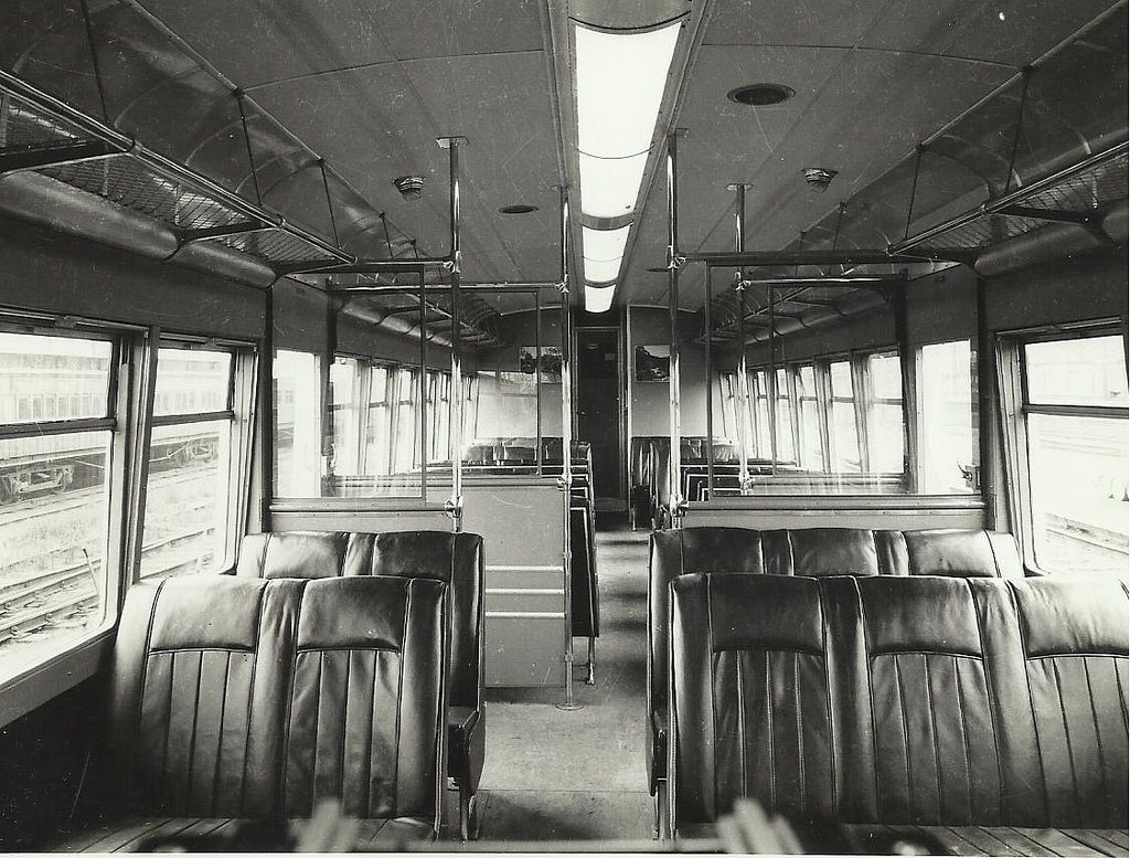

This is the Aussie Walker interior, somehow doubt leather would ever be used here! There seems to be a two-tone paint job as well.
Inside a 280hp "Walker" railcar in Victoria. Victorian Railways photo.

Have attached a photo of the picture in Backtrack showing the B's interior. Can't help thinking the main panelling & window surrounds look like dark wood [or same green as lower exterior], but photo is not dated, so no telling whether this was the case during its working life on the Sligo. Have been having a closer look with a magnifier at the colour pictures and still think the seats are either dark green or perhaps blue, while the inside of the driving cabs certainly appear brown. Oh for a time machine!
