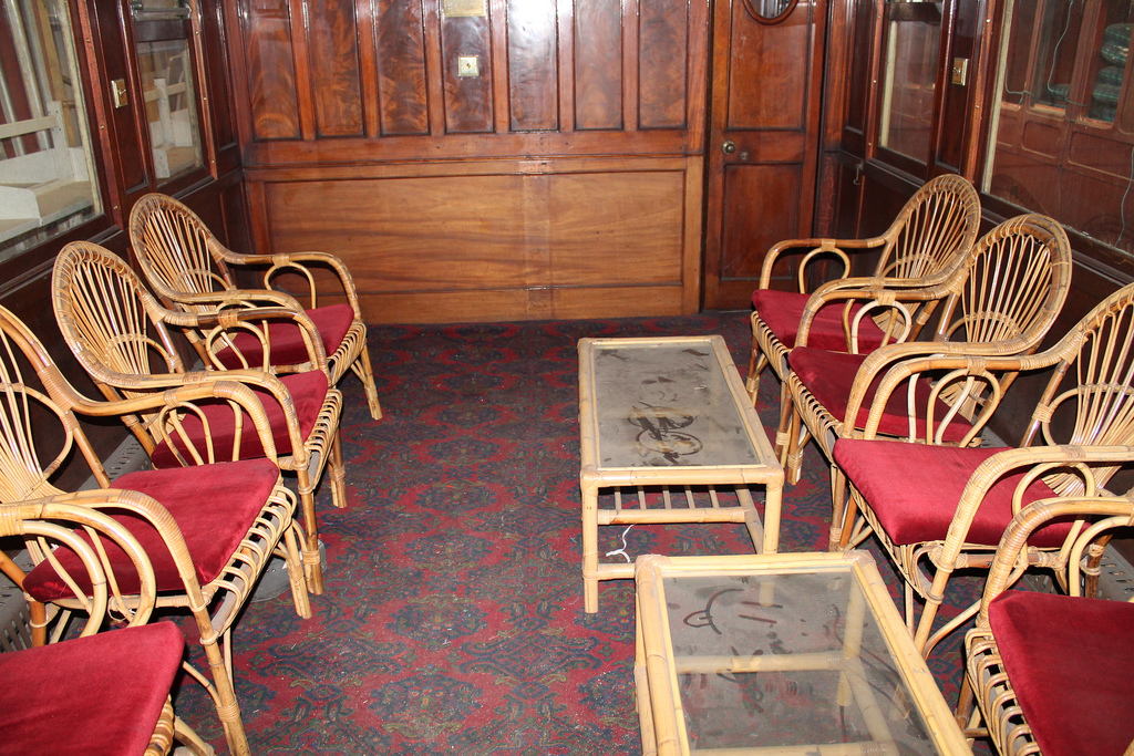

Thanks Lough Erne. Valuable information there. Are there any photos of the interior of the Director's Saloon floating around on the net? Proof in the photo and all that.
