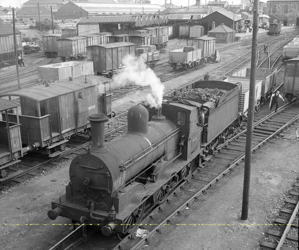

20 Ton Brake Van. Some panels were sheeted over in metal, some not, some had original duckets, some had the newer profile.
Cattle Wagons
Newer Profile above, Older Profile below.
MGW Dublin North Wall 184poss early 1950 s
The earlier standard CIE brake vans had vertical planking. Later ones sheet steel, though many earlier ones were rebuilt - or just PART rebuilt - in steel. When this happened, superstructure of body tended to be steel with balconies remaining wooden.
