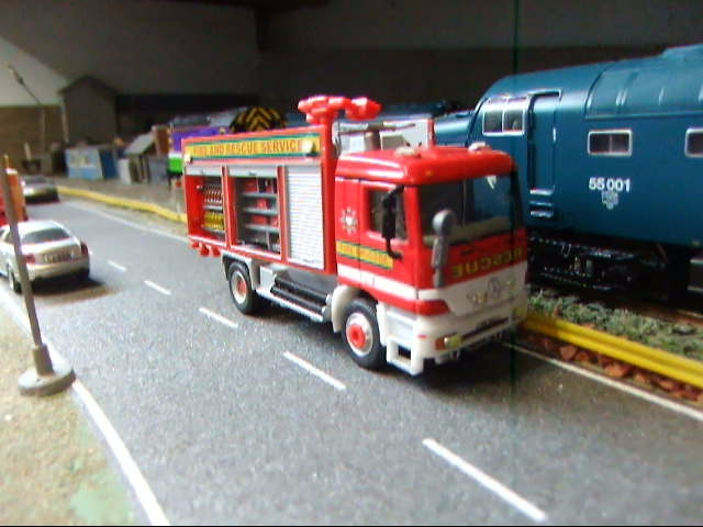

wexfordloco10 Posted September 23, 2012 Posted September 23, 2012 Hi I have modified a Carama Fire Engine it has 4 x Red ligths on Rear 2 x Blue lights either side (4) 2 x Blue lights on roof 2 x Blue lights on Front 2 x White lights on Front total 14 Leds a flasher unit was purchased from J Kytes approx £ 6.50 Time used A lot and pleanty of *******ing AS the video is too large please go to my Filckr site David Wexford WRMC

heirflick Posted September 28, 2012 Posted September 28, 2012 great stuff lads. david, that vid of your fire engine is a touch of class...as real as it gets! train model-great tips thanks for posting (anto as well)
