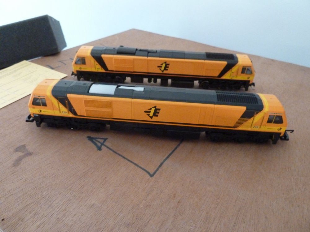

Well pics to wet appetite having read comments, I retrieved a MM version and see what fun needs doing , along with an SSM upgrade etch and potential for name plates from Railtec being advertised yesterday I hope to over come initial reservations.
Last pic I guess is "on the ramp" at the works!  Body popped on 219, I think that the boxy tanks can be upgraded with saw and plasticard , traction weight could go higher up along with a slug of liquid lead in the tank spaces.  Generally the body holds up well against MM version but faces worthy of a work provided paints match, unless I go for 216 in blue..

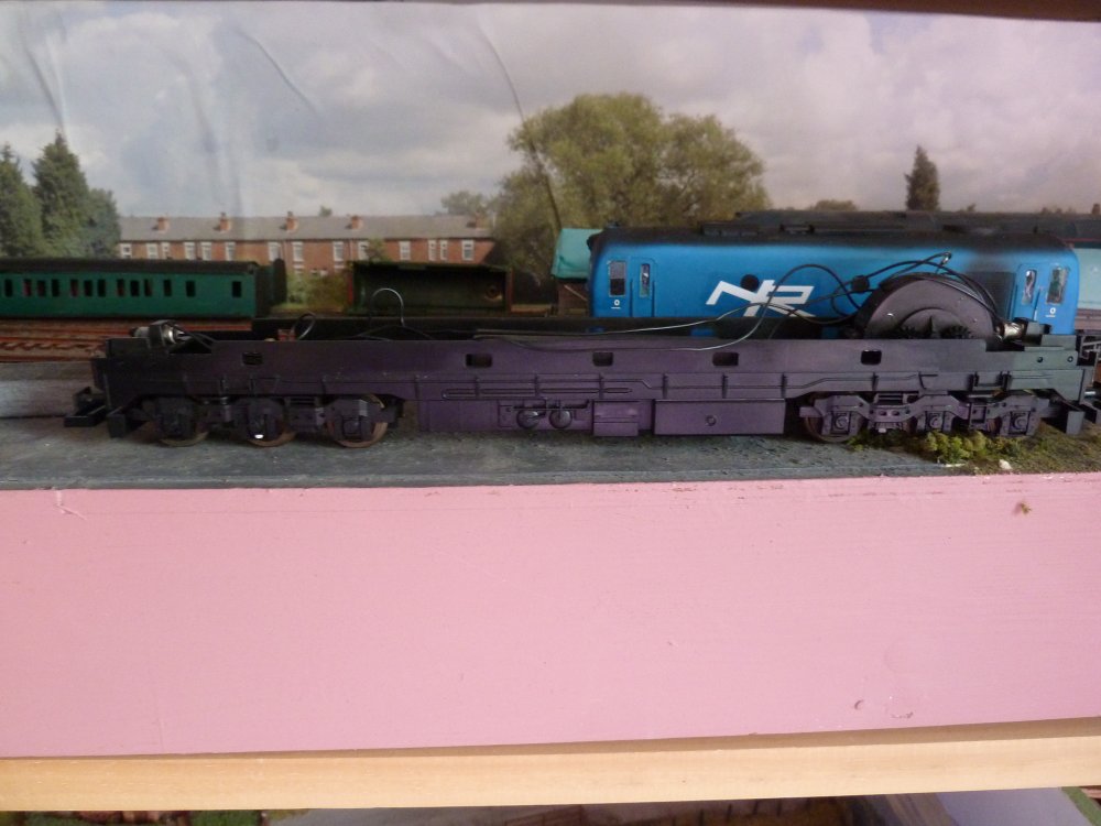

As a quick job while paint dried on a 450 body set I took the old lima  trailer bogie apart to remove old wheels and fir some Bachmann 14mm wheels- of course this led to drilling a 0.8mm hole and fitting a bit of brass wire to make a shorting pin so one wheel and axle live - to work the pickup.  The bogie is slightly upgraded as it has Lima  fitted pickup strip bearing on two wheels to help pick up on the traction tyre fitted  but with finer flanges and thinner wheels will need a further upgrade but at least half the chassis is basically upgraded  (the easy bit of course!)

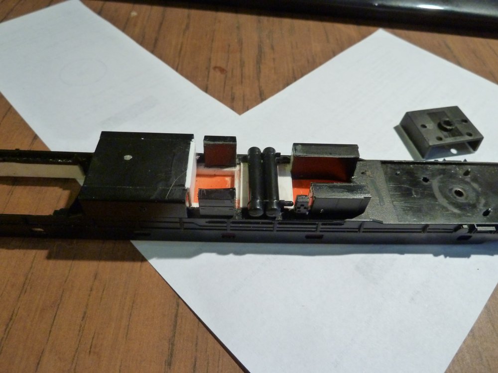

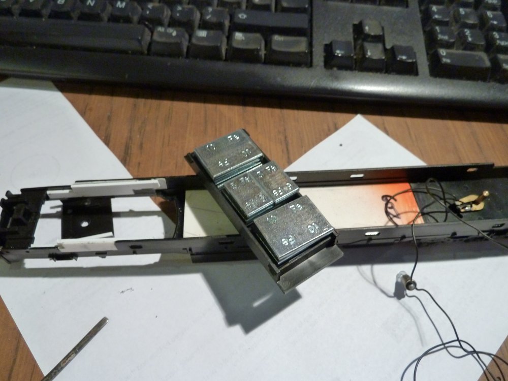

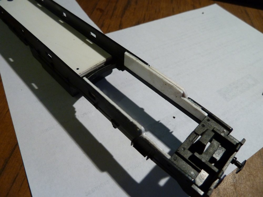

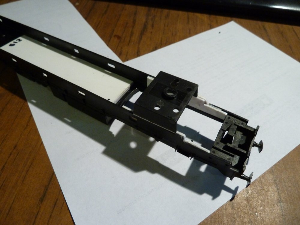

some pics of what could be called progress !  Chassis modified to take new motor mount and as a futher upgrade chopped out most of the lima weight box - a Hornby traction weight in fuel tank and 90g in the old weight retainer - this will make a good mount for the PCB.

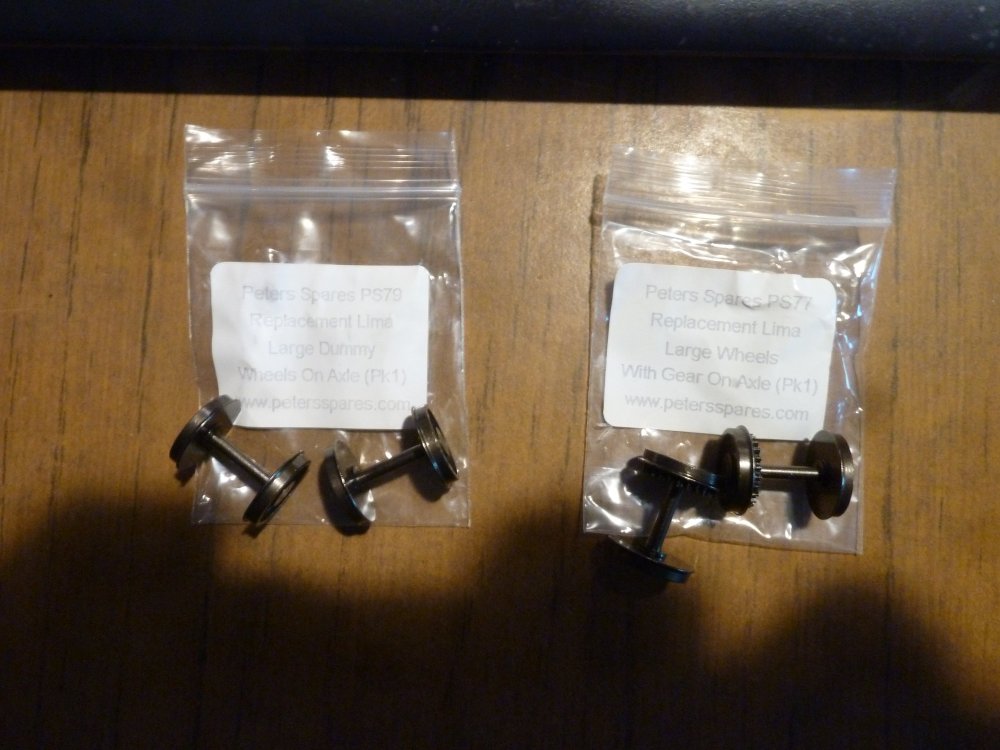

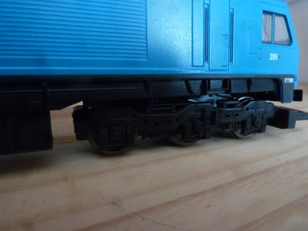

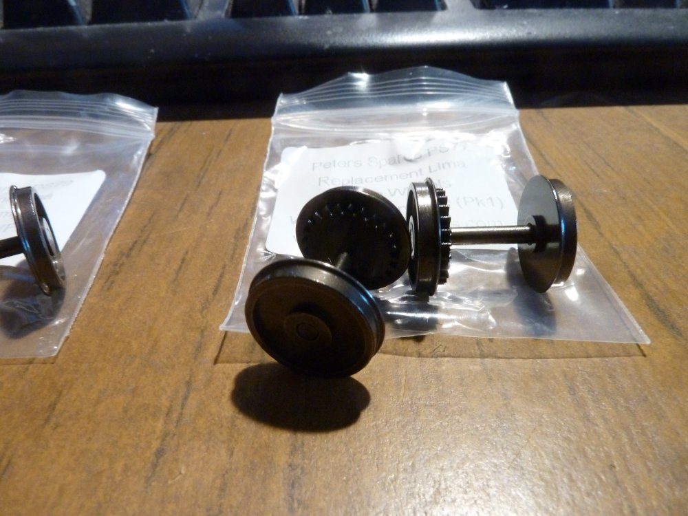

To update and divert , Peters Spares have introduced 2 packs PS 77 a geared wheelset to suit lima locos inc the 201, even though not listed ... PS79 is the non geared set, so for a 201 you need  1x PS 77 and 2 PS79.  The geared axle       retails at £9  for a pack of two axles which is very good value. the unpowered is £8.50. So under 30 for parts and allowing for p+P under 40 to simply drop in and replace.  With one "caveat" the middle wheelset on the powered bogie you will need to slice a slot to allow wheels to slip in, if matching the drivers it is a clip in fit.
1494173945_CIENIR201250422001.thumb.jpg.d55163ec860de4d722b926c815c6405e.jpg721027139_CIENIR201250422002.thumb.jpg.9639333aef5cb2aa62d4442e201f0b43.jpg close up of profile , B to b is 14.36 .

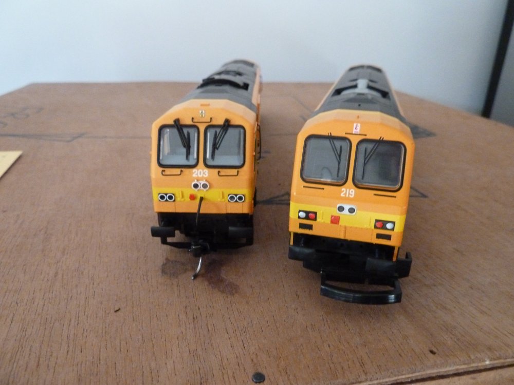

while winning no awards a pic of 209 showing the improvement.
OK it is still a lima pancake motor but it will run on modern track. With some front end fun with etches and couplings and pipes it does allow all those early models a chance to play again.
