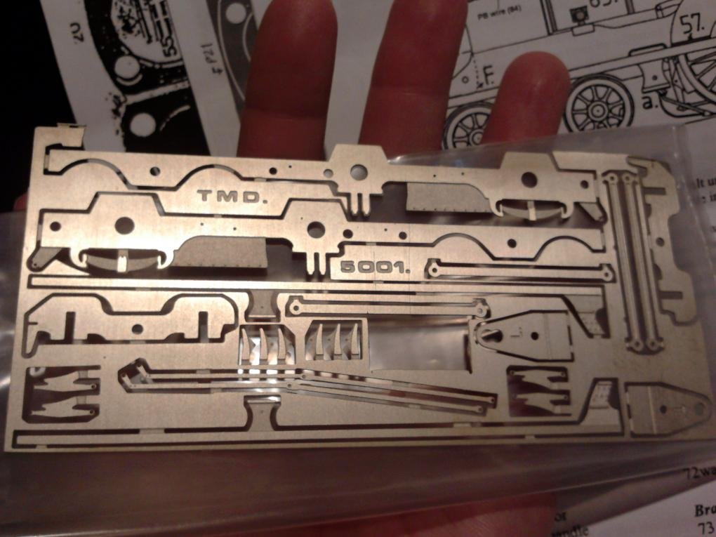

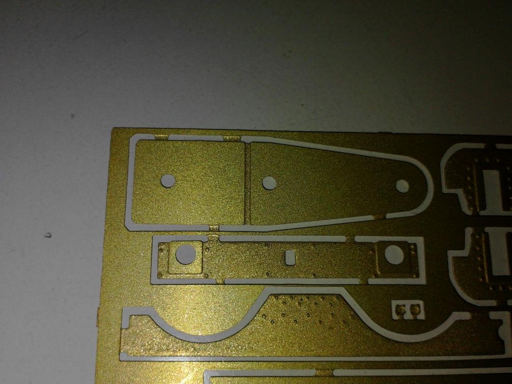

Horsetan Posted September 13, 2012 Author Posted September 13, 2012 (edited) [ATTACH=CONFIG]2621[/ATTACH] Horsetan, page 5 of the S Class has a diagram of the etches with numbering (and even the original non digital) instruction had this Is this not on the softcopy I sent you? Eh, no. There was no diagram...*bangs head against wall repeatedly* Edited September 13, 2012 by Horsetan
Weshty Posted September 13, 2012 Posted September 13, 2012 Eh, no. There was no diagram...*bangs head against wall repeatedly* Rest easy, check your email and the etch diagram is there for you. Customer service for even non-customers. Howzat eh?
Horsetan Posted September 13, 2012 Author Posted September 13, 2012 ....Customer service for even non-customers. Howzat eh? Ah...deadly! Thanks!

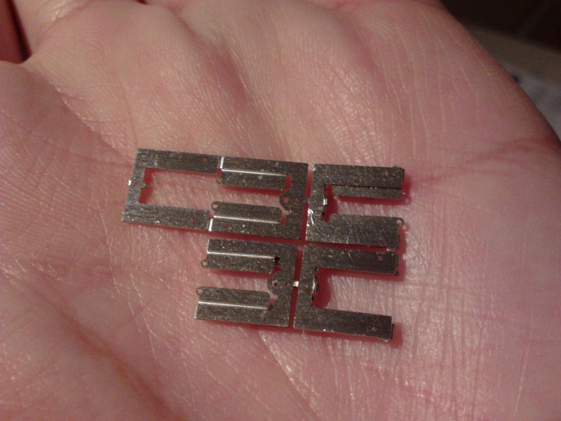

Horsetan Posted September 19, 2012 Author Posted September 19, 2012 (edited) High Level hornblocks and bearings arrived for engine and tender. No gauge, but think I'll make a start anyway. These show the four hornblock guides in different stages of preparation, from flat etch to ready-to-fit. The whole thing relies on a few folds, taking a few minutes; no soldering needed until you fit them onto the chassis frames. Edited September 20, 2012 by Horsetan

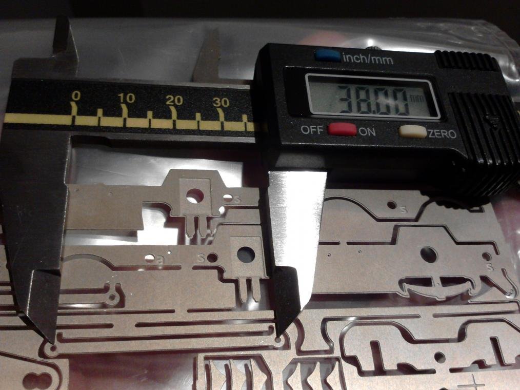

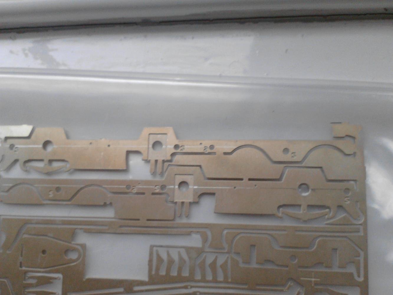

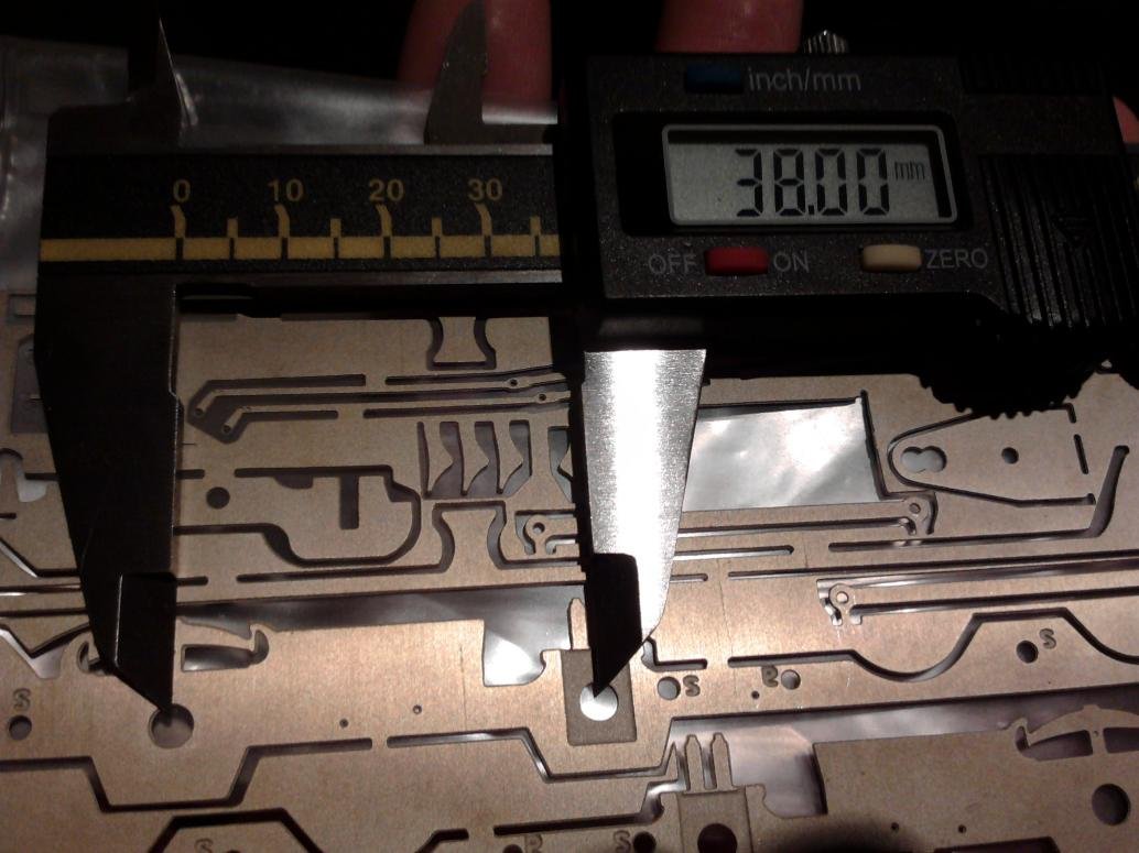

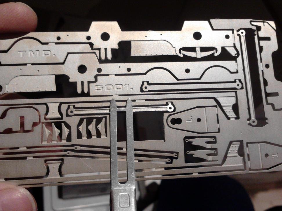

Horsetan Posted September 20, 2012 Author Posted September 20, 2012 (edited) Time to get the frame etch out and start checking measurements: Coupling rod bearing holes come out at 38mm centres, which is dead-on for a scale 9'6" wheelbase, and this matches the measurement for the axle centres on the frames: Now I did say I would be trying to equalise the chassis using Continuous Spring Beam suspension. On this four-coupled chassis, I want the centre / fulcrum point of the leaf-spring beam to be above the level of the hornblock guides. Looking at the chassis frames as supplied.... ....this could be a problem, because the low top line of the frames means there's nowhere to install a fulcrum. In an ideal world, the topline of the frames would continue straight through where the letters "T M D" are, instead of dipping down. 'tis time to improvise...... Edited September 20, 2012 by Horsetan

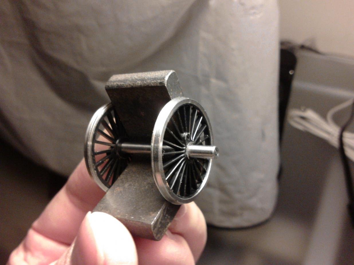

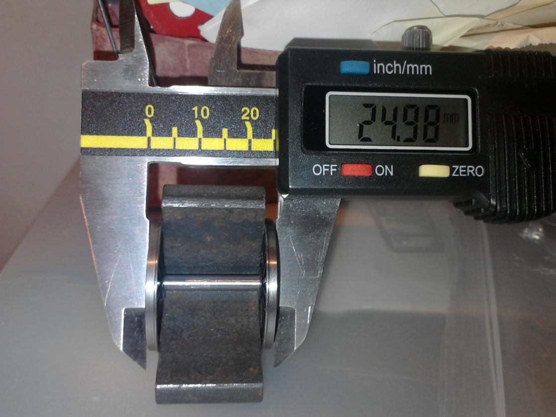

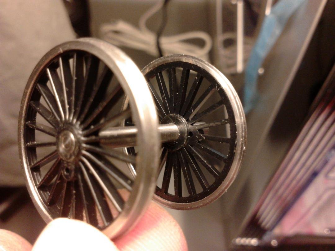

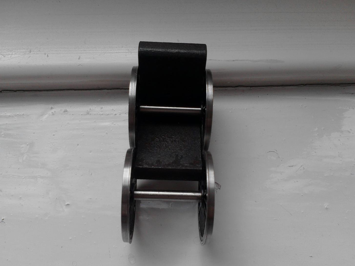

Horsetan Posted September 21, 2012 Author Posted September 21, 2012 (edited) Couldn't wait to test a pair of driving wheels on the Ultrascale lengthened axle: This shows the measurement over the wheel faces to be about 25mm, so if and when I order more driving axles from Ultrascale (think of the NCC "WT"), I can ask them to supply them at 25mm long as a reasonably standard length for Irish 5'3". ...Is there a checkrail or flangeway gauge available from the stores for 21mm as it's always handy to have two of each. There's supposed to be both a checkrail and a flangeway gauge in the Stores list. Tip: if you're stuck without the flangeway gauge, try substituting a spark plug feeler gauge, as there's usually one of the right thickness in the bunch. For example, one of the feeler "fingers" has a thickness of 0.58mm and this is dead-on correct for the flangeway in dead-scale (no compromise) Scalefour. It would also work for dead-scale 5'3" flangeways. Edited September 21, 2012 by Horsetan

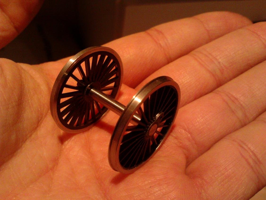

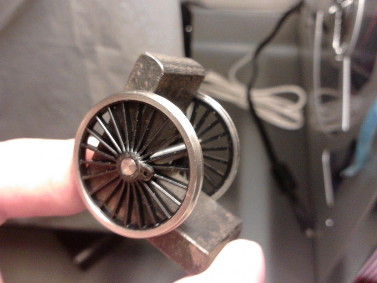

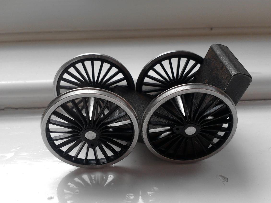

Horsetan Posted September 21, 2012 Author Posted September 21, 2012 One wheel is mounted flush with the axle end: The other end shows the excess portion needing to be sawn-off: Easy job with a piercing saw. In this photo, you can see that I have test-quartered the wheels, with the offside (r/h) crank leading: For those who don't deal with steam, that basically means that when the engine moves forward, it's the right-hand crank that will come round first, followed 90 degrees later by the nearside (l/h) crank. I don't know yet whether right-hand lead is correct for the "S"-class. There were some British steam classes (I think the LNWR "G2A" 0-8-0 was an example) which had a left-hand crank lead, as does the Drewry "04" diesel shunter.

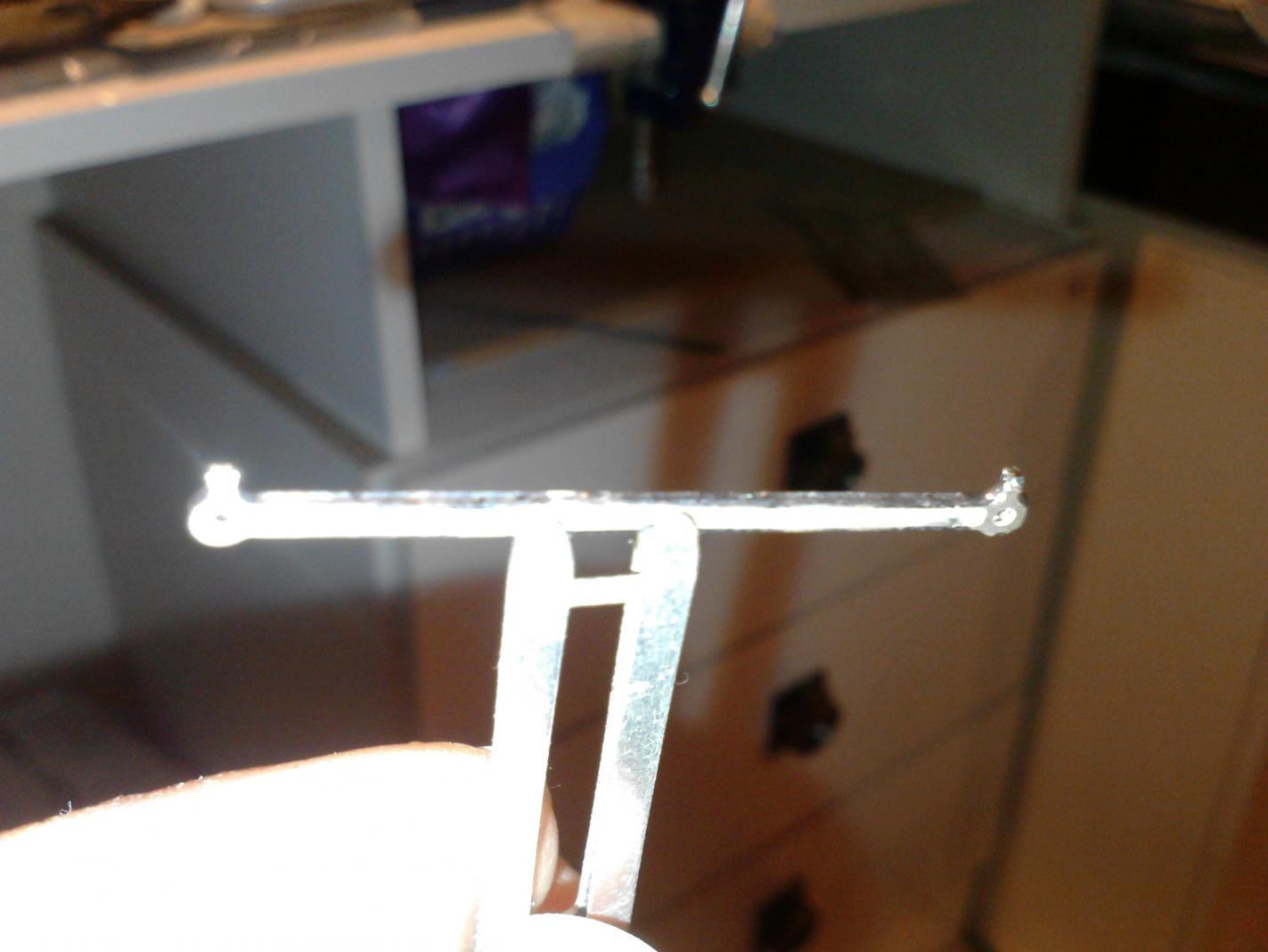

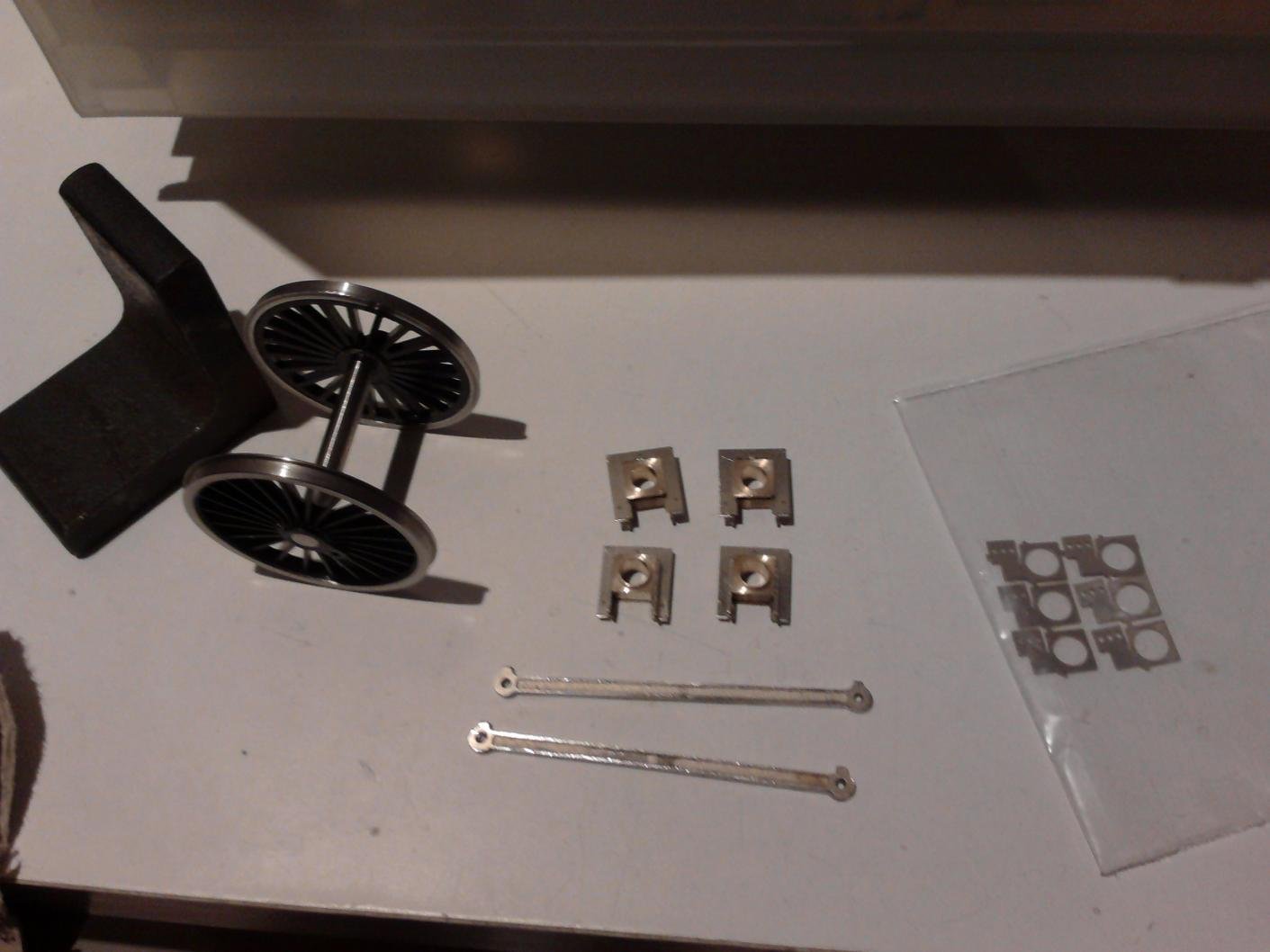

Horsetan Posted September 22, 2012 Author Posted September 22, 2012 (edited) Sawing off the excess axle length means I have a grand total of ONE completed wheelset ....so I could start putting the coupling rods together: 2 layers for each rod. Aluminium hairgrip is all you need to keep 'em together during soldering: Then remove the rod from the fret in order to file down and clean up the excess solder: An evening's work: I think we'll start sawing out some chassis spacers next..... ...By the way i can't see the whiskey bottle in the background. That would be a Chivas Regal 12-yr-old. It will be mostly empty by the time this engine is finished. Edited September 22, 2012 by Horsetan

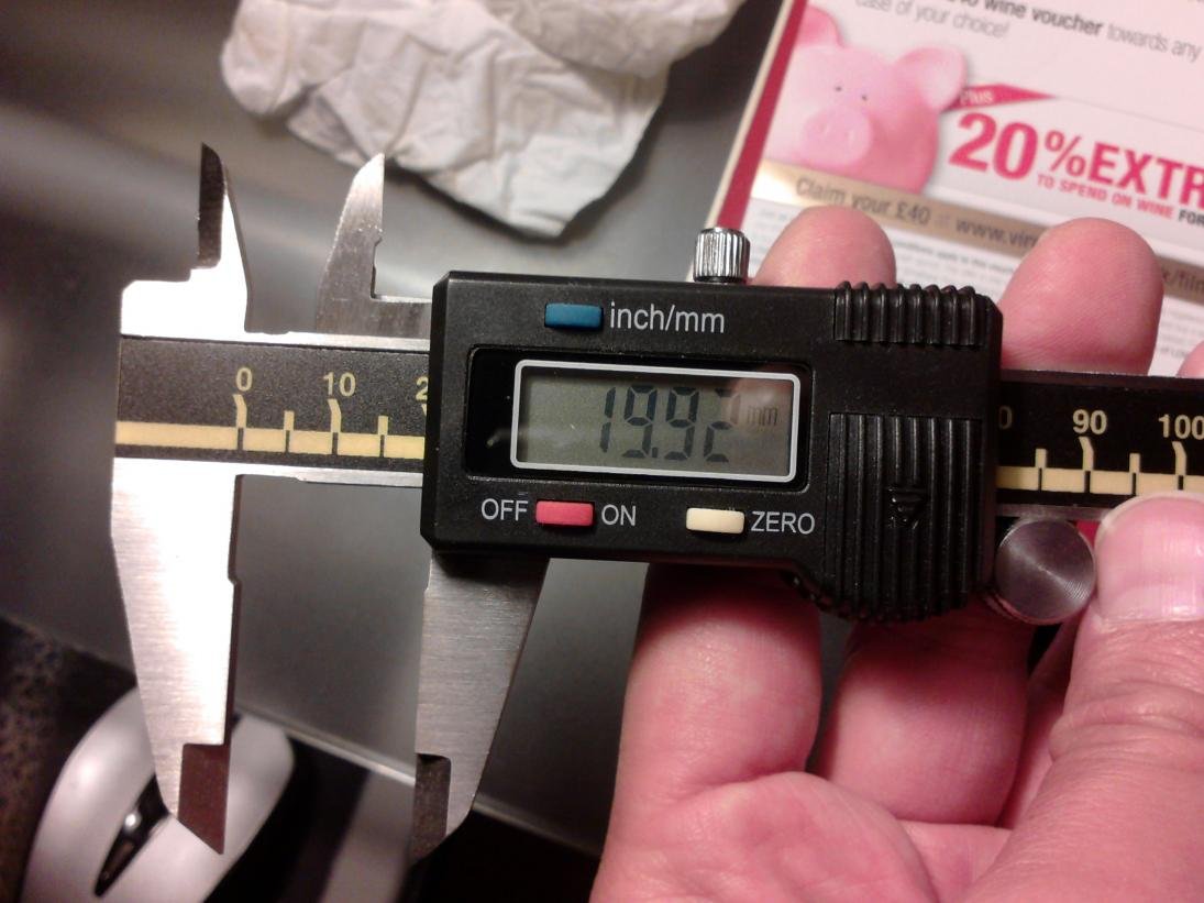

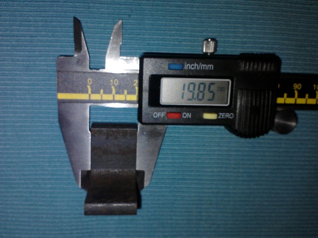

Horsetan Posted September 27, 2012 Author Posted September 27, 2012 (edited) Completed cutting the second driving axle just before leaving for work this morning, so I now have both driving wheelsets test-mounted and gauged to 19.85mm back-to-back. Was a bit unhandy with the piercing saw on the second set, so there are a few scratches on the tyre faces .....I tend to follow your example and produce my own rather than use the brass spacers provided. I think L-shaped spacers from n/s or brass provide more support than the square ones. What I could do with is more frame depth in the area of the driving wheels, particularly over the hornblocks, to provide a bit more strength to the topline of the frames. I know the original design which persists to this day was the most expedient way of catering for most builders, which is fine and would have worked well for the many people who bought and built these kits over the course of two decades-plus; I just wanted to see if I could develop it a bit further. I am looking at assembling the footplate/ cabsides / valances as the kit stipulates, and then assembling and test-fitting the cab interior (which the instructions say is for 21mm gauge anyway - grand ). Putting these sub-assemblies together will hopefully show me how much room I've got for the chassis, and whether I can add material to strengthen the latter whilst I install the CSB suspension system. The bogie also looks as though it can tolerate a change in assembly. Edited September 27, 2012 by Horsetan

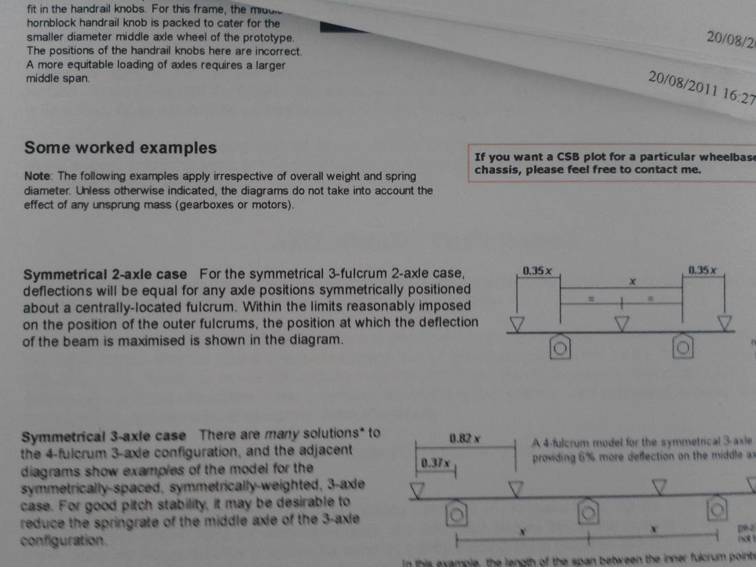

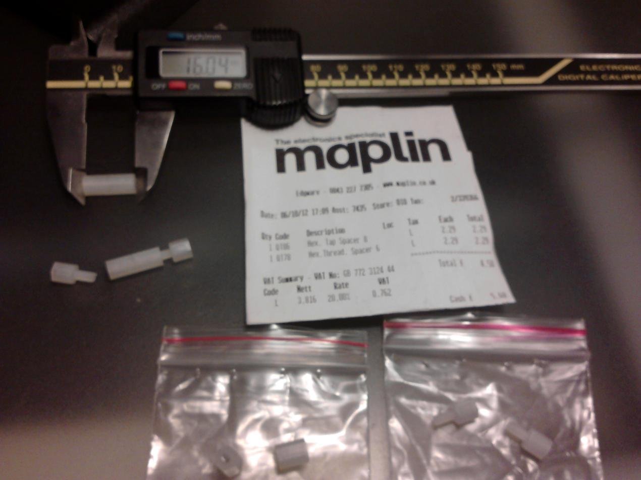

Horsetan Posted September 28, 2012 Author Posted September 28, 2012 (edited) The thickness of each mainframe is 0.5mm, so the homemade spacers will need to be at least 16mm wide. Further time has been spent using CLAG principles for setting up the continuous spring-beam suspension: For an in-depth guide to how the principles work, click here. This being a four-coupled chassis, I'm using the symmetrical 2-axle setup. Edited September 29, 2012 by Horsetan

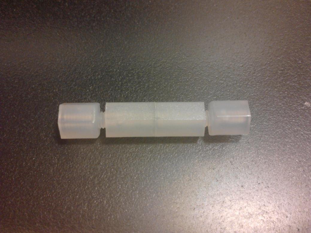

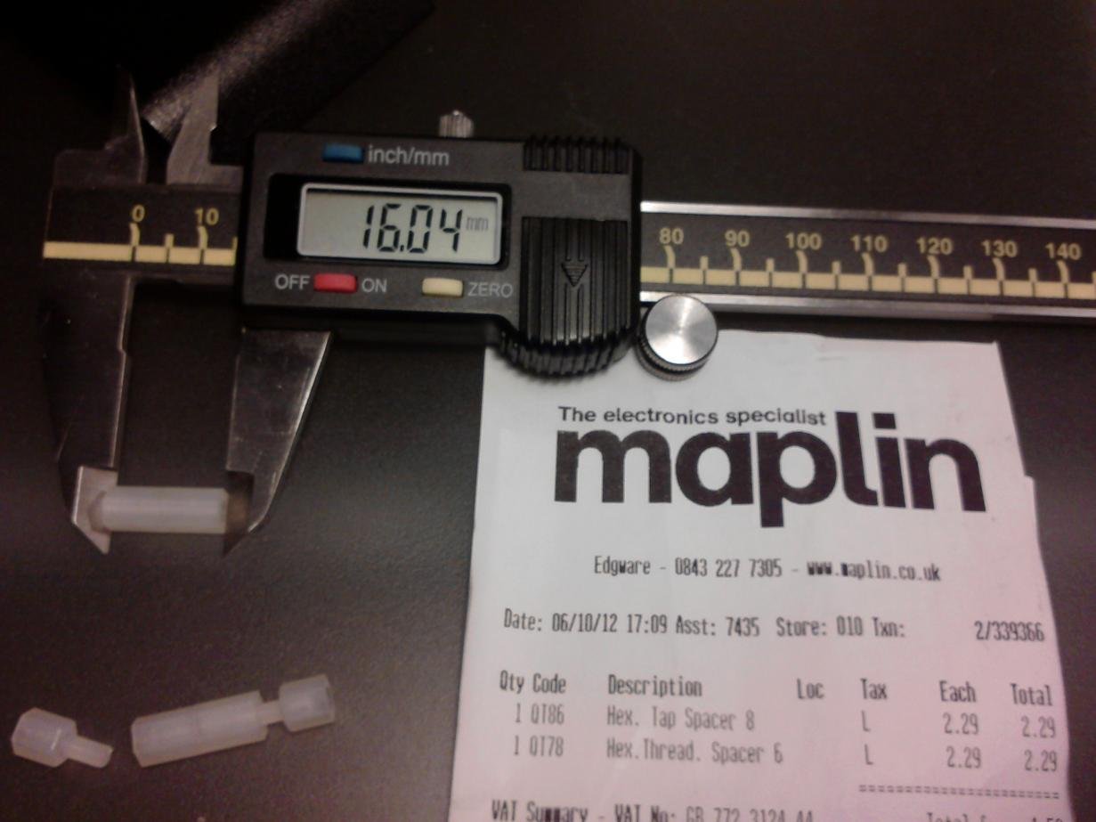

Horsetan Posted October 6, 2012 Author Posted October 6, 2012 After acquiring replacement drill bits, I had a think about how to set up the frames. The instructions refer to using the rectangular brass screw-in spacers, but they weren't what I wanted. My own P4 frame assembly jigs are set at around 14.8mm wide for British standard gauge; too narrow for Irish 5'3". Thinking laterally about the problem, and having a trawl around a local electronics shop, some nylon hex spacers and screw-in spacer caps were discovered: The hex spacers are 8mm wide and superglueing a pair together makes a spacer 16mm wide - perfect: The screw-in caps will help keep the frames in place whilst the proper nickel-silver spacers are soldered in:
RedRich Posted October 7, 2012 Posted October 7, 2012 That's an excellent compromise with the hex spacers. The updates of the build are very informative and are a breath of fresh air as I haven't seen anything like it on here before regarding a 21mm build of a steam loco so well detailed and described. It's got me itching to have a go at something similar myself. Maplins are a great source for getting tools and other items for railway modelling. I've purchased wire for the electrics on previous layouts and the new build. Soldering irons, drill bits, transformers etc among countless other items needed for the hobby. I recently picked up a nice soldering fume extractor and some extra filters for a good price. Rich,

Horsetan Posted October 7, 2012 Author Posted October 7, 2012 That's an excellent compromise with the hex spacers. I specifically wanted something that would give me a 16mm spacer width. It was truly the "Luck of the Irish" that I realised the hex spacers, when glued together, would do the job. The updates of the build are very informative and are a breath of fresh air as I haven't seen anything like it on here before regarding a 21mm build of a steam loco so well detailed and described. I adopted the step-by-step photo approach with notes, so everyone can see how I work and - if they choose - adapt those methods for themselves. Think of it as a nod to the exploded "eejit diagrams" designed by Airfix, Revell, Tamiya and so many other international plastic kit producers. It's got me itching to have a go at something similar myself. Scratch that itch
