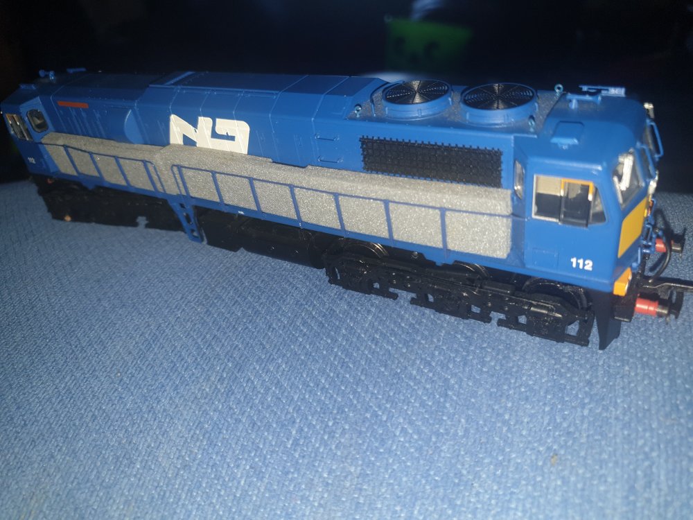

I'm fairly new to this game in fact I havmt even got a layout yet although I have some rolling stock and have a plan for a layout but that's for another topic..
I have Murphy model NI blue 141 it was running but now has stopped was running on standard D.C I think I had two locks on one track at same time so now I need help on what I can do to fix it or even start find out what's wrong all help appreciated.

Cleanliness comes well before godliness in all aspects of model railway running. Is the track clean? Are the wheels clean? Try putting two wires direct to the wheels, rather than the track, to see if the pick ups (some or all) are working.
Try taking the body off, if you can, and put wires directly to the motor.
 It is all about trying to eliminate what  might be wrong, until you find the thing that is. Good hunting, and keep us appraised.
