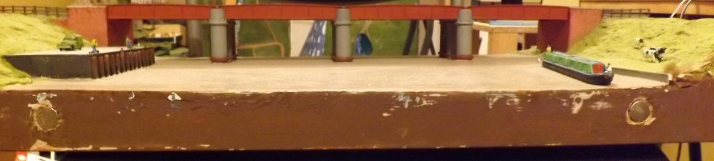

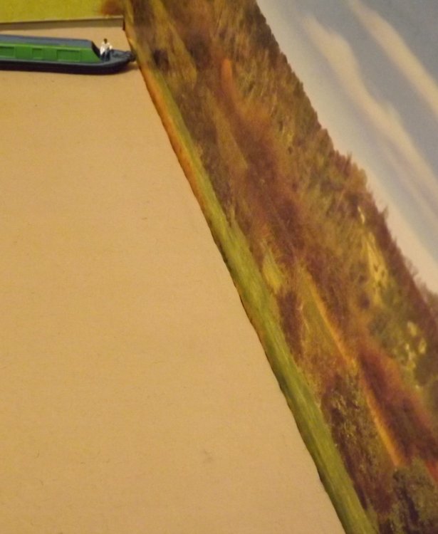

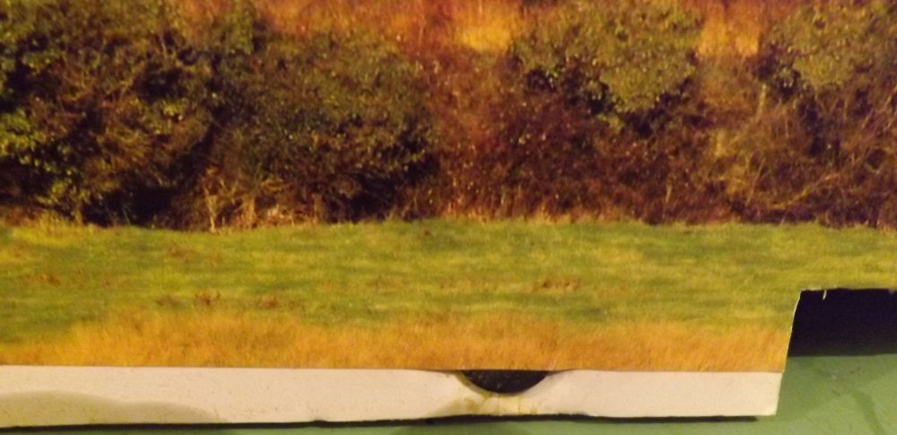

0 MikeO Posted October 10, 2019 Posted October 10, 2019 Have not used velcro as I thought it would make the backscene sit too far out from the baseboard creating an unseemly gap. Magnets would be a better choice as they can be recessed into the baseboard and just require 2 thin pieces of metal (washers) glued to the backscene to make a good join. I have attached 3 photos to illustrate the concept. The first shows the 2 magnets in place, the second one of the washers, it can be partly covered, and the third shows how little gap there is. This is not my idea but a friend used on his T Trak module. Hope this is helpful MikeO 1 Quote
