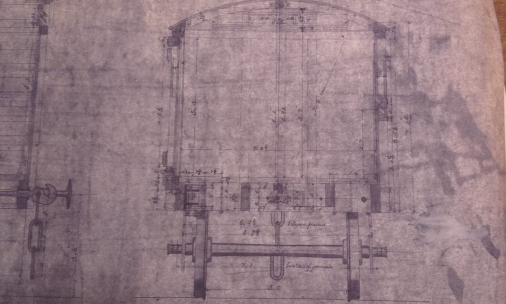

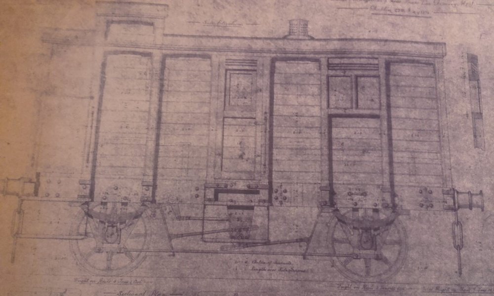

Am interested in building one of these. Have a drawing, which according to the wheels, seems 7mm scale. However, the dimensions in this article suggest otherwise, particularly with width, which you can see is given as 9'7" - generous, even by Irish standards.
 Also, cannot find any info on how long they lasted, though clearly at least up to 1932. Likewise, they seem a little camera shy.
 Essentially, am thinking that one of these, as part of a fish train (using the MGW hearse van), would make a nice consist for my new J19 to pull. 1950s period, would that be appropriate? Thanks as ever.

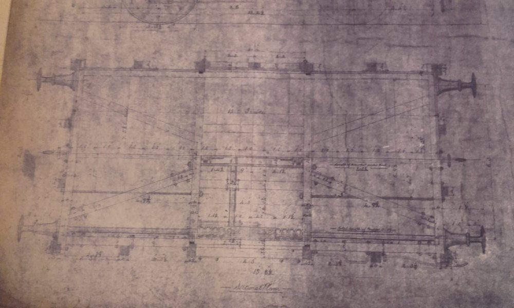

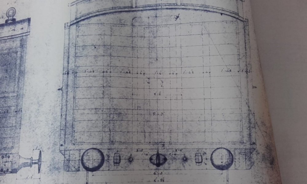

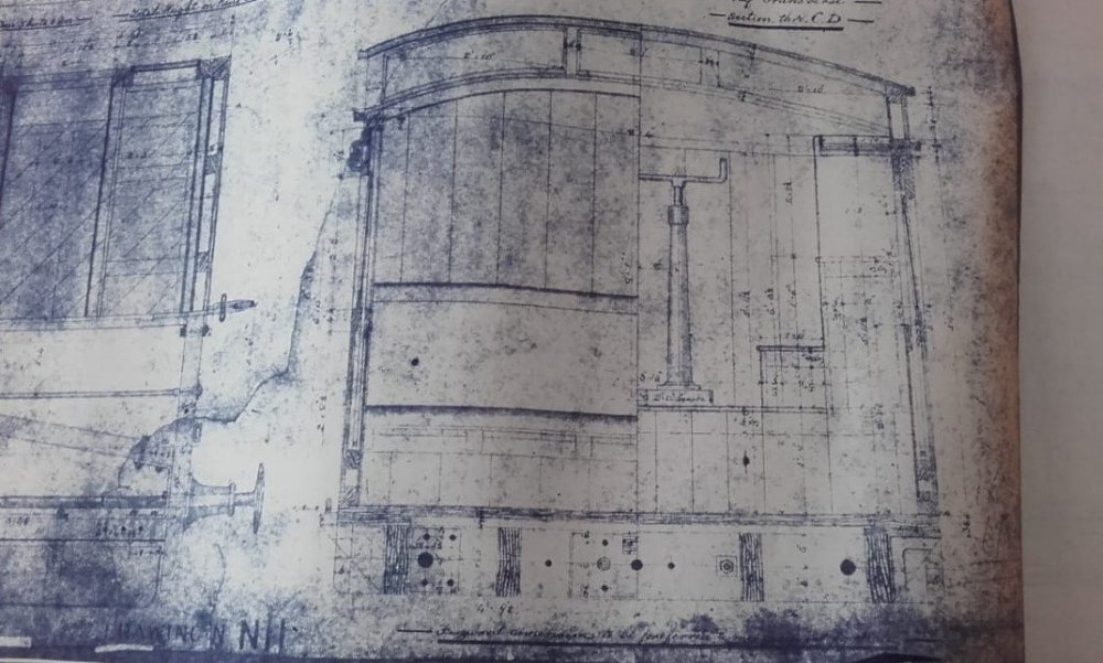

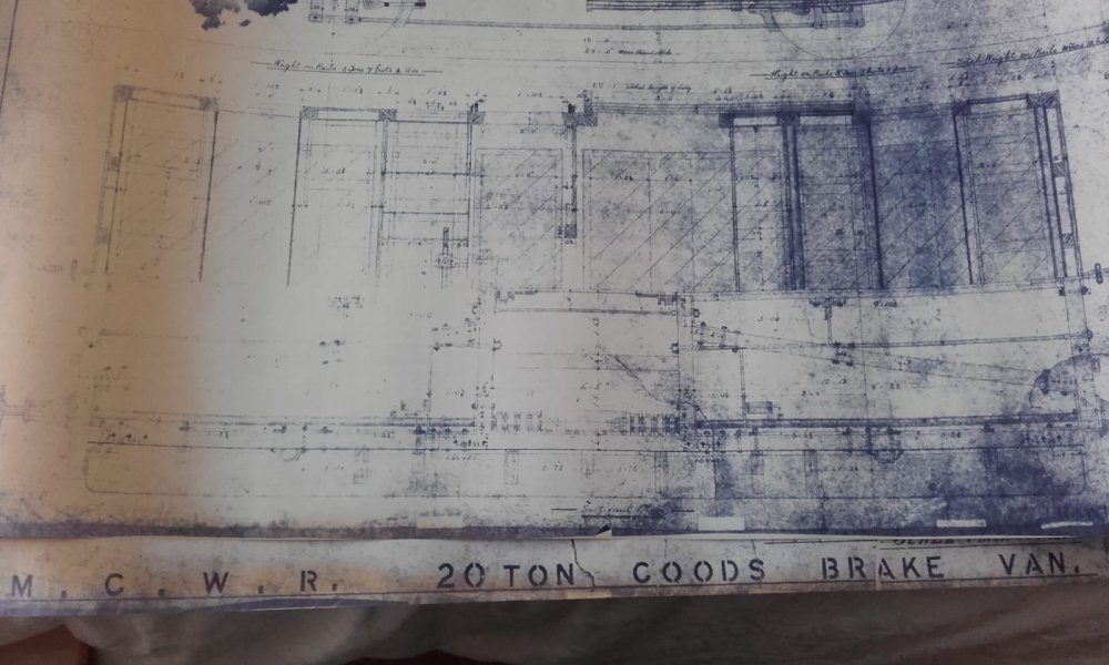

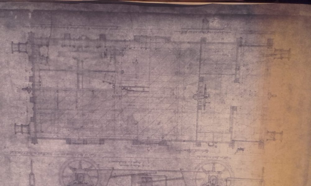

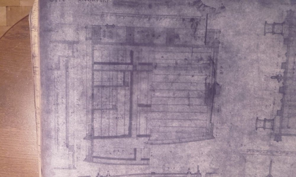

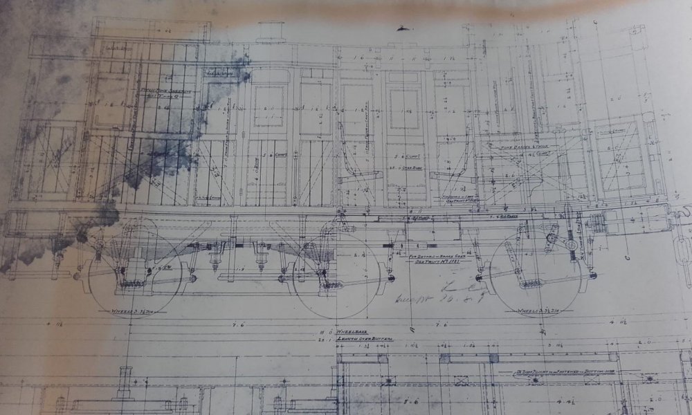

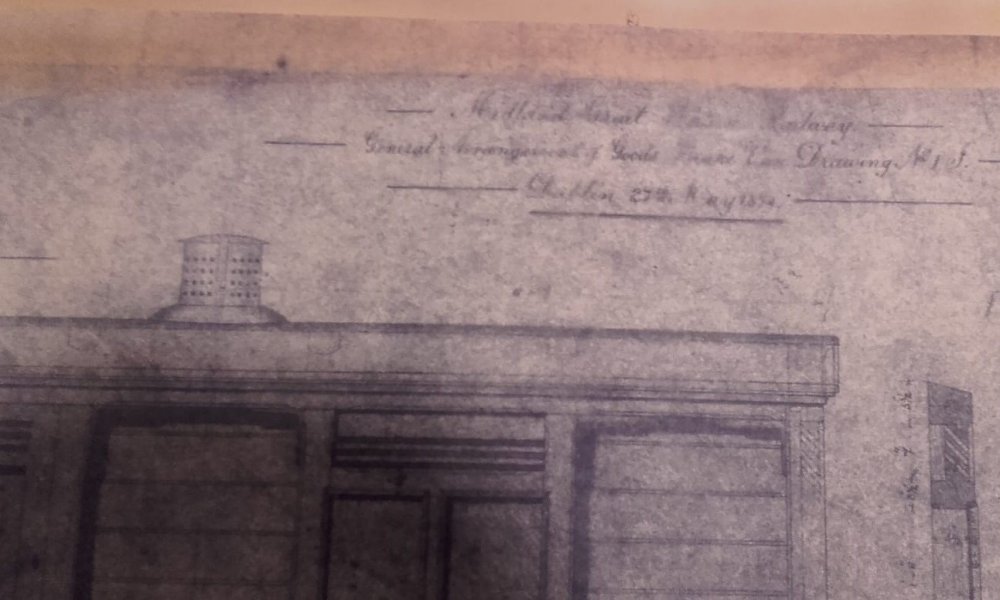

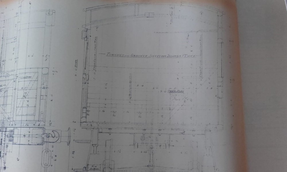

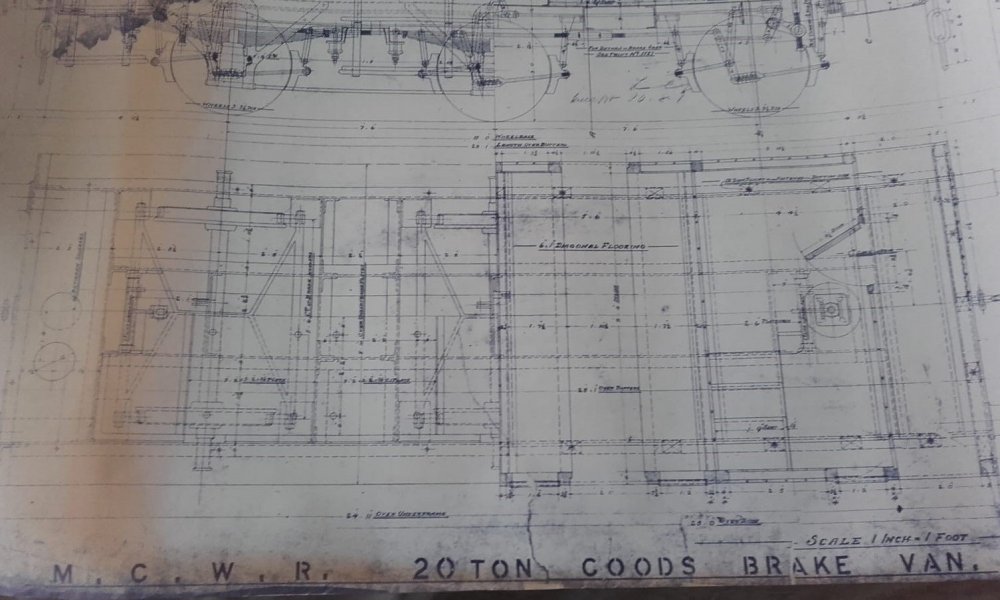

Thank you! Some interesting details there - though I think it is the six wheel, 20ton version, but very useful nonetheless.
The dimensions on the drawing I have are quite difficult to read, so these should help. What I've done so far is to use a standard dimension, in this case the 6'3 between buffer centres, to rescale it on the printer/copier. Turns out the body is 9' wide, though maybe the 9'7 quoted is over the extremities?
