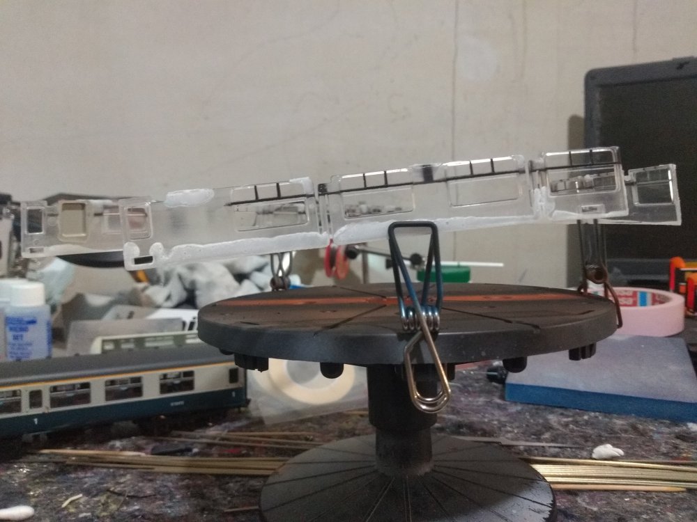

0 murphaph Posted July 23, 2021 Posted July 23, 2021 Quick question about the Bachmann mk2a FK... The corridor side (only) glazing has a silver horizontal stripe painted along the full length of the inside of the glazing. Is this supposed to represent a handrail or something inside the coach? If so I'll need to try to remove it I suppose as I am sure this would have been removed by IR: Are there any appropriate window transfers available for these coaches from Railtec etc? (No smoking etc) Quote
0 flange lubricator Posted July 23, 2021 Posted July 23, 2021 9 minutes ago, murphaph said: Quick question about the Bachmann mk2a FK... The corridor side (only) glazing has a silver horizontal stripe painted along the full length of the inside of the glazing. Is this supposed to represent a handrail or something inside the coach? If so I'll need to try to remove it I suppose as I am sure this would have been removed by IR: Are there any appropriate window transfers available for these coaches from Railtec etc? (No smoking etc) Yes the handrails will have to be removed on the FK's(IE did fit handrails to the snack cars 4401 & 4402) 1 Quote
