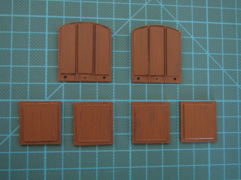

Some more progress. Near side strengthened and glued in. Have added steel frame bracing and given a coat of paint. (Doors just sitting on for picture, not glued on as need more work, a bit more scribing, weathering, and will probably want to put on 'G' and 'N' letters on doors before gluing on). @jhb171achill, Jonathan, any advice on livery? The only colour pictures I have seen (page 72 in The UTA in Colour @ Downshire and page 100 in Steam's Last Fling @ Whitehead seem to have a hint of very faded red, as if they had a coat of mahogany at some stage!. Or do you think just a darker brown? That colour I have used on the planking is Humbrol 110, Natural Wood. Roof sits out enough to allow for 'signature feature' of valence over doors, so am very pleased with that! -

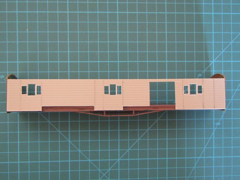

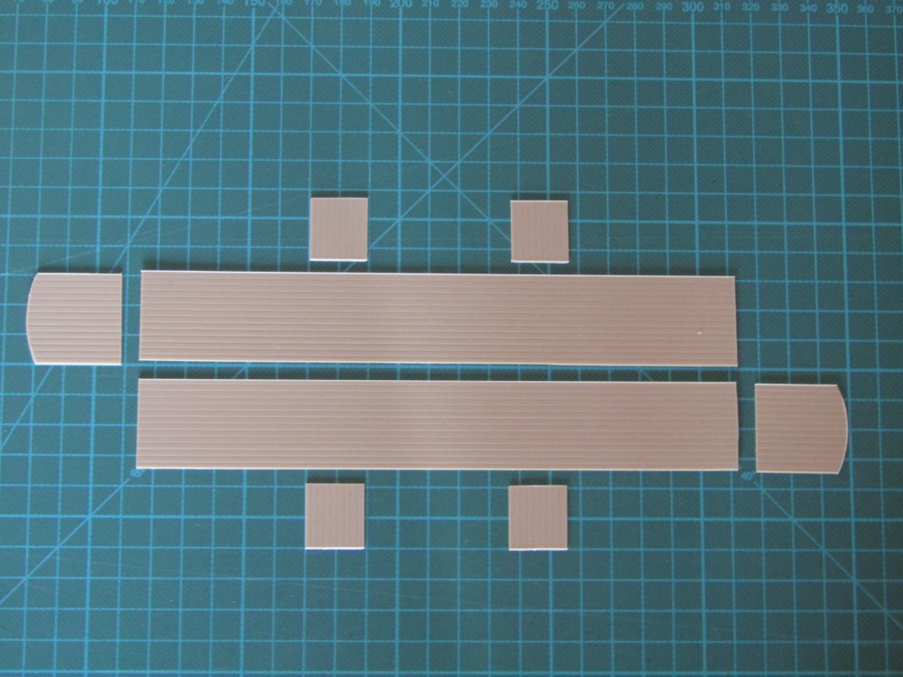

Have done some work on the solebars and attached the ends. Side just sitting on top to check fit. Obviously, a lot more work needs done on the sides before they can be glued in, strengthening etc! Have cut the six slots for the vents, not perfect, but hopefully eventually both windows and vents will be brass etch and will be very tidy! -

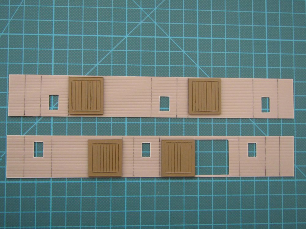

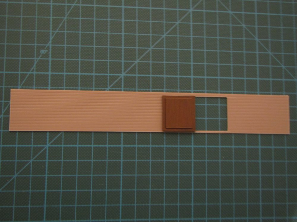

In response to two profound comments above, Galteemore, it's already too late, I am addicted already, addicted to making as accurate a model as possible, and MikeO, yes, I have learnt already that patience is key, one little slip can destroy hours of work. I decided that the doors weren't right! One layer of Embossed Planking on top of plain 1.5mm Plastikard, so the two layers look wrong, more like a kitchen cupboard door! I decided to take one piece of Plastikard and scribe on the planking. I think this looks better and more realistic. I had to cut 8 or 9 doors to get the two on the near side, the side which will be visible when the model is on the layout, the best two, and the next best two on the other side, so practice makes (well not perfect) but pretty good! I have marked the positioning of the steel frame bracing to give me the proportioning on each side and assurance that the measurements are correct and cut out the three windows on each side. Hoping the GNR(I) enthusiasts will recognize the beginnings of a 'P' Van! -
Firstly, I never imagined that I would be posting a topic on the Workbench Forum! I am constantly amazed by all the masterpieces that appear here, especially those super brass steam engines and Victorian carriages, BUT, having discovered the GNR(I) 'P' Van and it's typical 1960's roster, being taken off the 3pm ex Londonderry at York Road and attached to the 5:30pm ex York Road to Larne Harbour, with mail for Stranraer, I have become intrigued and want to model it's authenticity and unique links with Larne Harbour. My aim is to model one of the 1934 built P2 Vans (783 - 788), actually 788 as a tribute to it as it still exists, albeit in a derelict and forlorn state at RPSI, Whitehead. I intend to leave one of the doors open and have the van sit in a siding at Larne Harbour with mail bags being unloaded for transfer to the Stranraer Ferry. Many thanks to MikeO and Leslie McAlister who provided a lot of detailed information and Lambeg Man and airfixfan who posted photos when I asked a question on the Questions and Answers Forum about the 'P' Van. I have also unearthed a few photos in various books. After lots searching, I came across a Southern Railway Bogie Parcels Van (Ratio Kit 592). This will help with the chassis, (slightly oversize, but easily adjusted to exact), and bogies, and the body will be entirely scratchbuilt with Slater's 2mm (6 inch) Embossed Planking and plain 1mm and 1.5mm Plastikard. So here goes, first tentative steps, the first cuts: and the four doors and two ends, I wanted to have the planked ends, as per the official GNR(I) drawing, even though some photos seem to show plain smooth steel ends: and the cut for my open door, difficult to get correct, but I'm happy with it! More photos of progress to come soon, hopefully............
