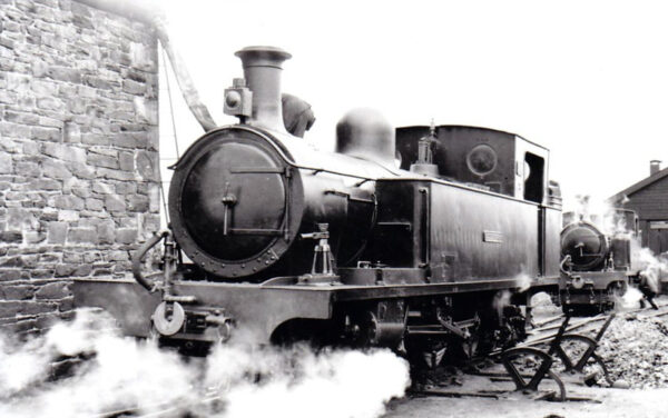

Right, moving to here from the British loco conversion thread... Following the Cultra exhibition and the Hattons 6 wheeler announcement, I have been trawling the Internet looking for another Irish project, preferably one which can use a RTR chassis. At first I considered 850 using an LNER V1/V3 chassis, but the chassis just wasn't close enough for me to be happy with it. Then I saw 670, and the chassis looked similar enough to a GNR/LNER N2, which I conveniently have one of currently doing nothing... A quick conflab with @Westcorkrailway and @jhb171achill gave me a set of drawings and confirmation that the chassis isn't too far off. Close enough for me, anyway! Jhb- you mentioned in the other thread that these locos carried lined green, which I much prefer to plain grey-could I ask what the colour of the number would have been and do you know where I might find appropriate lining transfers? This is likely to be a project for the new year, but it doesn't hurt to plan ahead! I'd be happy to sell prints of the body to anyone interested too.

Thanks a lot for those! They'll be very useful. I don't suppose you'd know the width dimensions or have a front view? Might be being cheeky now No worries, and I think the chassis is close enough for this to be a goer. I'll log progress on my workbench. Thanks both! -

Are there any things on a similar chassis then? I've got a 3D printer and can do the CAD. I have been inspired by the exhibition at Cultra and the Hattons coaches... Doesn't have to have made it to CIE though! 65mm/16'3" coupled wheelbase, 5'6" driver diameter, 24' overall wheelbase and 3'6" trailing wheel diameter. -
