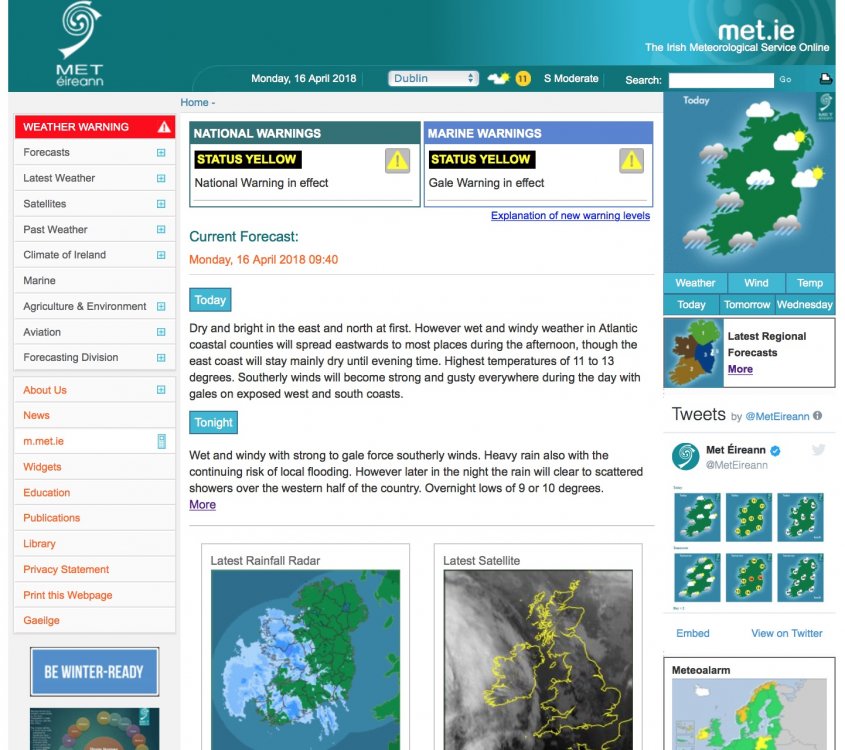

  7. 'Au Revoir' met.ie old web site on the 18th. It has served well for many years, was concise and visually effective. One of the first to incorporate an animated rain fall radar which was one of the sites best features. The all new singing all dancing met.ie web site launches later this week. It has tons of visual data.
