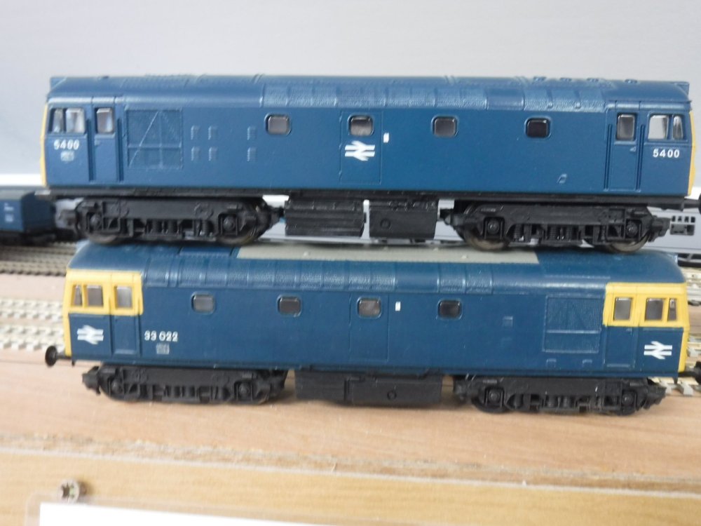

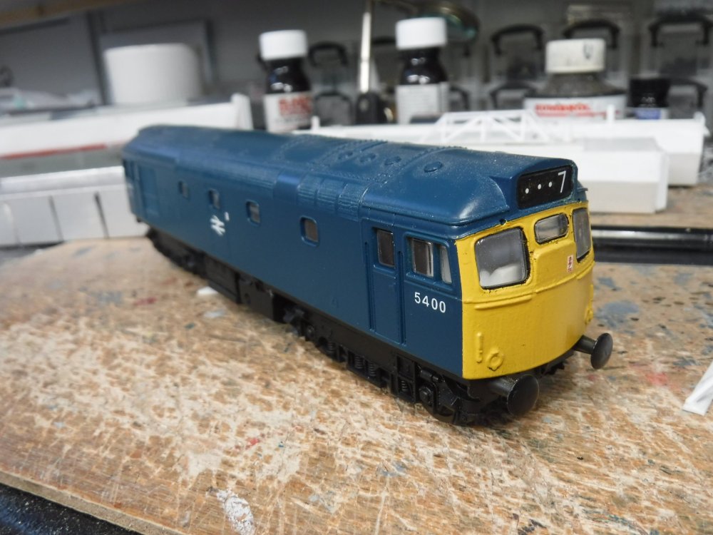

gibbo675 Posted October 20, 2024 Posted October 20, 2024 Hi Darius, You won't need any extra weight to get it to pull trains. How does the new motor fit ? You noted it at the start of the build however you haven't shewn any details of its fitment. Here is my 27, it's a Lima one so I cheated slightly. This is a short lived livery variant of the late 1960's early 1970's in that the yellow does not cover the cab side windows. I painted the inner edges of the cab front windows black to give the appearance of rubber mounts. as with too many of my models I need to finish it off by putting proper buffers on it and fitting hooks and hoses. I did fit Hornby class 25 cab interiors to it which has added a little extra tot he Lima model. Gibbo. 1

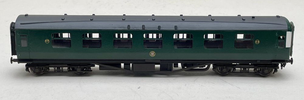

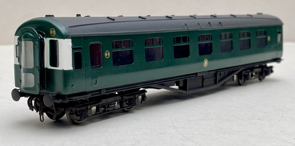

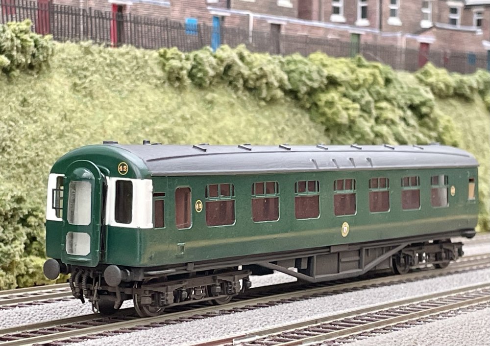

Darius43 Posted October 24, 2024 Author Posted October 24, 2024 Something different - BR wagon built for carrying DEMU engines between depots on the Southern Region. 3D printed kit by 12A models. The kit goes together nicely. I printed my own decals based on images on the 12A models website. Cheers Darius 6

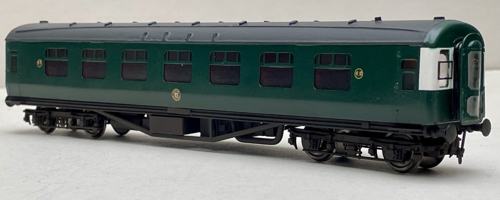

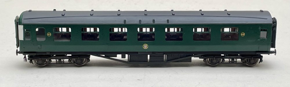

Darius43 Posted October 25, 2024 Author Posted October 25, 2024 (edited) Getting back to this one, finally. New undergibbon fittings, glazing and interior required. Cheers Darius Edited October 25, 2024 by Darius43 7 1
Darius43 Posted October 25, 2024 Author Posted October 25, 2024 Undergibbons fitted using plasticard and copper rod. Cheers Darius 5
Darius43 Posted October 25, 2024 Author Posted October 25, 2024 Undergibbons painted. Cheers Darius 3 1

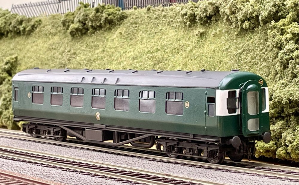

Darius43 Posted October 26, 2024 Author Posted October 26, 2024 Glazing fitted and interior cut and shut from spares box coach interiors. Decals and other details next. Cheers Darius 1
Darius43 Posted October 26, 2024 Author Posted October 26, 2024 20 minutes ago, Galteemore said: Love the ‘space age’ gangway door! Hence their “Sputnik” nickname. Cheers Darius 1 1

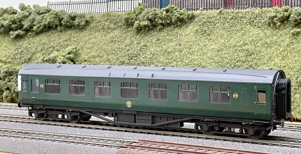

Darius43 Posted October 26, 2024 Author Posted October 26, 2024 Decals and light weathering to finish. Cheers Darius 4

gibbo675 Posted October 26, 2024 Posted October 26, 2024 Hi Darius, You have got me thinking and so far I have theories about this latest batch of kit builds It is a fun way to use up spare chassis. It is a difficult way to add extra weight to Lima BRCW Sulzers. You have a secret plan for all of the Lima body shells. The original models were left on the window sill and warped in the sun You are trying to emulate BRCW by redesigning the wheel and causing yourself financial ruin. Or could it be something else ? Do be aware that the undergibbons of the class 27 is a slight different to that of the class 33, the Lima moulding being correct for the class 33. Should you convert one of them could perhaps swap them about A Vic Berry-esqu juxtaposition which shows* that the No. 1 end is opposite with regard the fuel tank. between the classes. * no chaic for you today ! Gibbo.
Darius43 Posted October 26, 2024 Author Posted October 26, 2024 I was aware of the fuel tank differences between the 33 and 27 but chose not to hack about the chassis too much at this stage. I’ve been collecting MTK for some time now and am building them for fun and to show that they can be built to a reasonable standard compared to the rtr Heljan examples - of which I have quite a few. At the end of the day I really enjoy building kits. Cheers Darius 3

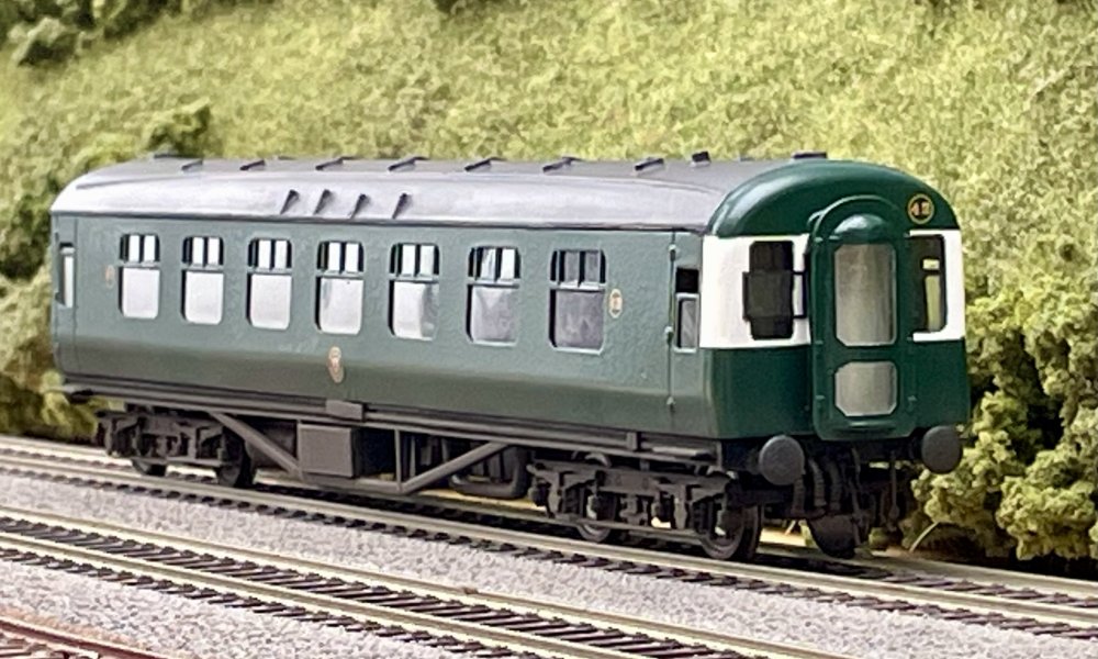

Darius43 Posted October 27, 2024 Author Posted October 27, 2024 Initial painting completed. Cheers Darius 2
Darius43 Posted October 27, 2024 Author Posted October 27, 2024 Secondary painting completed. Cheers Darius 3

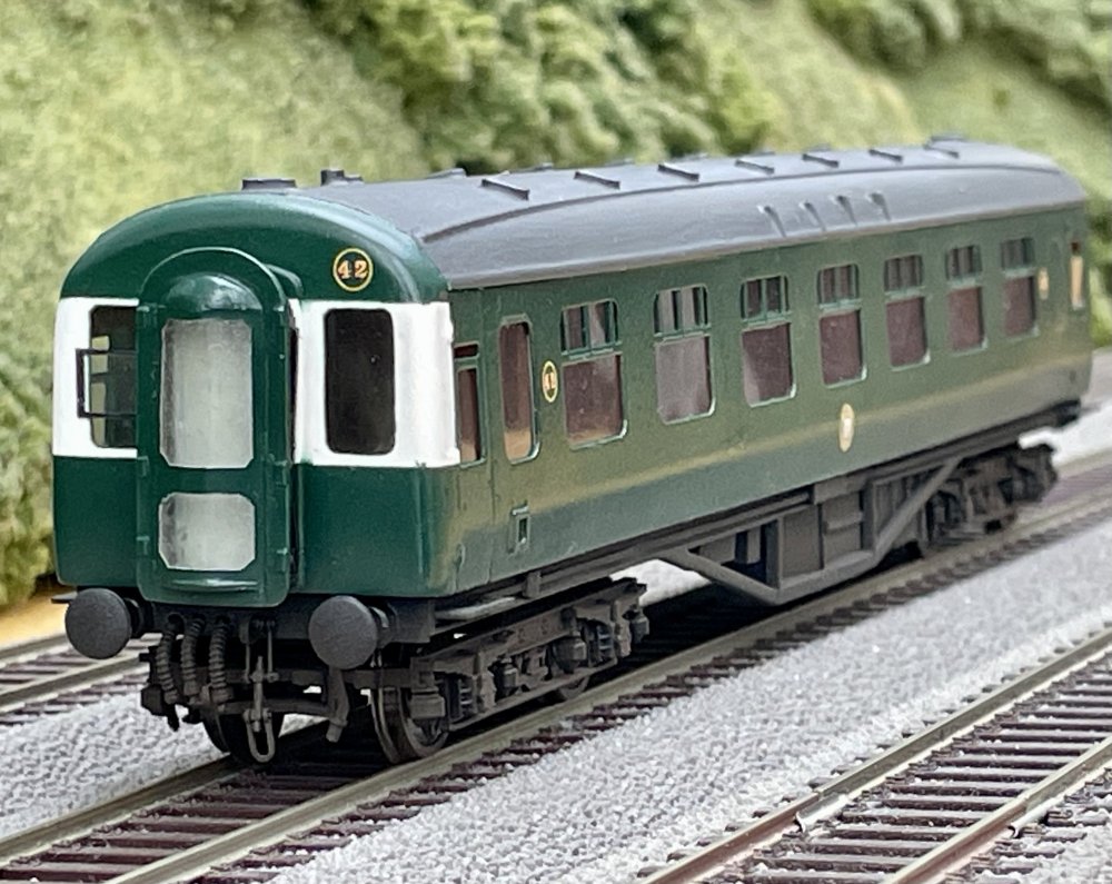

Darius43 Posted October 28, 2024 Author Posted October 28, 2024 I replaced the rather crude mesh grilles provided with the kit with etched brass grilles from A1 Models. Did the same for the Class 27. Cheers Darius 8
Darius43 Posted October 29, 2024 Author Posted October 29, 2024 Buffer beam details fitted. Cheers Darius 4
