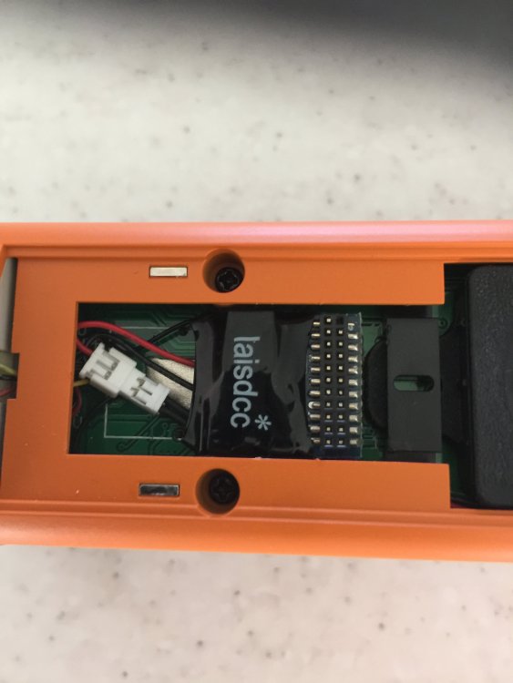

For those like me: 1). Lucky enough buy a fleet of these and; 2) Maybe cannot afford to put sound chips in all of them, I offer the following observations:
If. You cannot source/ afford the ESU V5 Lockpilot, a cheapie Lais 4 function + 2 Aux will control all light functions independently. But you will miss out on internal lighting.  This is an acceptable compromise for me, given I can source the Lais for 10GBP equivolent and will have non-sound in at least five locos.  Width space for the chip is tight in the A class, so had to shave a smidge off the chip silicon on both sides to slot in nicely.  Hope this helps someone...

Sorry mate, only just seen your post.  The lais is a six function chip ( 4 full and 2 logic) which is perfect for the A Class, with independent control of all head and tail lights.  The only thing you miss out on is cab lighting.  Maybe the Hattons chip is 6 full function?.
