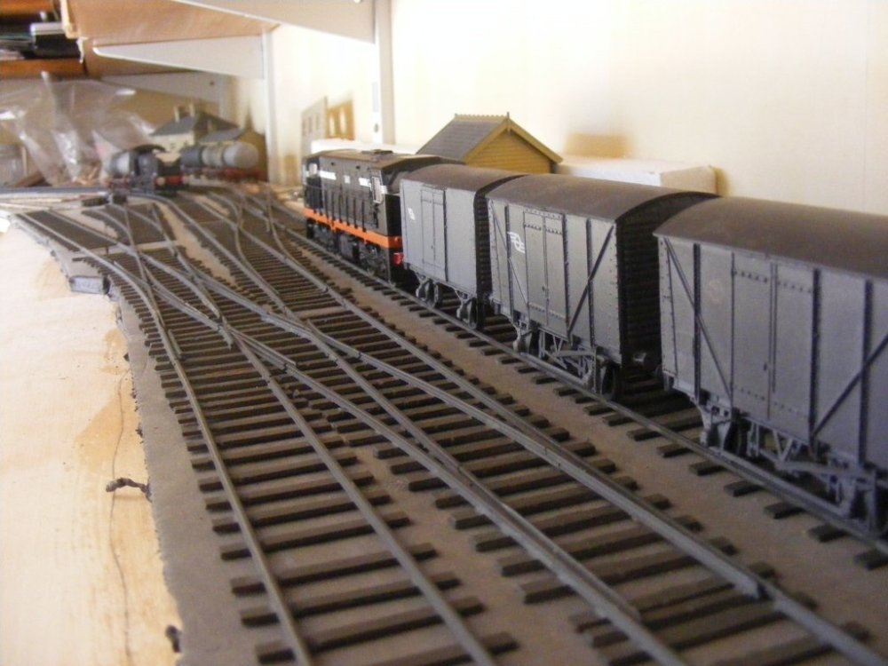

The original 2012 dock layout.  The inspiration was the North Wall Granaries area with the Dock lines straight a small marshalling yard for dock traffic on the left with the main running lines curving around past industrial buildings to another yard depot.
The main problems were that I could not get the double slips to work and that I did not allow enough clearance between the yard tracks on the left and the running lines.
Visually the abrupt transition from straight to curved track did not work, operation was likely to become tedious as I could not stage trains off line without a fiddle yard.
