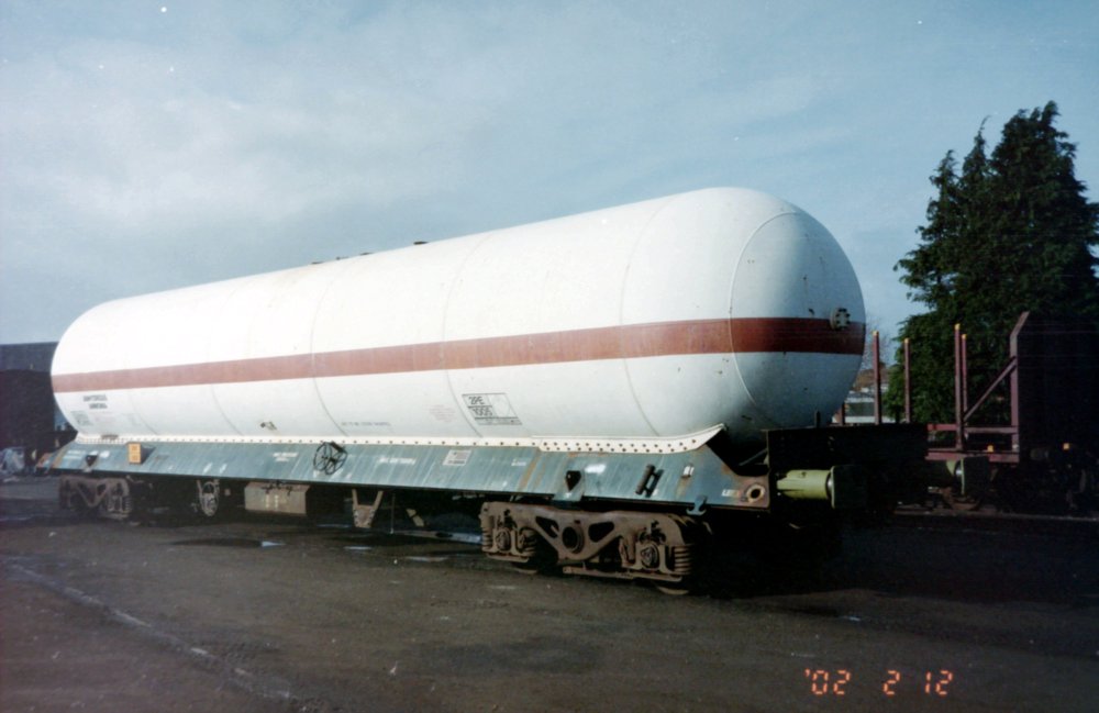

There were a couple of extra wagons which had differing discharge position cover boxes and a differing underframe.

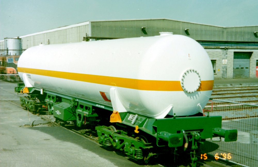

In the resources section on here is a drawing of the first batch.   The other drawing I have shows the later wagons built by Bombardier at its Wakefield facility but does not show number range - it might have been only a hand full as phots are not common of them in traffic, thanks to warb for phots above.

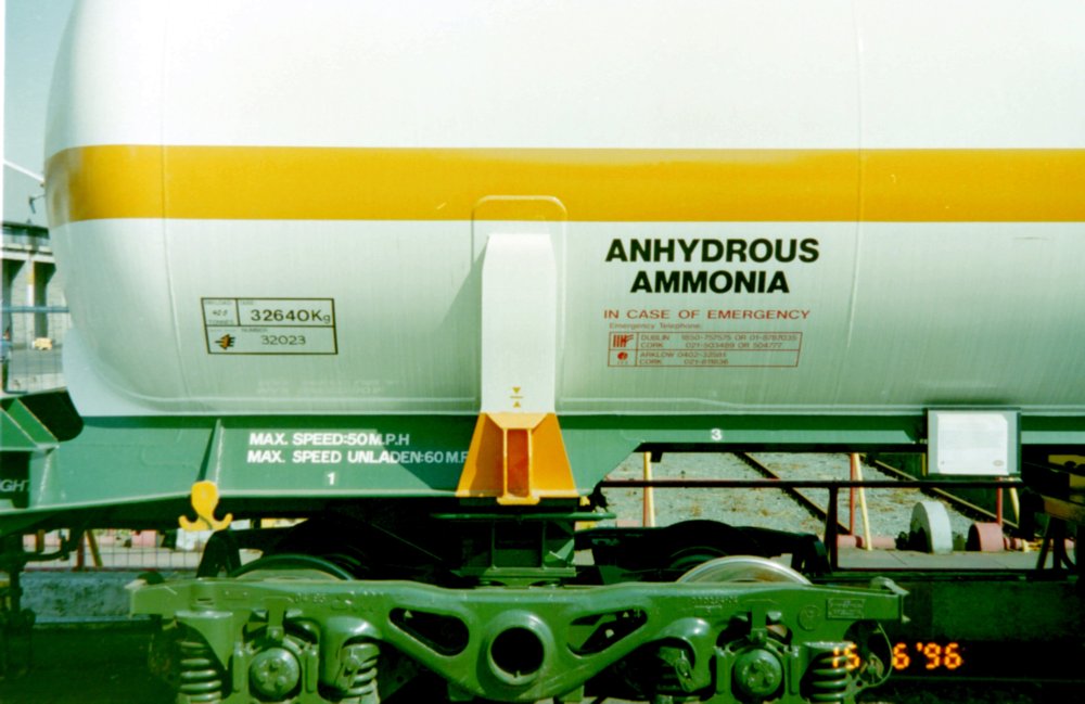

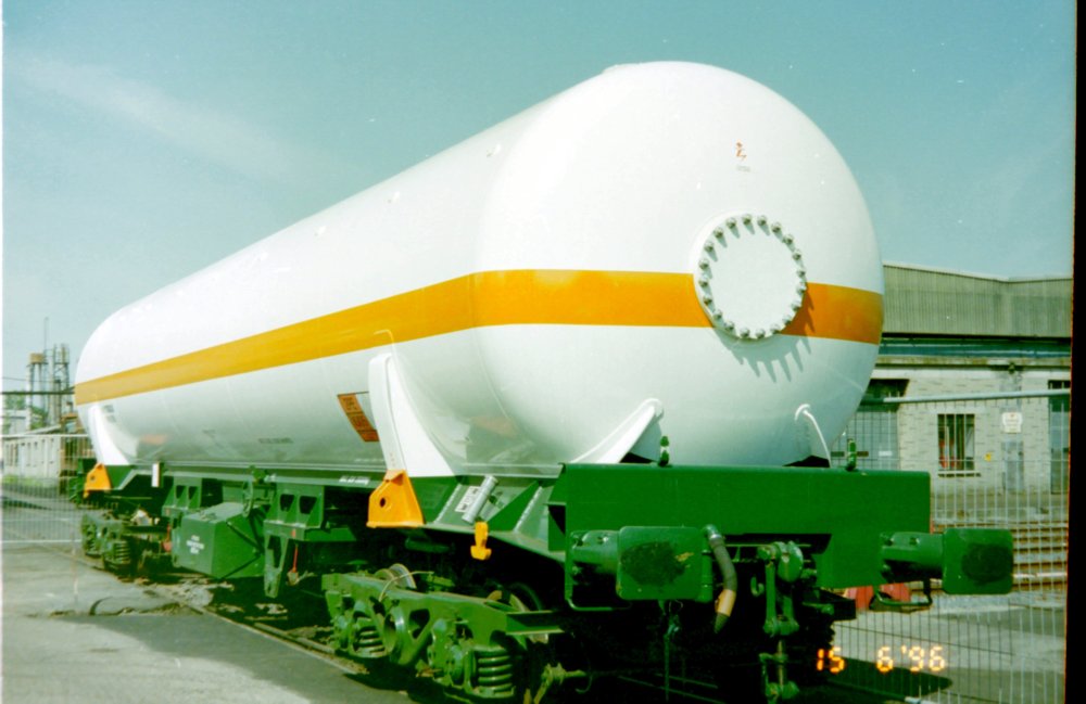

Wonderful photos there warb thank you for sharing!
