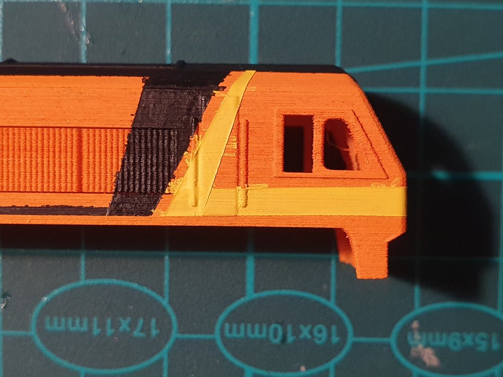

Afternoon all.
I'm painting the 3d printed n gauge model below. I started by spraying it using a can of RAL 2011 from Vinny Byrne. Then I masked off and brush painted the black and yellow. The paint bled a bit under the masking tape. I'll fix the orange bits by brush painting.
  • What's the best way for thinning the cellulose-based spray can paint for brush painting? Or can I spray directly onto a paint palette and brush without thinning?
Many thanks

Hi Peter,
Spray can paint is usually about as thin as it gets. You definitely won't want to thin it any further IMO. I would just spray it out into another container and brush but it might be too thin and run. Test on something else first.

Have to say I would be tempted after the orange and a black roof  to have done the other side and ends with transfers. I know it is a "cruel" enlargement but the furry nature of the model will hard to "gloss over."  I have used halfords spray bumper filler and sanded back so the filler is in the groves - on one GW railcar I did this three times!  The print material is very hard to sand so filling is the only way forward I think.  I guess an SD40 chassis will give all the bits needed.  The Dapol and latest Farish coaches  give a good basis for stock and the MK1 a starting point for a gen coach.

As Robert says- the furry nature of the model will have it's touch up problems, I would go with the thickest paint (leave it in the palette to dry a bit after spraying) to cover the black runs. Thin paint from a brush might do the same thing- running into the black! Maskol fluid could be used on the edge of the black line to stop running if it happens.
Cellulose or Universal thinners is for cellulose paint.....

In future, after masking, paint some of the base colour on the spot you want the other colour or a clear varnish (matching if your base paint is matt/gloss/satin), that way you won't get any paint bleed.
