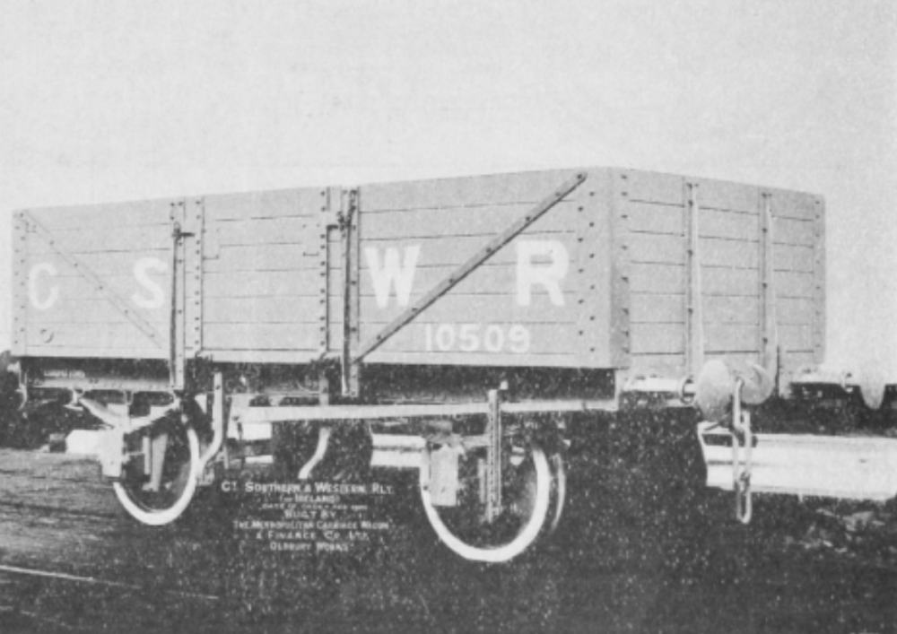

Killian Keane Posted June 30, 2023 Posted June 30, 2023 Steel underframe open goods wagon and goods van built by Metropolitan Carriage and Wagon Co in 1922, identical underframes, 10 ton capacity each 6 1 Quote
Mayner Posted July 1, 2023 Posted July 1, 2023 3 hours ago, Killian Keane said: Steel underframe open goods wagon and goods van built by Metropolitan Carriage and Wagon Co in 1922, identical underframes, 10 ton capacity each A bit of self-promotion JM Design produce models of the 1917 Open Wagon and Van in later GSR/CIE condition in CKD (completely knocked down) form. The principal differences are that the Open is on a later GSR design of underframe with open W Irons and both types of wagons are fitted with heavier self contained buffers. If anyone is interested I can supply the Open Wagon body with the GSWR van chassis for modellers interested in reproducing the opens supplied with "plate back axleguards" by Metropolitan and other builders to the GSWR, Bandon, Midland and other Irish companies following WW1. High quality spindle buffers with blackened brass heads are available from Dart Castings in their MJT range, 1 Quote
