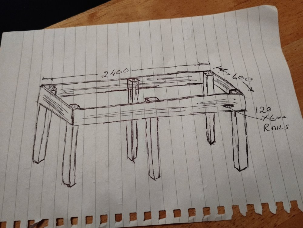

derek Posted January 3, 2024 Posted January 3, 2024 22 hours ago, Keano30 said: Hmm that's a good question. I'm breaking it down into 1200x610 modules with 4 legs. I think I will have to assess this when I build the first table and see if it feels sturdy enough, but thanks for pointing it out I'll definitely take that into consideration. Diarmuid, 4 legs on each table will be enough if you put a rail going from leg to leg. 6mm ply would do for this as the ply will be on edge. Maybe 120 high. 6mm will be fairly light . If it was me I would make a 2400mm x 610mm frame with 6 legs, held together by the ply rails , therefore cutting down on the amount of legs/ weight. You could still place 2/ 1200 x 610 modules separately on these. Here is a rough idea of what I mean. Pardon the quick sketch. The 6mm ply on edge will be extremely strong and you could maybe recycle some from your old baseboards? You said you got treated timber so I am wondering if it is larch you got? If so, this is usually used for garden work and such. Just make sure it is well dried out before taking it into the attic. Also, one last point , with all that weight of timber going into the attic, can the joists up there take the weight?. Although the weight will be spread, if it is just the original 4x2s or 5x2s, you might have a problem. 1
Keano30 Posted January 3, 2024 Author Posted January 3, 2024 Hi Derek, the attic will take the weight as it had been prepared to convert into another bedroom prior to me moving in. As regards the 1200x610 modules I want to keep it that way in case I ever decide to move, it will be easier to get the boards through the access hatch. Also by having them at 1200 it will make the tables more rigid which is what was the problem on my first attempt. I will of course be putting diagonal bracing on all the tables to firm them up even more. Thanks for the suggestion though. I’ll be recycling the old tables using the old table plywood for back scenery upstands and the framing for the bracing. 2
