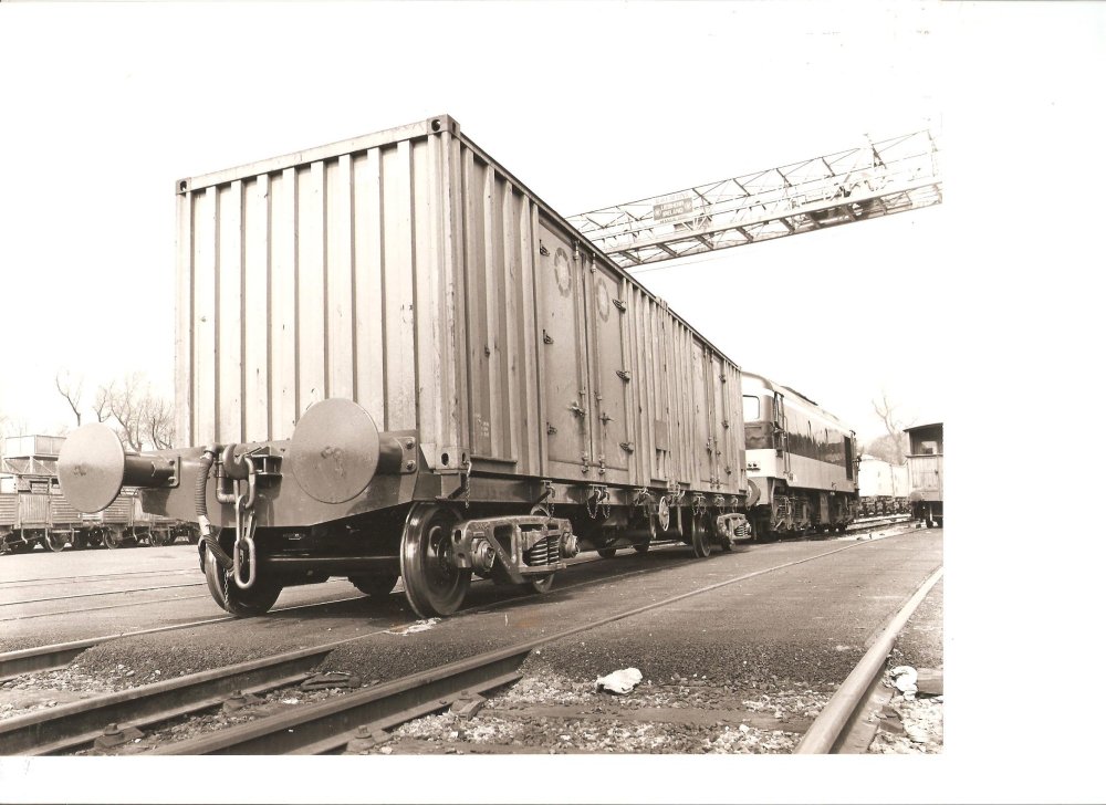

Ah, wonderful, many thanks! It looks like they have a full complement of mounting brackets for ISO spigots, and that the stakes can alternatively be slotted into these brackets. This picture has more stakes fitted than the Doyle & Hirsch image.
Then between or below the brackets, there are 7 chain/stake pockets each side. The steel floor's not so obvious from this angle, but is better shown in the Doyle & Hirsch image.
Now, should I start with an IRM model or an SSM kit? They've both got the right sort of frame and the wrong sort of bogies!

Sort of, but it's a bit more complicated.
The frame of the IRM wagon is the correct type for the 30001-30091 series with Ride Control bogies. But they have supplied it with (very nice) Sambre et Meuse bogies.
The SSM one is also the same hybrid as far as I can tell!
For the wagon with the floor I will definitely be replacing the bogies whichever model I start with. Cambrian do some which are pretty close, their code C72, but I think they might be 6' wheelbase rather than 2m wheelbase, and they're a bit more peaked in the middle. They'd probably look OK with the smaller wheels of a container wagon and my challenge will be to use the IRM wheelsets with rotating axle end caps in the Cambrian sideframes!
IMG_4158_1024x1024.jpg?v=1667334123
For my other 42' flats I will either change the bogies or modify the solebars.

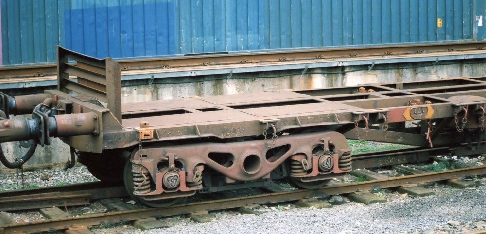

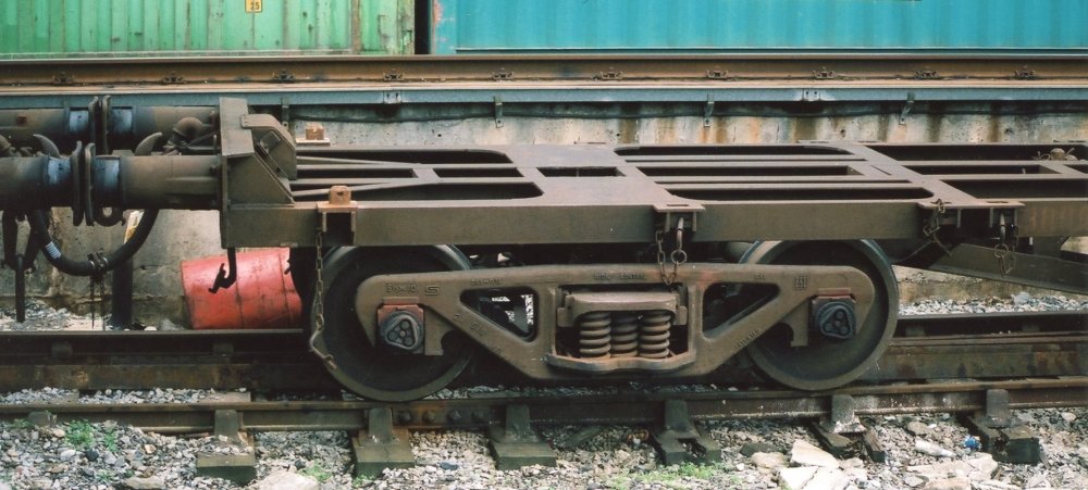

The 30001-30091 batch frames have a plain solebar over the bogies:
But on the later batch with Sambre et Meuse bogies, the solebar is cut away to provide more clearance for the larger bogie sideframes, with some reinforcing ribs:
Whereas both IRM and SSM have the Sambre et Meuse bogies under a plain solebar:

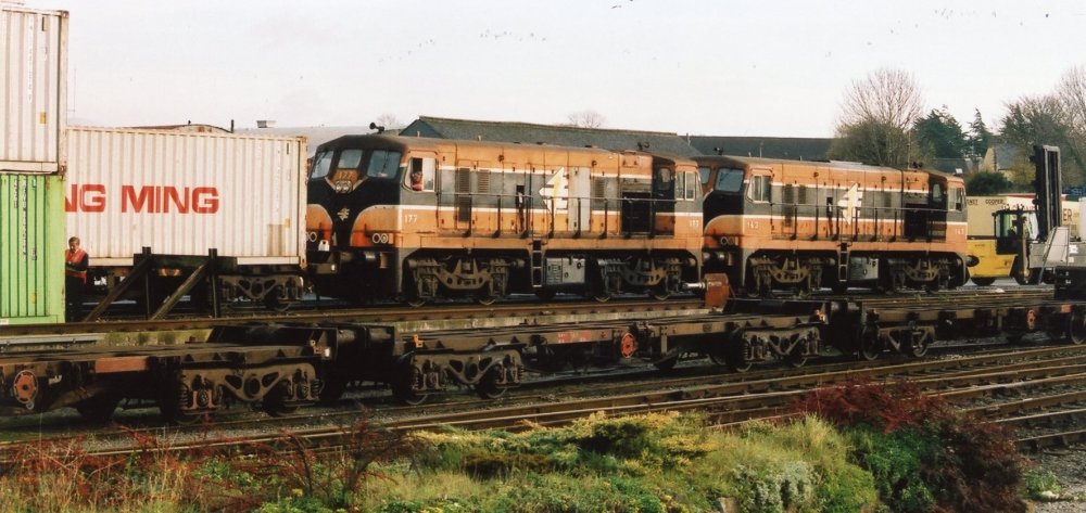

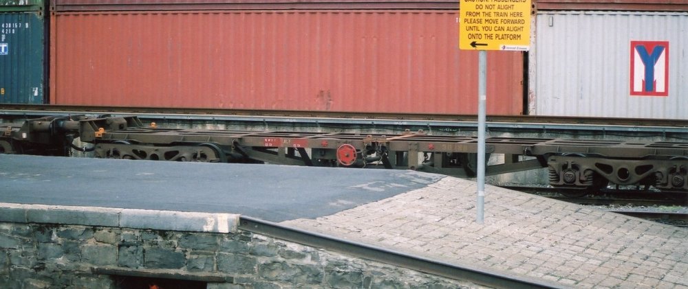

This photo from Jonathan Allen on Flickr also shows that some wagons had a different arrangement of the diagonal ribs betweeen the buffers and the bogie centrepivot. Easier to see if you click on the photo to view it in Flickr and then zoom in.
The nearer two wagons have Ride Control bogies and the arrangement of diagonals as in the first photo above (which is how IRM have modelled it) while the next three wagons have Sambre et Meuse bogies and a different arrangement of the diagonals.
017 south of Goraghwood

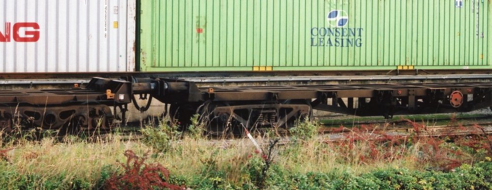

However, I don't think the alternative diagonal rib arrangement was used on all wagons with Sambre et Meuse bogies because both of these two seem to have the same ribe:
Many of the wagons with Sambre et Meuse bogies later had thin steel plates (splashers / spark guards) provided above the bogies, which concealed the type of diagonal bracing anyway.

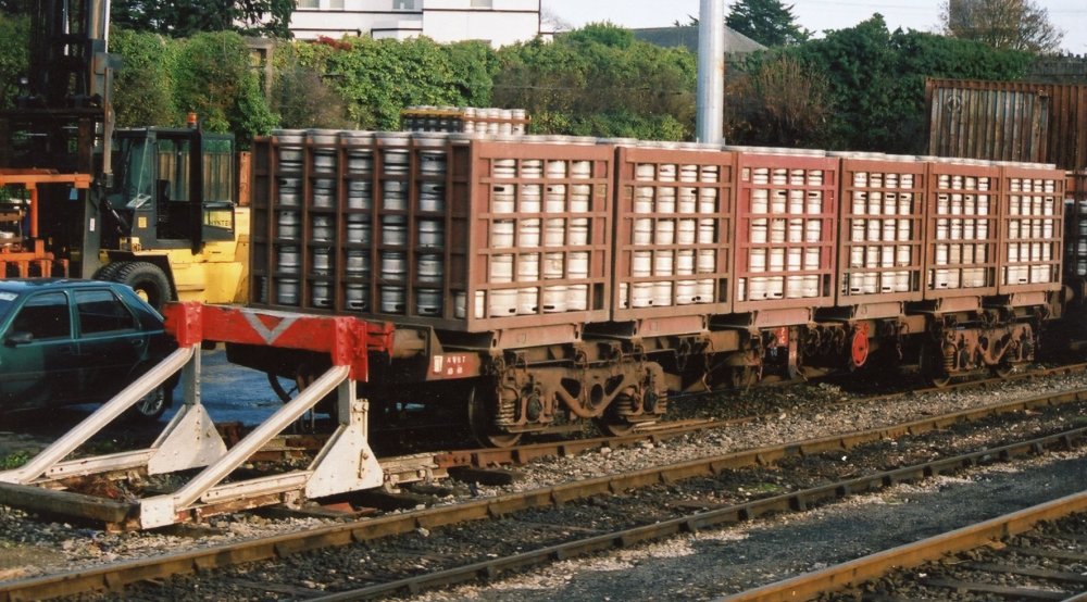

The IRM wagons also have more spigot brackets than any of the 42' wagons originally did; I think these are genuine as a later mod for carrying kegs, but weren't present in the 1970s-1990s period.

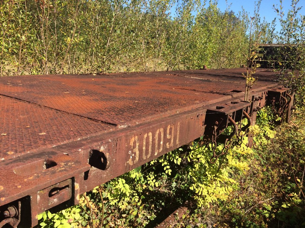

  • 0

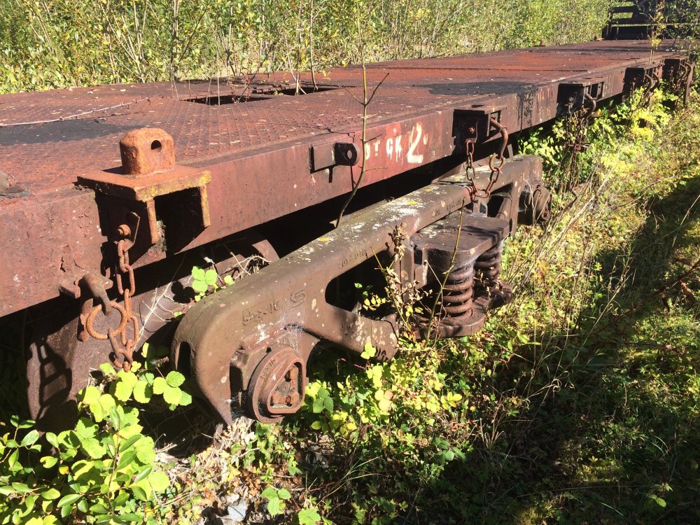

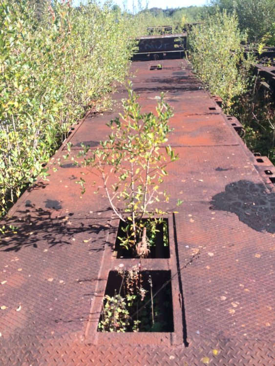

Ah, that's brilliant, many thanks!
I see it had lost its chain pockets by that stage - maybe just put into normal container-carrying service?
There are various suppliers of etched brass chequer plate, it's great to see how it was arranged on those photos.

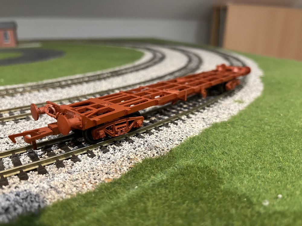

18 hours ago, flange lubricator said:

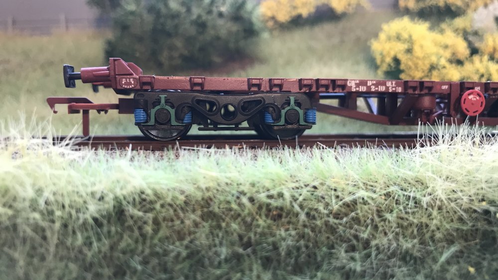

One of my own 30001 LP wagons (shapeways)  with Cambrian Model rail ride control bogies and round buffers as built in 1971 .
That looks great - and it's good to see what the Cambrian bogies look like in situ under a 42' flat and painted brown - they look right! As you mention, the round buffers are another feature needed for back-dating. I think all the 42' flats had round buffers initially, even the late 1970s batch with S+M bogies.

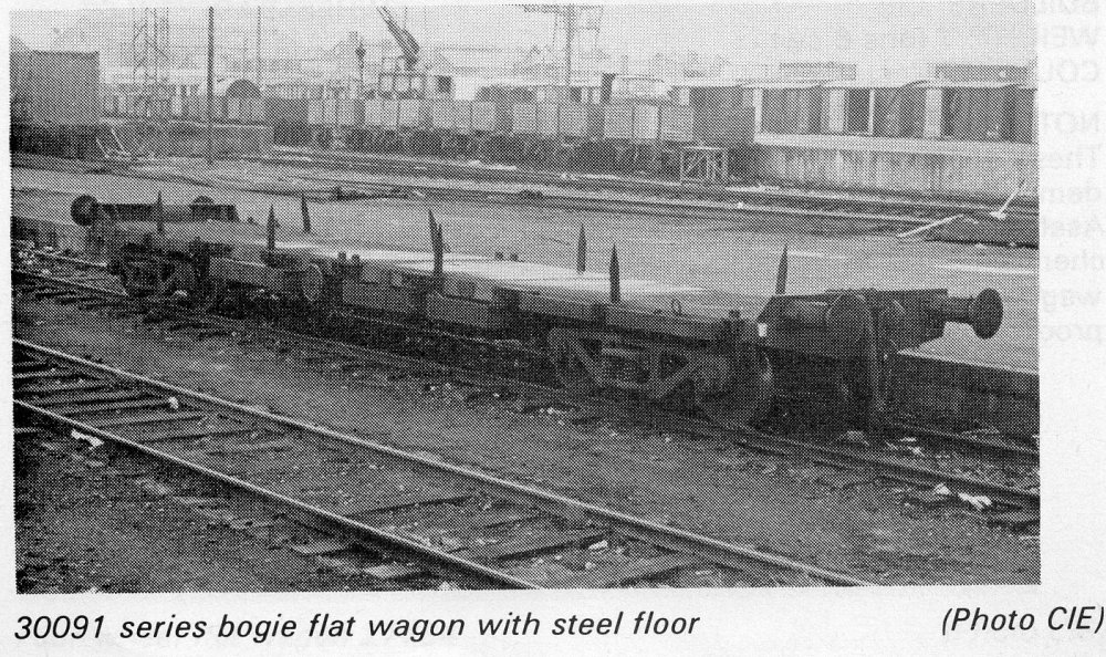

Here's a scan of the image in Doyle&Hirsch:
