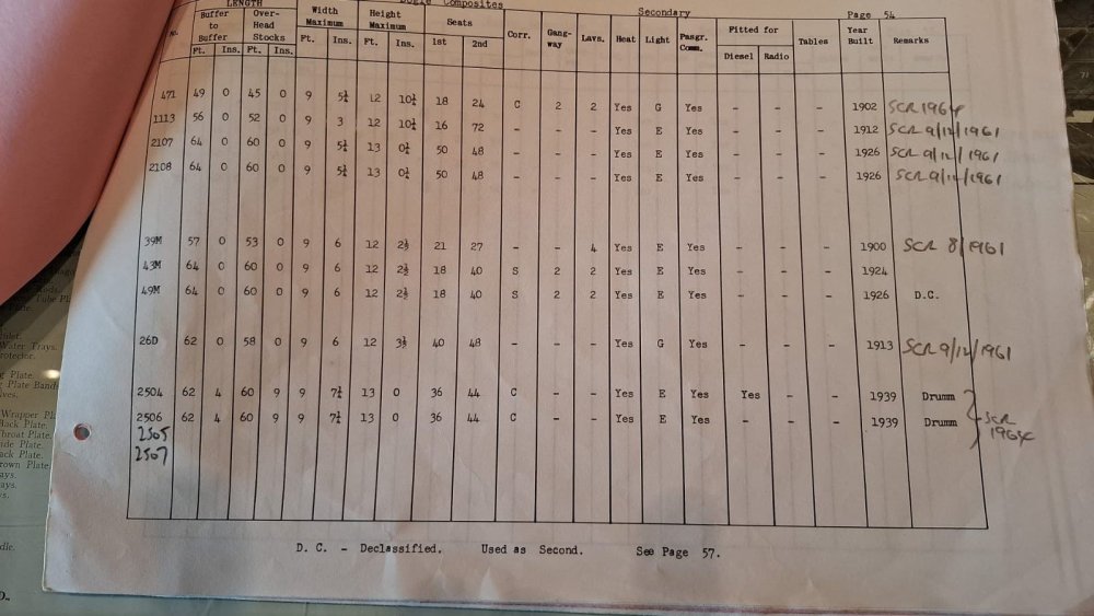

Mol_PMB Posted September 12 Posted September 12 Many thanks, very interesting. Is there any info on the numbering of the sets in later life, or of their period of usage as hauled stock? I’m trying to reconcile the vehicles listed in the 250x series in the 1961 carriage register with the original set letters. 1

Mol_PMB Posted September 14 Posted September 14 Many thanks for the extra information. There are some photos of the Drumm cars in later life on the IRRS Flickr: Older sets: https://www.flickr.com/photos/irishrailwayarchive/54253405400/ https://www.flickr.com/photos/irishrailwayarchive/54251301406/ Later sets: https://www.flickr.com/photos/irishrailwayarchive/53509040104/ https://www.flickr.com/photos/irishrailwayarchive/53509080753/ https://www.flickr.com/photos/irishrailwayarchive/53454365270/ https://www.flickr.com/photos/irishrailwayarchive/54250396627/ https://www.flickr.com/photos/irishrailwayarchive/53507224975/ https://www.flickr.com/photos/irishrailwayarchive/53570664018/ Note that these received two iterations of CIE livery, the original 1940s scheme and the simpler late 1950s scheme. Originally the sets were lettered but the individual vehicles seem to have also carried numbers in the 250x series - some are legible in these photos, even when in GSR livery as here: http://www.industrialheritageireland.info/BookReviews/Covers/Railway/The Story of the Drumm Battery Train.jpg It looks like sets A and B were 2500-2503, and sets C and D were 2504-2507. But they may not have been in order - based on the photos 2504 seems to have been in set D. The later sets were classified as secondary stock in the 1961 carriage register and are shown at the bottom of this page. I assume the articulated pairs were 2504-2505 and 2506-2507. Note that one of them is listed as being through-wired for AEC railcar operation, which would be plausible as these were used as suburban hauled stock at the time. Also several photos of 386: https://www.flickr.com/photos/irishrailwayarchive/53509041219/ https://www.flickr.com/photos/irishrailwayarchive/53507833502/ https://www.flickr.com/photos/irishrailwayarchive/53511681460/ https://www.flickr.com/photos/irishrailwayarchive/53508678098/ 1

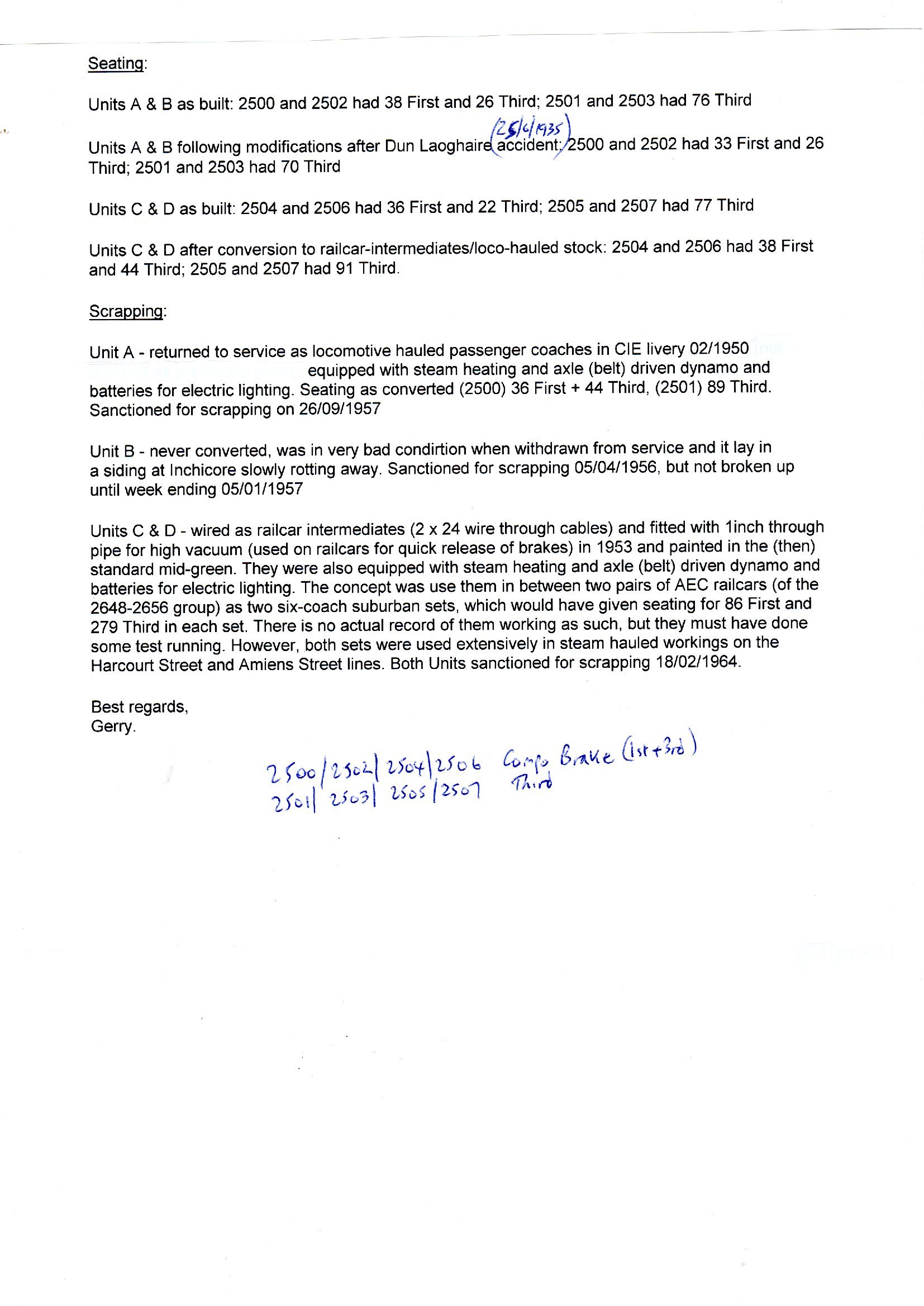

Mol_PMB Posted September 14 Posted September 14 1 hour ago, jhb171achill said: I’m not sure the de-batteried coaches got the later green livery. I seem to recall pics of them lying up awaiting scrapping in the older green livery (faded so badly you could see GSR maroon underneath!) Well, happily, you can now be sure they did. The photos linked above show both the later sets in the simpler green livery with a single waist line with '2' class digits on the doors, no snails. Some of the images are in colour, and they are parked next to an older coach in the older darker green livery with complex lining. 1 hour ago, Maitland said: Donal Murray's "Great Southern Railways" pictorial has a photo of 386, with the curved bit just visible at one end only - a bit odd as it presumably ran both ways. You can be proud of your ancestor- the design of C and D makes contemporary railcars (and most of those of 20 years later) look crude. Unfortunately I only get error 403 (permission) from flickr. You need to be an IRRS member to see their Flickr archive of nearly 30,000 Irish railway photos - highly recommended. 3 minutes ago, seagoebox said: some more info on Drumm cars.... Wonderful - that is very clear and detailed, resolves my questions and confirms the repaint in simpler livery. I shall update my carriage register spreadsheet accordingly. 1
