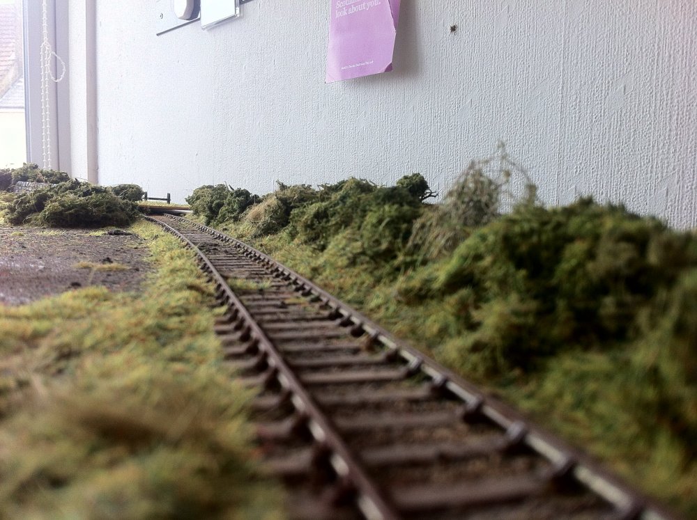

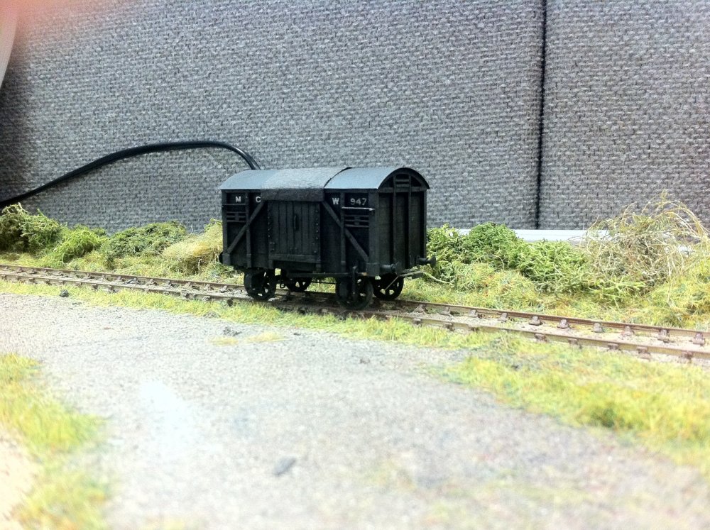

My small contribution to Irish Gauge modelling. At some point in the future I would like to do a complete layout but time and space are currently in the way. Plenty of plans but time to learn how to build a couple of locos and space to put any of the plans is currently limited. Oh the future...
The second picture includes a wagon constructed by Andy Cundick just to prove that the gauge is correct.

1 hour ago, Nestor said:
Thanks
it was built as an experiment in track building and scenery. It's since been updated scenically.
Nestor
