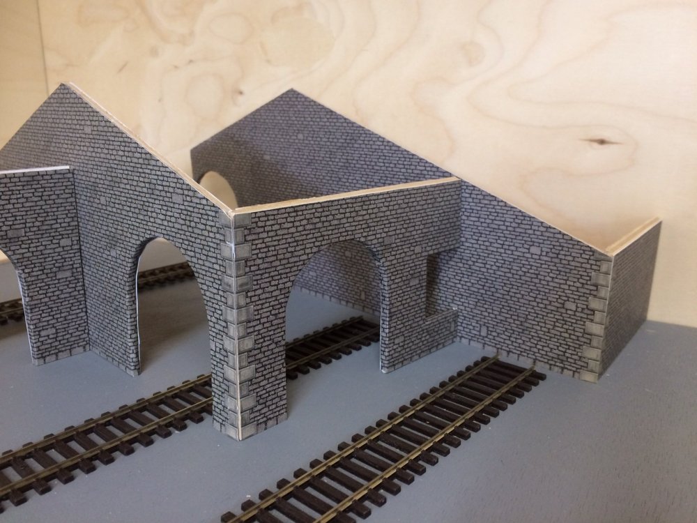

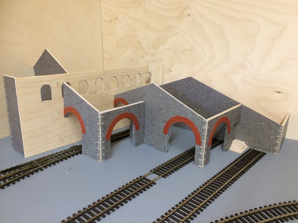

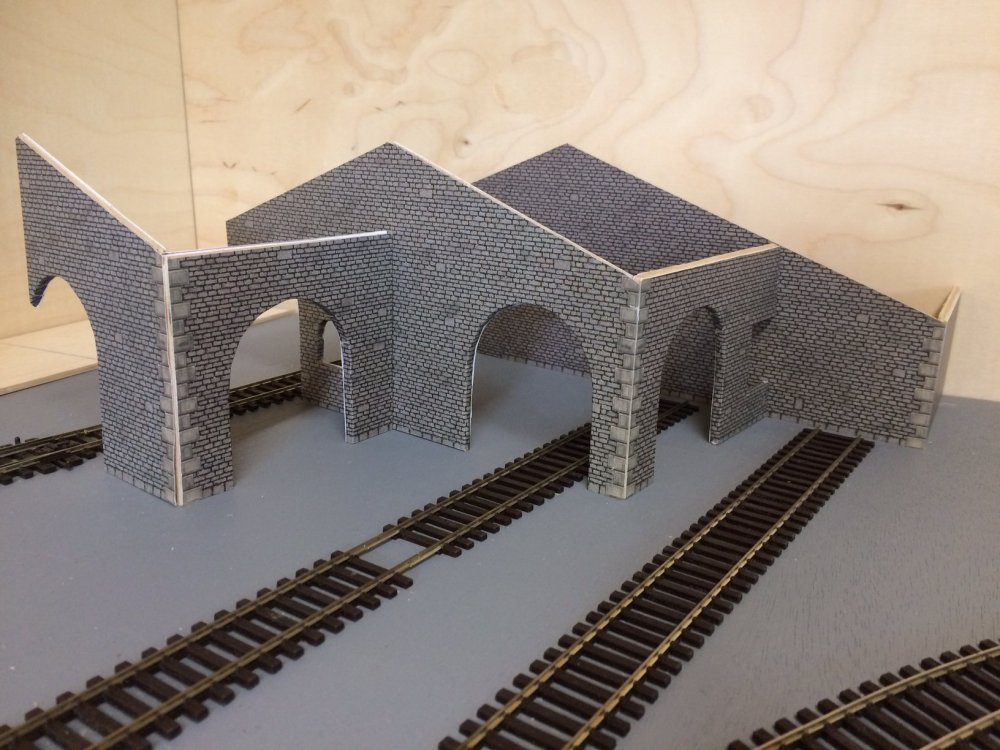

GNRi1959 Posted June 9, 2018 Author Posted June 9, 2018 (edited) John, I actually used the Metcalfe Semi-cut stone sheets on the Goods Yard store and I am really impressed with it. I applied it with 1-1 diluted woodworking glue and turned the sheets inwards around the arch openings. I then applied stonework to the rear sides also that are open and visible. I thought it saved all the hassle. I just need to find a similar product for the corrugated roof and roof lights - may need to kit bash to get it right. Heres an example of the progress so far, now these sections are free standing, nothing is fixed together yet. Edited June 9, 2018 by GNRi1959 3

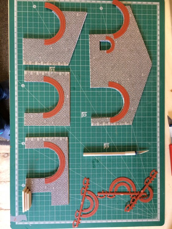

GNRi1959 Posted June 10, 2018 Author Posted June 10, 2018 Adding Wills Scenic red brick detailing to the Goods Store arches 1
David Holman Posted June 11, 2018 Posted June 11, 2018 There is a school of thought that says in smaller scales, well printed papers work just as well as scribed or embossed finishes, especially from normal viewing distances of 60-90cms. What does stand out with Metcalf's parts is the corner joint. Easily covered with individually cut pieces of card and folded round the corners.
GNRi1959 Posted June 11, 2018 Author Posted June 11, 2018 (edited) David, I really do like the look at feel of the Metcalfe papers and card. I think they could have put a bit more thought into the design of the corner quoins. When my sections are glued together I don't think they will be as obvious and if I have to I can 'tone down' the white paper seam that is always a give away. As I said in an earlier post, the parts are sitting loosely. When the Goods Yard is populated with wagons, people and all the other things that bring a Goods Yard alive, I won't be worried too much about the actual building. Thanks for your comments. Edited June 12, 2018 by GNRi1959
