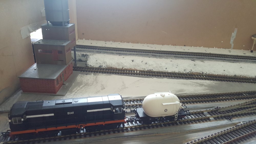

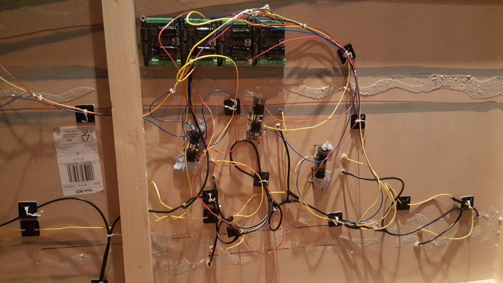

richrua Posted October 18, 2018 Author Posted October 18, 2018 I've now added in the point motors and tidied up the wiring a bit. The point motors are in good nick and recycled from the attic layout. Also recycled is the expensive ish but very useful DCC concepts point motors controller that lets me run the points off the NCE powercab. Bit of a test run with some stock too. 5

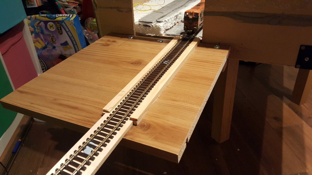

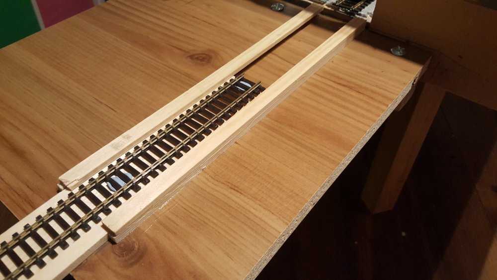

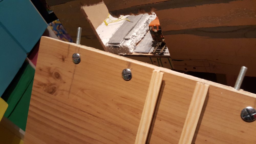

richrua Posted October 24, 2018 Author Posted October 24, 2018 Just been working on a simple system for allowing me to use small cassette s to add/ turn/ remove stock. I settled on a slide in idea. The guides should keep the track aligned, which will be fixed to the wooden slide part of the cassette. The cassettes won't be long - about 2 ft. The supporting board just slides in on bolts for easy removal, I really want to keep this layout to a limited size. Crocodile clips will do for power to the cassettes for now, probably upgrade to a more permanent power system at some point. 1
