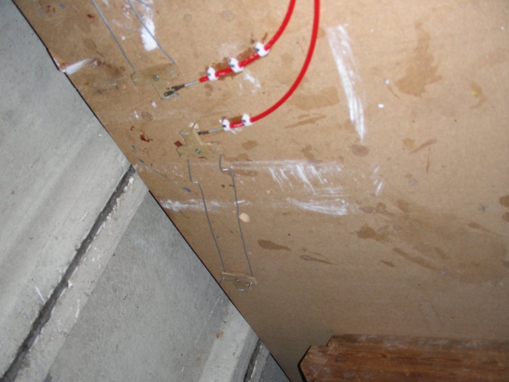

If it isn't, I've successfully run 'sympathetic' points by driving the distant one mechanically from the driven one.
It looks a bit of a bodge, but it ran remarkably reliably.
A bit of 'spring' in the connections helps to be sure that the distant one is 'home' before the driven on, but that still has the scope to get 'home' too.
