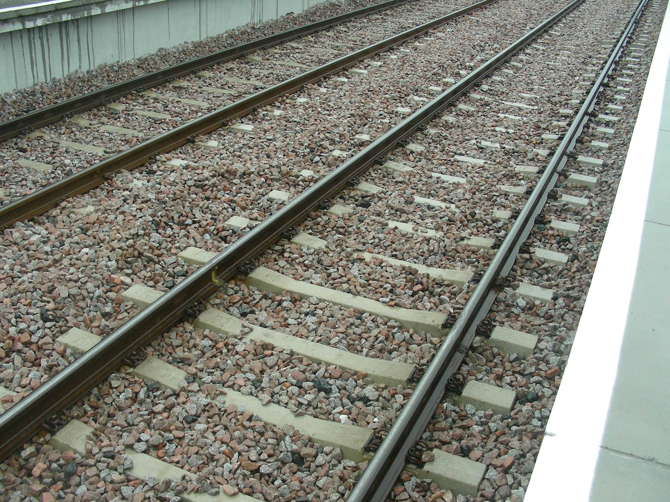

It can also be worth studying the track in a similar sort of real-life location - the colours can sometimes be quite different from what you might imagine - this is the main line through Ballybrophy, just before it was replaced a few years ago..

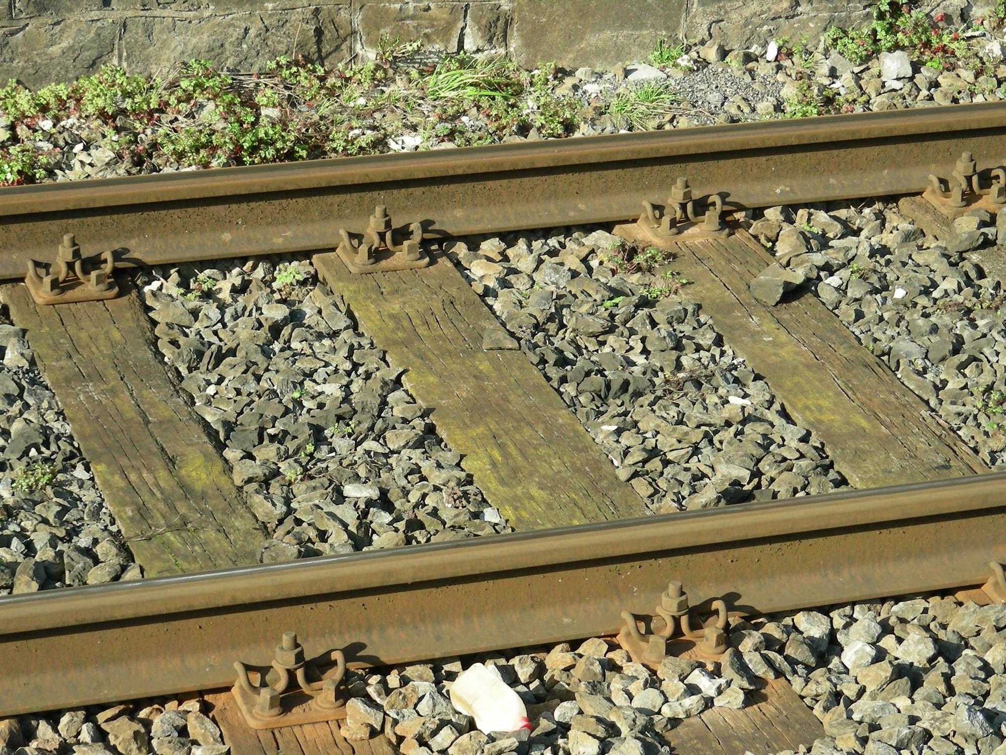

Very true Jim. Track rail in sidings is always a different texture and color when compared to mainline track. Wooden sleepers always have a tiny rusty hue around the chairs or clips that can run into the sleepers. Natural daylight and taking photos at different times of the year can also make the appearance of the color look like it has changed. It's always a good idea to give some thought to which season of the year you wish to set your model in.
Just looking at the example of track that you have posted Jim you can see Browns, Grey's, Beiges, Silvery hues etc and some rotting of the sleepers beginning to occur.

And there's strangely little evidence of oil drips - the concrete sleepers seem to show this much more, maybe because it doesn't soak in.
Here's the new track, before it got oil-spots in the centre of each sleeper. The cute pink ballast might be a bit awkward to replicate..
It was wet when this was taken, but the new rails were quite a different colour, even ignoring that aspect..

Jim a lot of that pink colored ballast is widely spread on the railways in Scotland and it's all a matter of which geographical region the stone is quarried in. Naimshire Modelling sell a nice pink shade on their website in various grades. Mig weathering powders are available in a concrete variety and look really good when used with concrete sleeper track.
Another alternative is to very lightly spray some Plasticote suede over the concrete sleepers before weathering as it gives a nice textured look to the sleepers.
Rich,
This one - http://www.nairnshire-modelling-supplies.co.uk/b70-fine-iron-ore-red-granite-ballast-p-995.html ? That'll save me grinding up the bits I pinched from the pile by the car-park..
