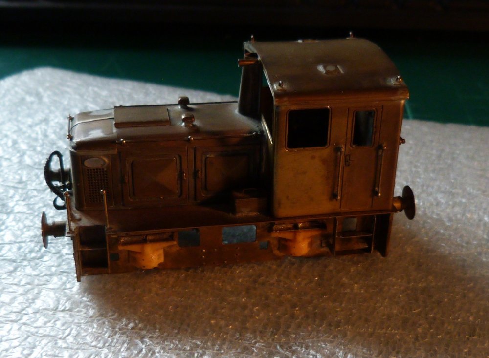

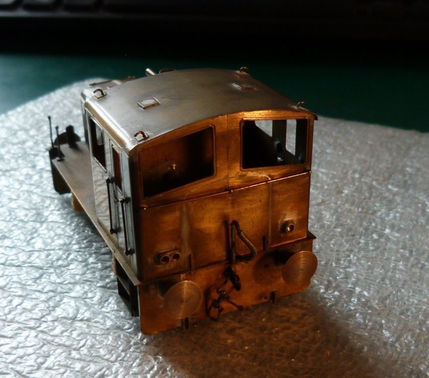

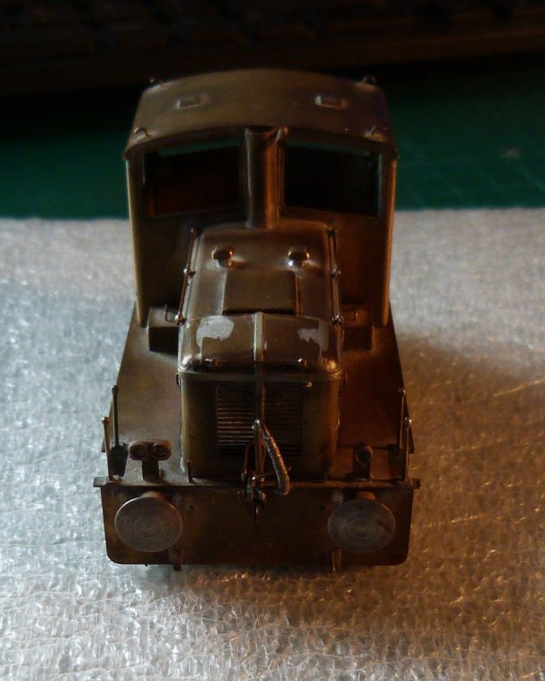

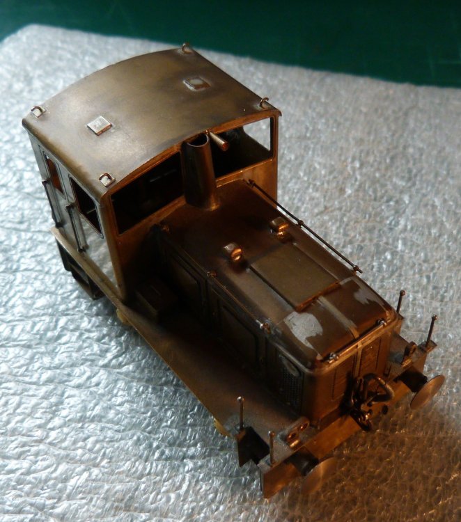

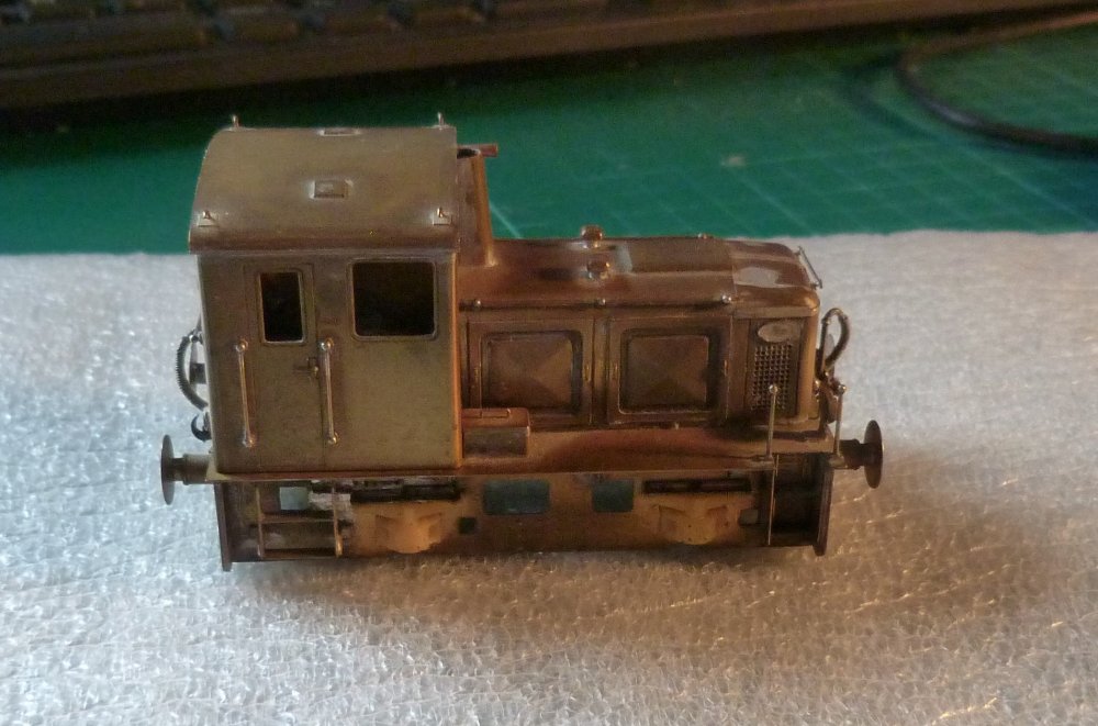

0 WRENNEIRE Posted August 10, 2019 Posted August 10, 2019 Sorry about the pics, the world just went dark as I was taking them 3 Quote
