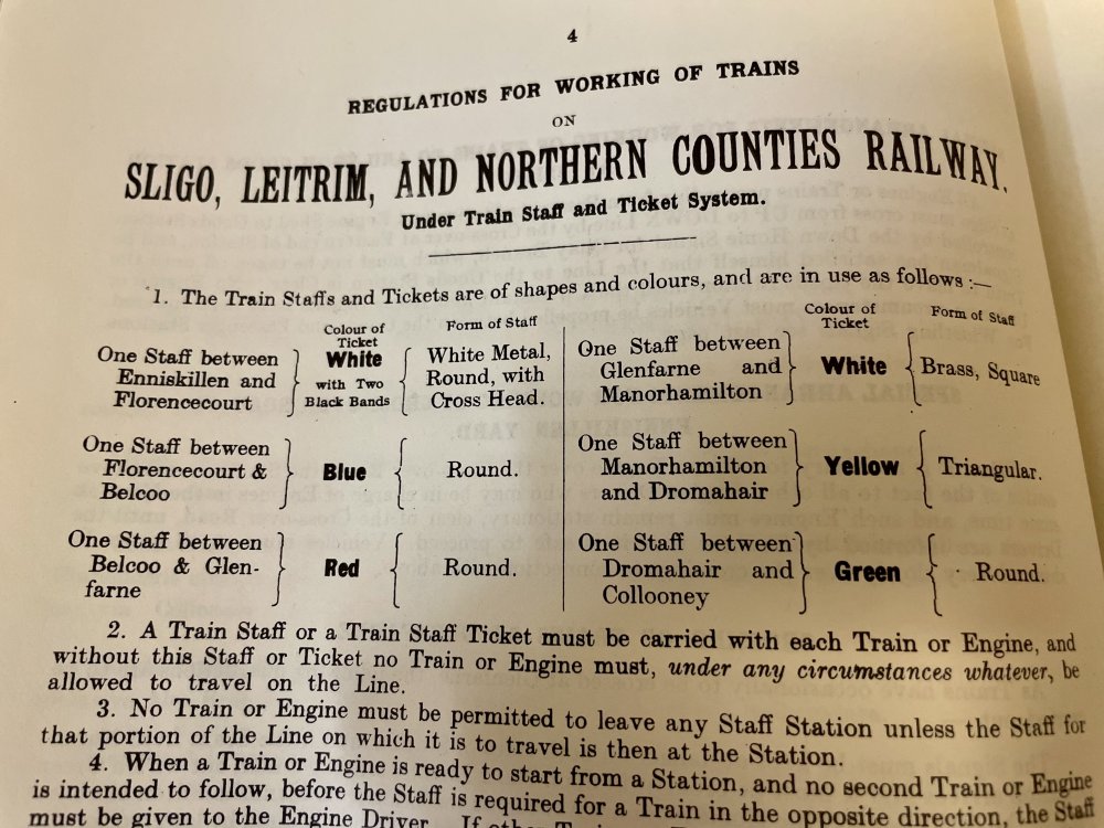

The rings are indeed significant. They reflect the ‘configuration’ of the staff to ensure that the crew of a train have the right staff for the section - especially significant where a line was made up of numerous consecutive single line sections. Often trains were worked by ‘staff and ticket’ and the crew might only see the staff and be given a ticket. It would be  easy for staffs to get mixed up without a means of differentiating them, which is what the rings do - as well as their mechanical function in the instrument, explained well by Dhu Varren below.
The crew can easily see if they have or are being shown the correct staff for the section they are entering and haven’t just been given back the staff for the section they have just left !
Assuming, of course, that they bother checking. At Abermule in 1921 they didn’t: ..https://en.m.wikipedia.org/wiki/Abermule_train_collision (it was a tablet rather than staff in this instance but you get the idea).
This is how the SLNC differentiated them...
