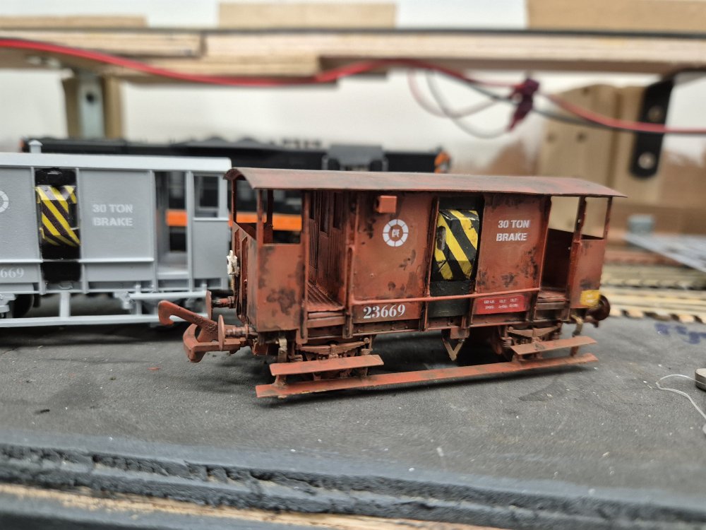

  9. Brake van finally finished. It's been great fun building and painting but I now have a new found appreciation for all the time and effort a RTR model saves me. They don't seem quite so expensive now! I needed to wedge a wire into the battery holster to keep the batteries from slipping out, works well now. 20260115_194637.mp4
  10. Started weathering the brake van, not finished yet. Still haven't gotten around to fixing the light, the batteries appear to be loose in the metal battery holder

  12. More progress on the SSM brake van. The roof was tricky to get on. Transfers and weathering next. The IRM red tail lamp was working a few days ago but won't light up today, hopefully I left it on overnight and drained the battery. Otherwise I may have broken it somehow.

  14. Finally got a chance to do some more soldering to the SSM brake van. Ready for paint now

  21. Thanks Paul, I like your answer best cause it's the easiest to model! So I might try to model: no lights in side lamps and one red tail light at rear, on left or right. I have some of the IRM tail lights which would work well even though they are a mite too large. Or if I understood west cork properly even those newer tail lights were sometimes used on brake vans.
  22. Thanks @Westcorkrailway. I know the tail lamps were there but were there usually 1 or 2 tail lamps used? If the train was reversing would they change from red to white? Did the side lamps mirror the colour of the tail lamps? Were side or tail lamps more commonly used?
  23. Hello all, I'm looking for info on the placement and usage of tail lamps on cie brake vans. I'm making SSM's lovely brass kit and considering adding working lamps, tail or side lamps. I might either use IRMs wand operated lamp kit( a bit too large for a brake van probably) for tails or if I'm feeling more ambitious try to make my own from leds, resistor and capacitator. On that note if anyone knows any useful threads online for adding led lights to any brake van that could be a great help too. Here is my effort so far next to CK prints lovely RTR version.
