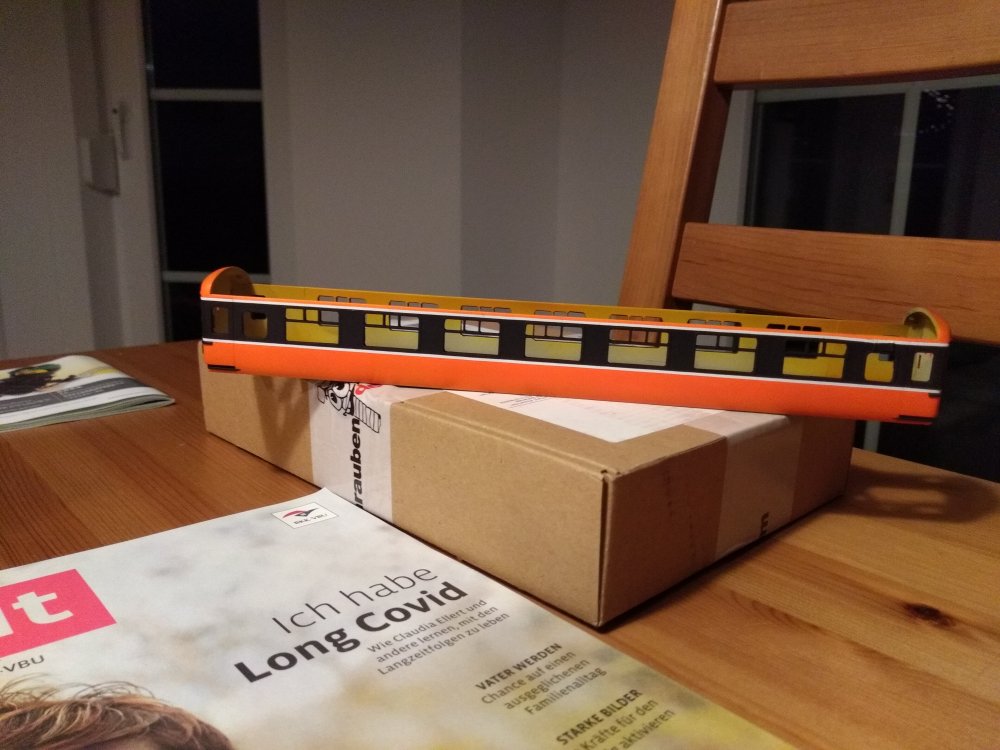

I already tried it and found it a bit too orange compared to anything available RTR (it's much more orange than say the Bachmann MM mk2a's). This one was done with it but without a control in the picture it probably won't help much:

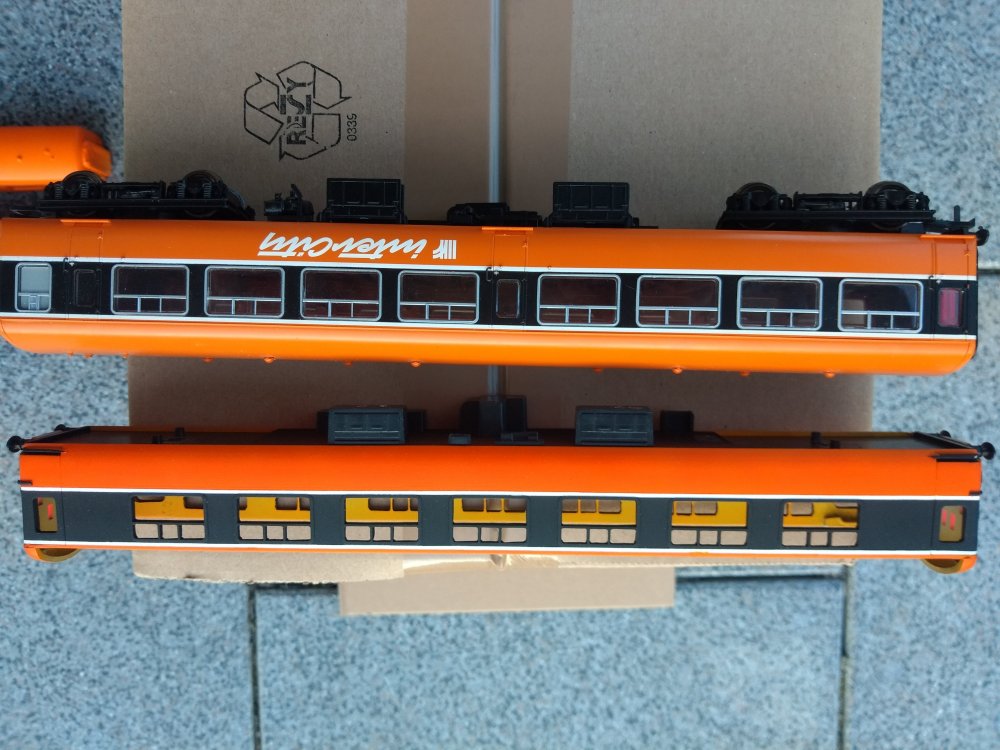

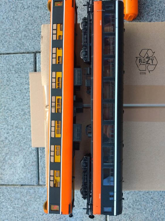

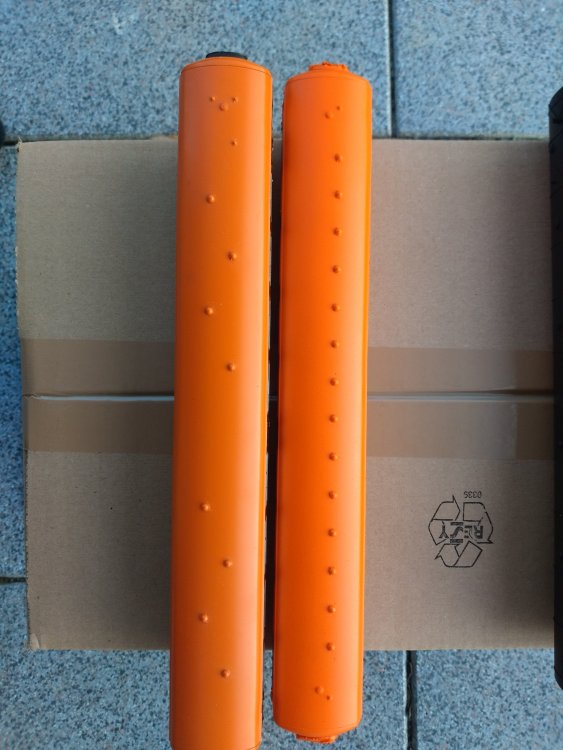

I caught the last bit of evening sun to take some quick comparison pics outside. The coach body is painted in Vallejo game air fire red.

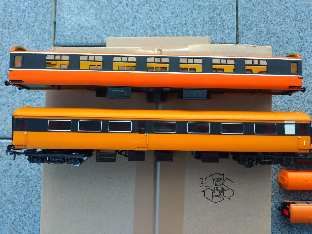

For comparison this is RAL 2011 from Modellbau Oesling on the right, sprayed over a Vallejo air white on a Bachmann mk2a FK. On the left is a MM Bachmann mk2a SO:
In the 3rd photo it is actually the MM coach that is an incorrect colour, far too much yellow, as have all the MM mk2d coaches been.
Yeah it's a shame they are so far off. The way I look at it, either you stick with the wrong shades and try to maintain commonality at least within the different types or you respray the whole lot, which is not particularly appealing to me.
They don't look too bad a match.
The MK2d is Supertrain and the MK2a is IR so they normally are different.
The supertrain livery is usually a bit more brown.
