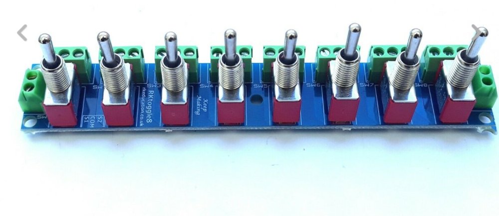

These are switches I got made up for my points, off ebay

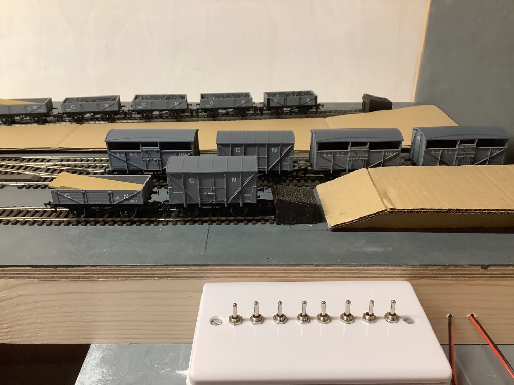

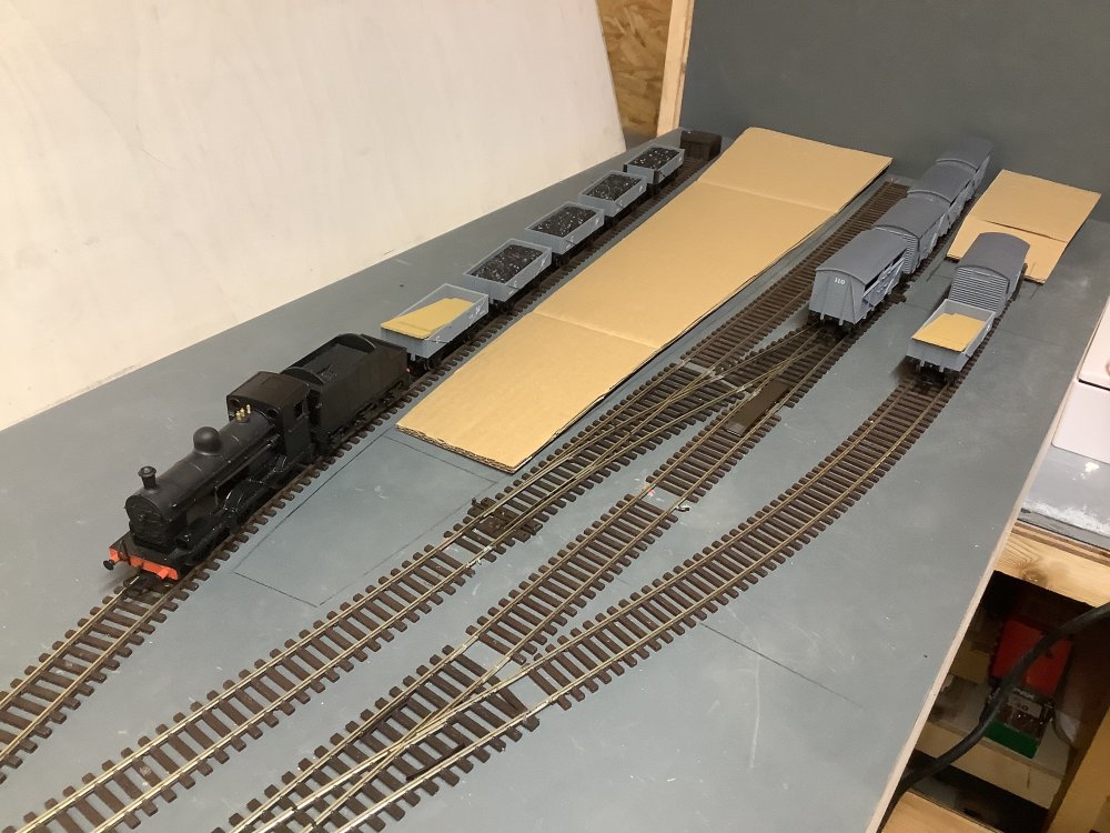

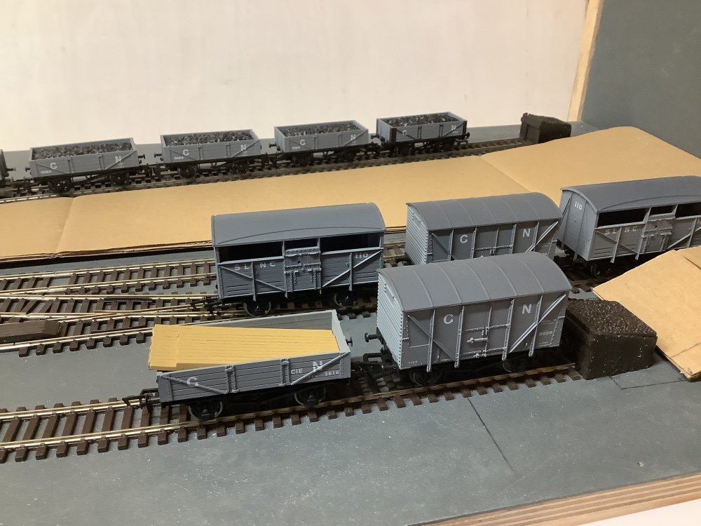

Having spent several weeks underneath the layout, wiring point motors and bringing everything back to my switch module,  I started laying uncoupling ramps and mock up cardboard platforms. The mock up platforms give me an idea of what works best before I build them. I’m awaiting ballast, which is due shortly. Although the layout is called Fintona Station, it may in time become a small Irish shunting layout with no name.
  • Like 7
That is looking absolutely perfect, Tony, EITHER as actual Fintona, or a generic shunting layout, for which the real Fintona track plan is actually ideal anyway.
14 hours ago, Northroader said:
Shaping up really well, just tell me the electrics all work o.k.?
Yes, the electrics do work very well. The only problem I encountered was devising a sensible plan to bring seven point motors back to a switching system I knew nothing about. In the end it took two attempts to wire it.
