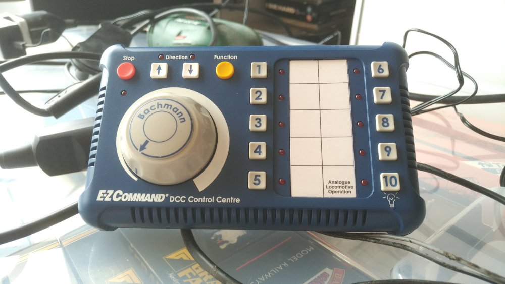

DJ Dangerous Posted July 28, 2023 Posted July 28, 2023 Morning! Do any members have a standardised fuction list that they use across all of their various Irish diesels? As in, rather than having a different function list for each class, what do members find best to use universally? I understand that it will be an entirely subjective topic for each person. My controller has ten functions, and I'd like to make the most of them. So far, I'm only using: F0: Directional White Marker Lights F1: Engine Start-Up and Shut-Down F2: Horn F3: Other Horn F5: Drive Hold F8: Locomotive Brake I've tried the F7 Flange Squeal but am not sure where and when it should be used. So F4, F6 and F9 are currently unused. I guess directional headlights would be a nice function, as would coupling sounds and directional red marker lights. Also, I don't understand the difference between F5 (Drive Hold) and F8 (Locomotive Brake). Both seem to do the same thing, F5 without sound and F8 with sound. It's only a short end to end type layout, using the word "layout" very loosely. It's just a piece of wood. I've attached here the revised default A Class DCC Function List for reference. Any thoughts and reasoning are much appreciated. 18.10.2021_-_A_Class_EMD_decoder_functions.pdf

DJ Dangerous Posted July 28, 2023 Author Posted July 28, 2023 3 minutes ago, Sean said: THIS How do I change "notches"? Do all ESU decoders arrive pre-set to loco no. 3? Tried a MM 567 decoder in 132S and it's also set as loco no. 3, as 054 was. The MM default function list is quite different to the IRM default function list. I had suspected this, hence starting the thread.
Sean Posted July 28, 2023 Posted July 28, 2023 (edited) the notches are the rpms the engine runs at. so notch 8 being full throttle and notch 1/2 being barely moving. everything comes as 3 by default, theres probabaly an easy way to reprogram it using that controller but youd need to check the manuals, i usually do it by changing cv values with my laptop. I would avoid using the analogue mode on that controller as damage can be possible quite easily. once you have this all worked out you wont want to go back to dc operation at all https://www.bachmanntrains.com/home-usa/images/E-Z_Command_instructions.pdf Page 3 Edited July 28, 2023 by Sean 1
murphaph Posted July 28, 2023 Posted July 28, 2023 @DJ Dangerous has a Lokprogrammer AFAIK. That would be the weapon of choice for changing anything on an ESU decoder. Waaay easier than fiddling with CVs anyway. Once click and you're done with a Lokprogrammer and it's much less likely that you will mess something up. 1 1
