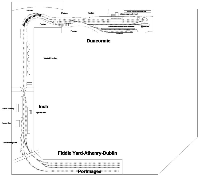

Duncormic N gauge end to end 1979-1982.  Probably one of my best and most complete layouts, built in my bedroom while living in my parents house in my early 20s the layout was dismantled following a house move and never re-erected.
I changed to N gauge out of frustration with my attempts to build a OO gauge layout in the box room of our home and to build Irish steam and diesel locos on rtr chassis. Inspired by Brian McCann's Bagnalstown layout and Chiltern Green the reasoning was that it would be easier to build a layout that met my requirements in N than OO and that I would be less tempted to attempt to attempt to scratchbuild/kitbash or modify N Gauge locos and stock to resemble Irish locos and stock. The first part was true in that I found it easier to build a more realistic looking (to me) layout in N than I could achieve in a similar space in OO, the second part was false as it wasn't long before I began modifying British and American rtr locos to look like Irish locos and re-painting/kitbashing stock.
After a false start with a single track continuous run layout on an 8X2' folding baseboard based on Kilmessan Junction, I shifted to a U shaped end to end shelf layout around the walls of my bedroom with a medium sized terminus and a small junction station inspired by buildings at Foynes and Ardfert on the North Kerry line transported to County Galway.DuncormicNGaugeLayout.thumb.jpg.a978afaa1b9552c66eea77f903da05a6.jpg
The terminus and fiddle yard were capable of handling a double headed 5 coach passenger train or a 15 wagon goods on a 5' baseboard something that would be difficult if not impossible to achieve in OO.  Duncormic was supported on the bedroom fireplace mantle piece, , Inch and the fiddle yard on aluminium shelving brackets, the curving section supported by the timber cleats fixed to the fireplace recess. the viaduct section was removable (across the window) supported by the Inch and Duncormic scenic board.
Baseboards were chipboard with a 2X1 fixed flat to the outer edge, not sure if I got around to fixing fascias. Track and points were Peco Streamline fixed to cork underlay and loosed ballasted Woodlands scenics fine ballast, rails may have been misted with rust using a cheap aerosol airbrush. Points were powered by H&M point motors operated by passing contact switches mounted on a control panel together with section isolating switches.
Scenic profiles were on a cardboard framework with 2mm sheet expanded foam to form the ground contours, dyed medical lint ground cover/grass with Peco lineside fencing and Woodland scenics foliage as bushes and hedging. Building were based on drawings and sketches of the stations and one of Patrick Shaffery's Irish Building books. Background buildings at Duncormic were based on commercials buildings from Sligo. Constructed mainly in plasticard, stone buildings with embossed plasticard overlays, the good shed originally from Kilmessan overlayed with plasticard. Windows were clear plasticard with glazing bars and framing drawn in black ink using a drafting pen.

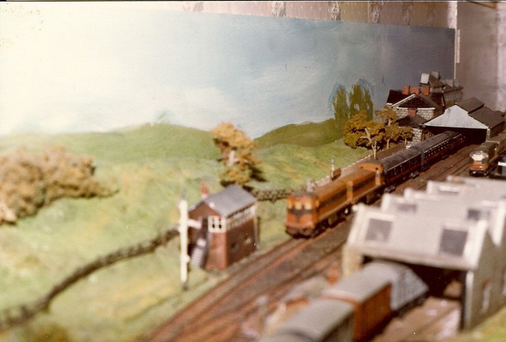

General view Duncormick.  Early 70s era 4 coach Black & Tan passenger set at platform. Wagons positioned for loading/unloading in yard. Controller is a H&M "Executive" unit powered by the 15V a/c output of a Safety Minor at the next station.
Remarkable resemblance in the positioning of buildings to my 4mm Keadue narrow gauge layout built over 30 years later!
 Late 70s era. Pair of 121s on Dublin Passenger, B141 on a Liner. Redundant wagons stored out of use in loco yard. Camera was a Kodak Instamatic

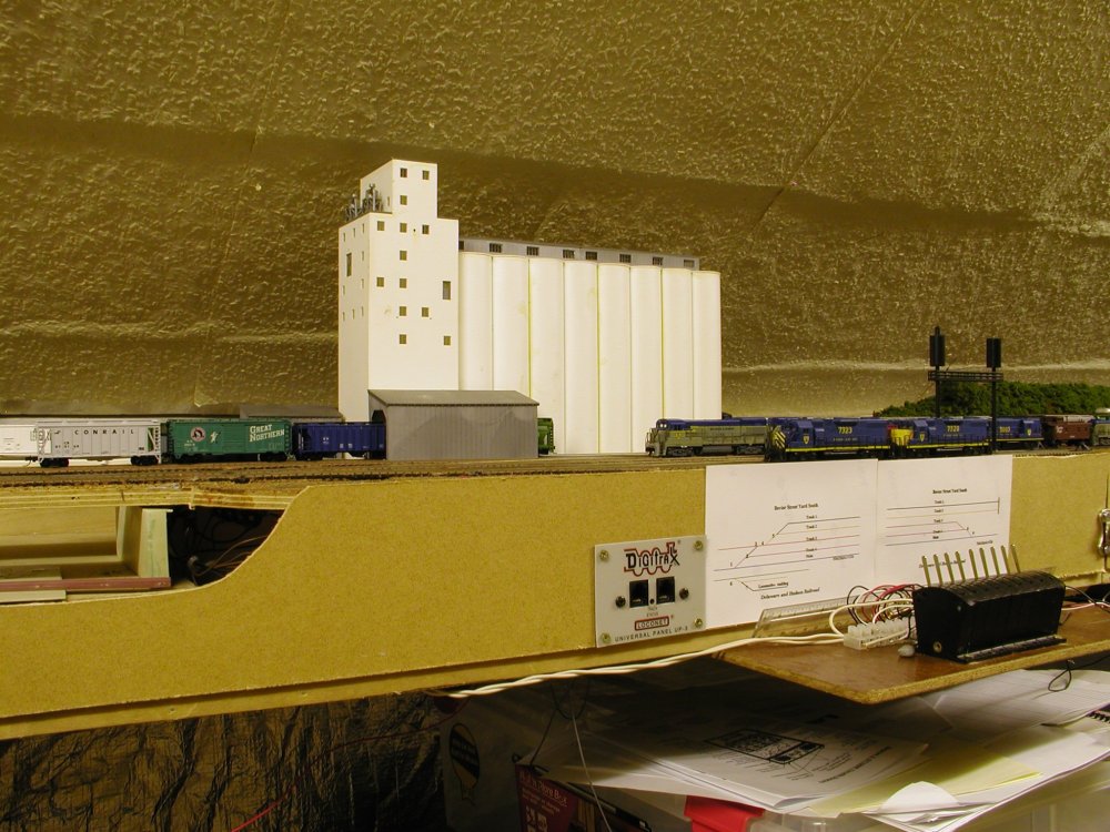

Control was DCC using a Digitrax Empire Builder (2000) with "walk around" wireless control using infrared capable throttles and receivers, an additional Empire was added, used as a booster, the railroad divided into 'Blocks' protected by digital circuit breakers to prevent a short shutting down the entire system.
Switches/Points in the Binghampton Downtown/Loco Yard area controlled by a bank of Triang Black (passing contact) Levers to represent an area controlled by a Mechanical Interlocking/Cabin, Switches at the 'North End" of Binghampton Yard, the Passing Track and Staging were operated by Lenz Stationary decoders controlled by the Throttle to represent CTC or hand operated switches. I used Seep Point Motors to power the switches in the downtown/loco yard area, Peco Point Motors on the remainder of the layout.

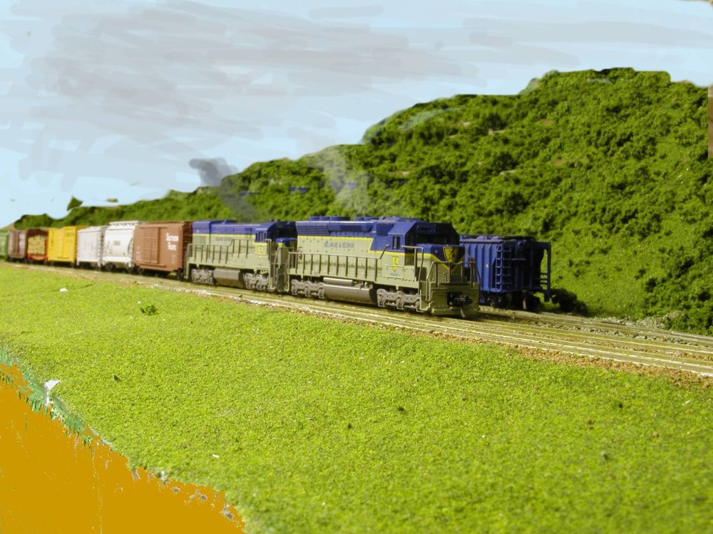

North bound freight departing yard.

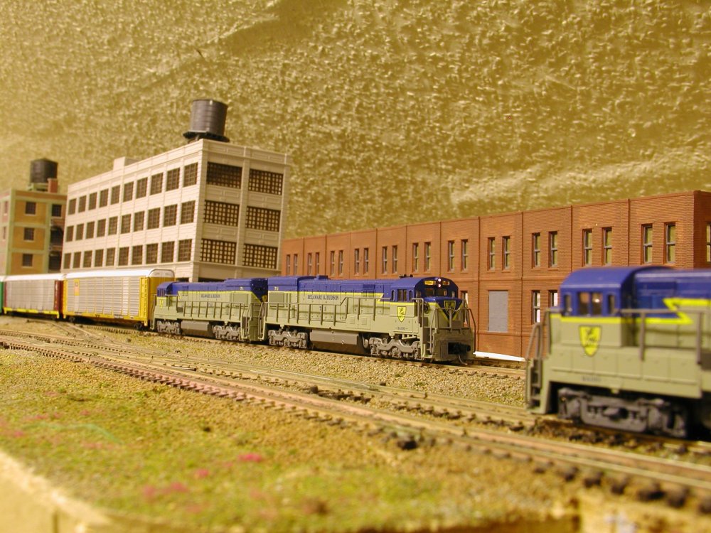

Trains arriving and departing the Downtown area.
Elevator and loco staging area

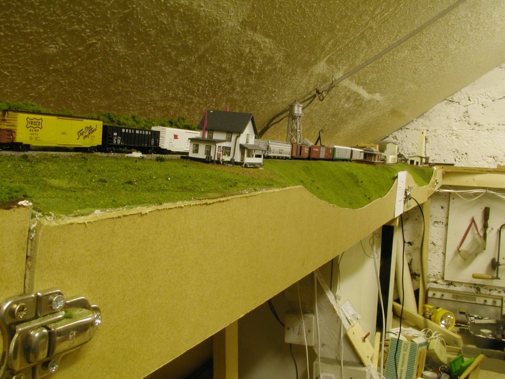

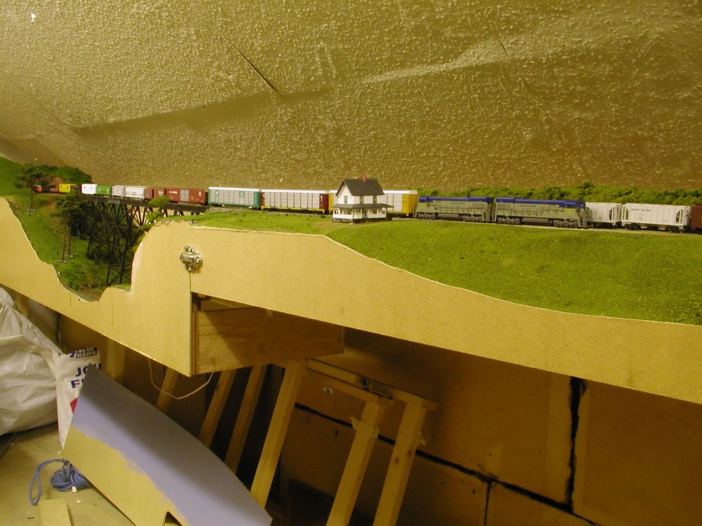

Freight passing "Dorothys House" on advantage of American N is the availability of a good selection of kit and 'made up" typical buildings in this case a typical early 1900s farm or suburban house.

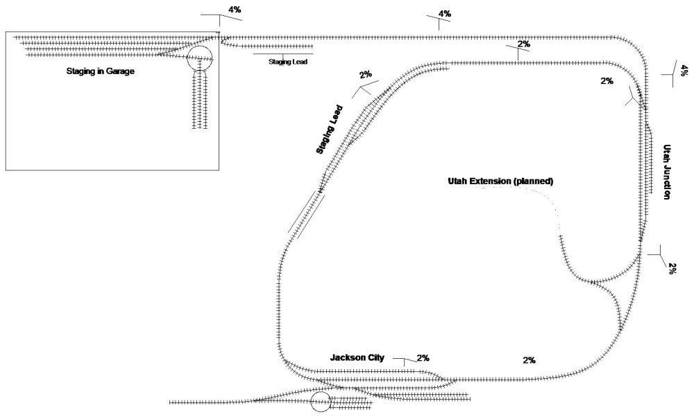

The railway is basically a large oval with three towns or yards on the outdoor section and a branch to storage tracks in the garage/workshop. Although we carried out some miniature plantings and ballasted the track, the railway is primarily operational with few detailed buildings, structures or scenic detailing.
Originally starting out as completely freelance using American outline Bachmann and LGB locos and stock the railway is now heavily influenced by the Colorado Narrow Gauge with the original stock replaced by more accurate 1:20.3 scale models.
