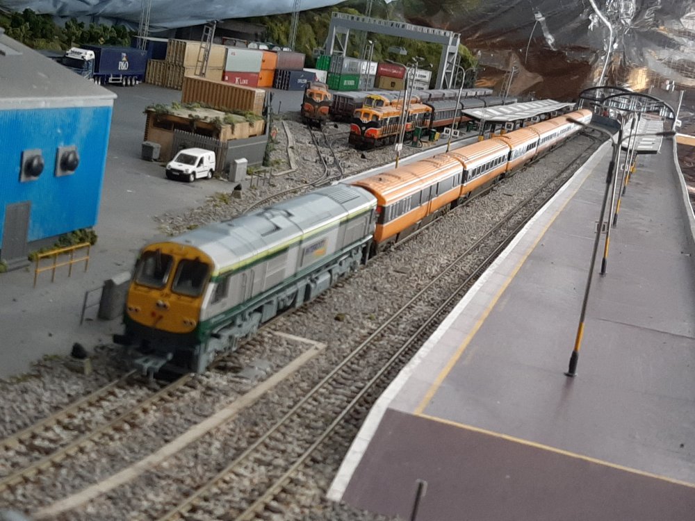

33 minutes ago, murrayec said:
I like the weathering on the second last image!
Eoin
That's the loop platform, about ten years ago now.

Avoid ballast that is quite light in colour as even though it may look like the real life version above in Ballybrophy, it can end up looking like white snow!!
I mixed some darker colours with it to temper that 'snow' effect in Heuston North if that helps.
