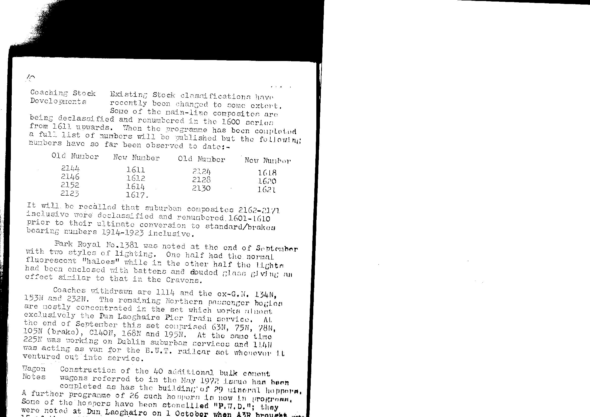

Irish Railfans News Vol 18, Issue 4 November 1972 page 10 has a report under "Coaching Stock Developments"
Brilliant, thanks. That solves many of the mysteries. I think there were a few more, I’ll check when I get home.

9 minutes ago, seagoebox said:
IRN V19 no 1, page 14 continues the story...Feb 1973
Great, many thanks! I obviously need to study IRN.

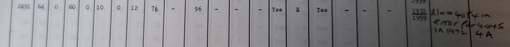

In the carriage register we have a note that 4054 was an error - it should have been 4045.

As noted above, 2491 was apparently supposed to become 4045 but numbered 4054 in error.
I have not identified 4044 in any lists, nor any higher numbers except 4045 / 4054.
